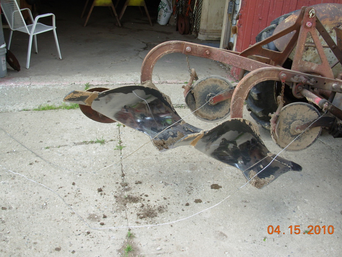

My dad run #9 wire when we plowed, but mostly I remember that it was for plowing under corn stalks not used to much in sod ground. You need to hook this on the coulters and run it 2 feet past the last plow bottom. Make them vary in length as need be. This will help pull trash through the plow bottoms and help it to not plug up. Hope this helps.

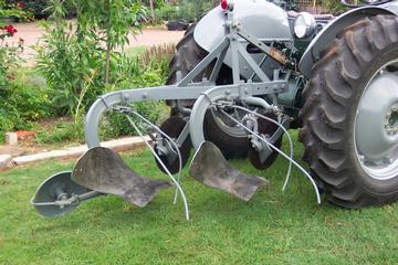

A couple of photos from the web

Post Options Post Options   Thanks (0) Thanks(0)   Quote Tbone95 Quote  Post ReplyReply Direct Link To This Post Posted: 07 Nov 2016 at 6:46am
Huh! Amazingly simple....hard to believe that accomplishes anything, but I trust you guys that it does. Neat.

Back when a neatly plowed field were admired and thing of pride dad would run wires when we were plowing under rye and sometimes corn stalks. The end of the wire drags under the furrow and holds the wire tight and anything sticking up is pulled under the wire and plowed under. It works really well with only minor short comings.

No, they pretty much take care of themselves and  go where they are supposed to as long as they are on the right side of the bottoms. Occasionally on the snap coupler plows the front one will try to wrap the tractor tire. You do have to be a bit careful how you turn but they are not a problem child, they just do their jobs without much fuss.

No you don't have to do anything, as stated before, the dirt turning over pulls and holds the wires down therefore pulling the top of the grass down. Also, after running the wires for a while be careful as the ends will have a sharp point on them.
