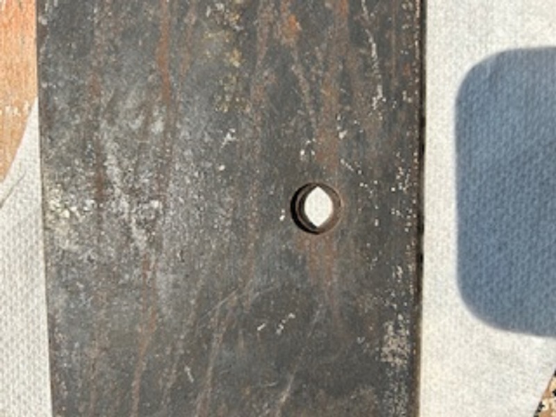

I’m trying to post a picture but the file size is too big. The head of the bolt is slightly bigger than a 1/2”. The shoulder that the bolt rest in is to keep it from turning is oblong. Not sure how else to describe it?

Most of the later ones were a cat eye shape. HTH Tracy

Tracy, that’s a good description.

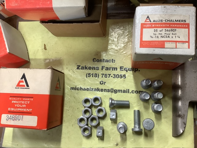

The 346907. And sorry these are not for sale

Post Options Post Options   Thanks (0) Thanks(0)   Quote Kenny L. Quote  Post ReplyReply Direct Link To This Post Posted: 31 Jul 2024 at 7:19pm

341396 share fits 375 bottom and is 16” economy

Thanks for the picture Mike, ugh not for sale....do you know where I can get some?

Thanks Kenny posting my picture for me.

I looked on AFT's website and I'm not seeing a bolt like I need. Will call them tomorrow. Now that I have a AC part number and a picture that is a huge help.
Thanks Mike

Many of the NOS "Bullet-Blade" plow shares I've had had a bolt hole the had a flat relief and a diamond shaped hole under that. Basically a 2 point bolt. I don't think I have any left and they may be hard to find as nothing in generic hardware would use that special bolt.
  From what I can get looking at the parts book, I think you want to find  341900 which is superseded by 346907, these would be 3/8" bolts. This may or may not be the bolt you're looking for.  If you need 7/16" bolts for "stoney" shares that number should be, 348293.
 I guess it wasn't official when I responded with the correct part number.

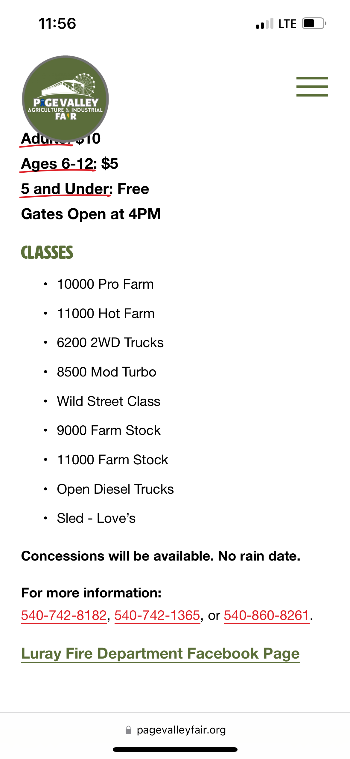

Rob, the pull info you show was for the Luray Fire Dept pull on May 20th.
This is the Page Fair pull info:
https://www.pagevalleyfair.org/2024-fair/grandstand-entertainment#grand23
7000 Farm Tractors – N
9000 Farm Tractors – N
6200 Street 4x4 (County Only) – N
13500 Farm Tractor – N
6400 Pro Street 4x4 Trucks – N
8500 Wild Street Diesel – Y
Sled – Decision Maker
N: Non-Points Class
Y: Points Class for Interstate
