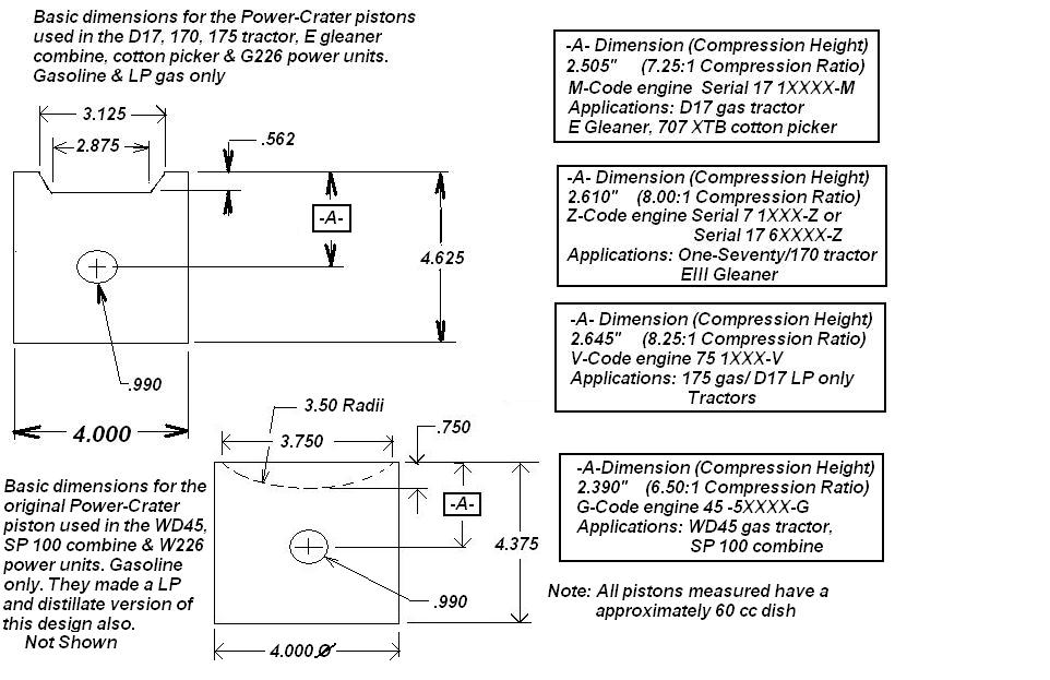

a while back there was a dimensional diagram of the dimensions of the three choices of pistons for these motors.i can't locate it and would appreciate if someone would post them again.   thanks

you're in luck...
don't remember who these came from, but I can't take credit

Bill--thanks so much for the reply--its exactly what i was looking for--forum members are a great source of assistance
