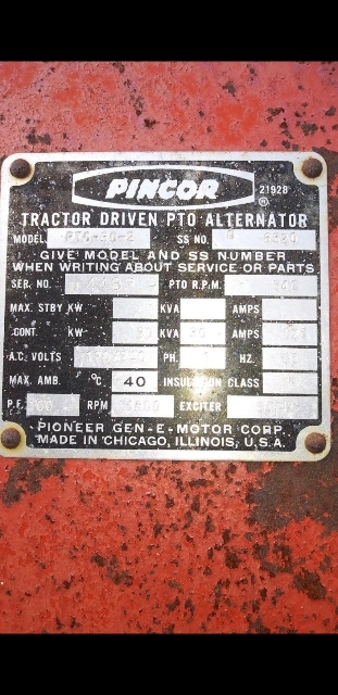

Anyone know much about these pto driven generator from pinCor? I'm hoping to run off my ac,ca or d-17(540 pto)it's a 30kw that I need to run 5 freezers full of beef,220v well pump( I mostly need to make sure it supplies clean enough power so I don't have issues with generator ruining our freezers fridge...
I also would need to know could I run the CA at 3/4 throttle and still get 540 PTO speed?

A ca will be a little light!  My reasonable condition wd will run a 12kw at full load at rated speed but 15 was too much.

Ok, I haven't bought it yet.
Also have a d17 I could use to run this pinCor...
I'm torn between a 10KW standalone 20 horsepower generator and taking a gamble on an older one like this pincor unit...
I only am comparing those two because they're about the same cost as of now.
I know they're too completely different ability generators but the standalone unit would be a welder also...
This pincor unit does not have hertz meter just voltage.

It would be nice to have extra amperage output because we raise our own beef and I currently have five freezers full of beef and I hate the idea of not having a way to protect my investment
Points: 90793
Post Options Post Options   Thanks (0) Thanks(0)   Quote steve(ill) Quote  Post ReplyReply Direct Link To This Post Posted: 26 Nov 2021 at 6:33pm
there are about 750 watts per HP............. 30,000 / 750 = 40 HP.
Thats if you want FULL 30 KW of power..  I cant see the name plate, but that is well over 100 amps output at 240 v....... I would think each freezer might be 10 amps... so 50 amps total... and another 15 amps for the well............ so 65 amps total.
240v x 65 amps  = 16 KW   ............ you should be OK... You wont be at full output load... But you do need to be at 540 pto rpm to keep the FREQUENCY above 60 hz.

Okay so most likely I'm looking at only being able to run it with the D17 reliably, but possibly with the CA if I selectively turn things on and off if I had to...
