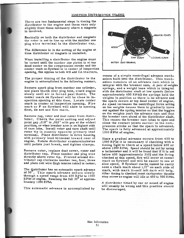

Since Charlie's course of action has been determined, I will attach for general interest the following AC Service Bulletin on distributors from the WD45 and CA period.  Later distributor applications specified an advance of 25* BTDC, rather than the 30* in the bulletin, and said that this could applied backwards, as well.

Yah, my D17 manual states 25
