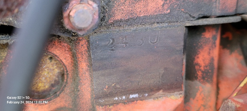

I need one for an Allis Chalmers 175 tractor.
Is there a designation on the block.
Here is ID on mine.

What WF is referring to is a "Stress Block", and conventional block engines. They are not interchangeable at all. The "Stress Block" does not have a bolt on rear flywheel housing and the these are used a lot where the tractor engine is part of the structure of the tractor meaning no frame rails.
On the left side of the engine there should be an aluminum tag riveted to the block. Many 4.248 engines were stamped "LG" build. If the tag is missing, there should be stampings into the block above the injection pump just below the cylinder head deck, or same place at the rear.
There is also a different crankshaft layout. One has a single large bolt, the other a three bolt affair retaining the front pulley(s). There are also differences internally but need to know what you have before going much further.
A 4.236 will be a slip fit also if the same basic block.

Post Options Post Options   Thanks (0) Thanks(0)   Quote Macon Rounds Quote  Post ReplyReply Direct Link To This Post Posted: 29 Feb 2024 at 9:16am
Thanks for the info.
I'll be checking for those specific details.
