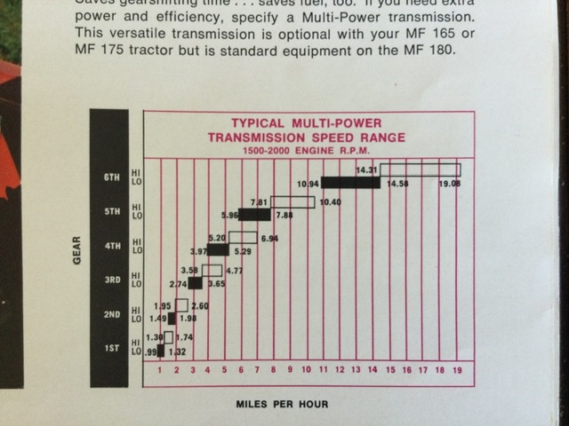

Freedguy. The MF multi power shifted with switch on dash.Just move switch up or down. Of course you can shift lever if you want but the whole point of it was to avoid that. So on the 165, 175, 180 you had 4 speed trans and hi low range for 8 speeds.  Multi power trans was a 3 speed trans so with the switch was 12 ahead and 4 reverse. Had to check on that. The older 35's and 65's had only 3 speed trans.

When I was a kid we had a MF 180 with multi-power. Used it often and it was trouble free, never put a dime into it.  All of the AC's we had, we had good luck with the PD with the exception of the popping back into N. Usually an adjustment fixed that.
