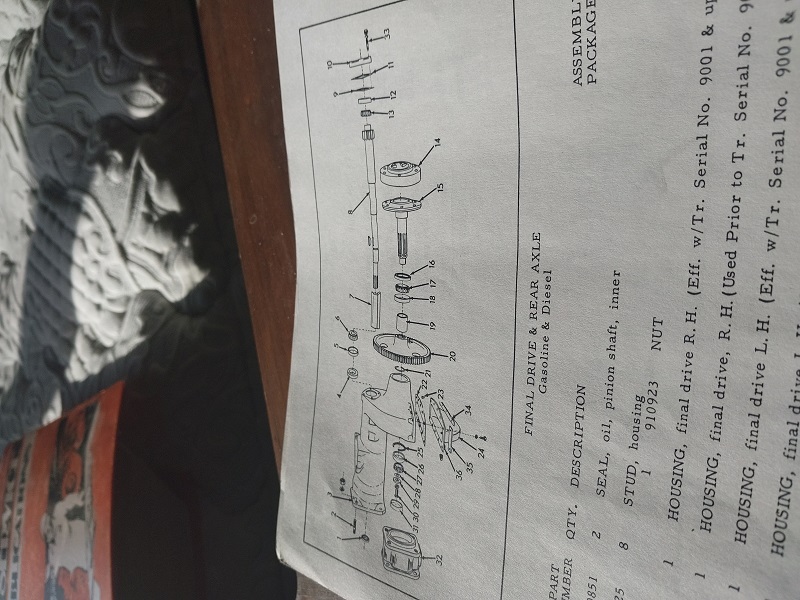

I am looking for part numbers for d14 rear axle seals and possible bearings as well.

#1 70232186 SEAL PINION SHAFT INNER, #4 70206786 PINION SHAFT INNER, # 5  70209890 CUP PINION SHAFT INNER, #6 70227520 CONE BEARING INNER, #12 70230068 CUP PINION SHAFT OUTER, #13 70228509 CONE BEARING PINION SHAFT OUTER, #16 70218284 SEAL REAR AXLE, #17 70218285 CONE BEARING OUTSIDE REAR AXLE OUTSIDE, #18 70210241 CUP OUTSIDE REAR AXLE, #26 70209890 CUP INNER REAR AXLE, #27 70209889 CONE BEARING INNER REAR AXLE. NUMBERS 1&2 ARE SUPERSEDE.
