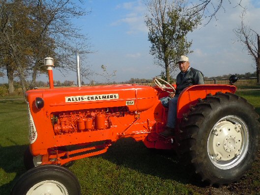

I used the masking and xacto knife, paint the black then tape and cut out the letters then paint creme
Your D17 looks great! Reminds me of ours when we were kids (1970-1975). My brother & I planted lots of winter wheat with one like it. Dad's D17(series 2 I think?) pulled a 10' AC disk & JD 12' grain drill. We planted fields in a continuous inward (square circle?) pattern.
