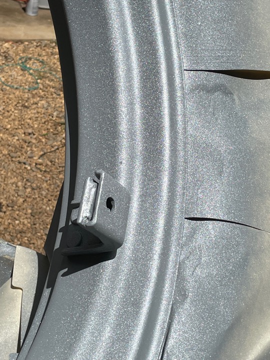

I like the Rust-oleum spray, coats nice and even

Joe, is that the Rustoleum galvanized? I used that on my 7040 rims.

Post Options Post Options   Thanks (0) Thanks(0)   Quote JoeM(GA) Quote  Post ReplyReply Direct Link To This Post Posted: 06 Apr 2024 at 6:56pm
yes it is

Hey Joe!  That looks like a G rim......!   LOL!   I use Dupli-color's textured Silver. Looks a lot like Joe's wheel when dry. Also fills in some of those pesky rust pockets in the rim and makes the wheel look smoother. In NJ, the rust worm can get pretty harsh sometimes...
Steve@B&B
Steve, you know it's a G rim at my house!
I have a stack of old file folders cut to the rim radius, just let the air out, pull the bead down a bit and slide them in, that galvanized spray even self heals if I scratch or bump one. Even if you touch them up, in about a month, you can't tell where it was
