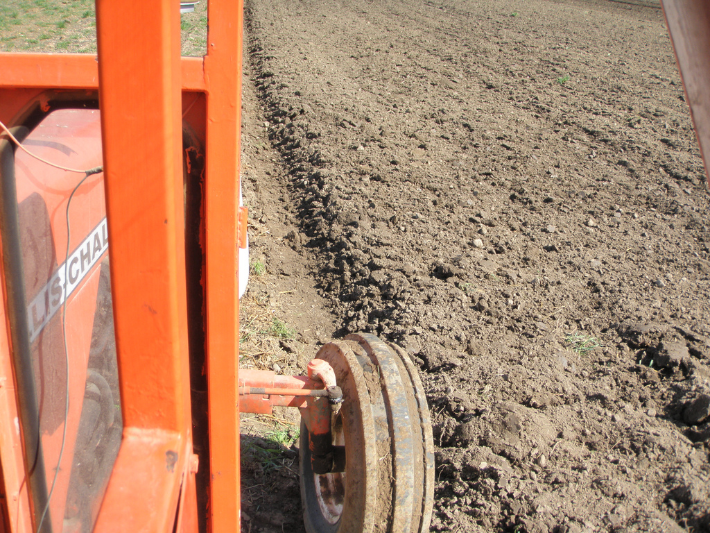

I'm pretty certain the tires on my 190XT are oversized. They're big and bulgy, it make it not follow the furrow well. You can see how the tire dwarfs the furrow.
Here's a video of it. It won't stay in long like the 185 where you don't have to steer the entire pass.
[TUBE]S9BOJoLN1fg[/TUBE]

Wish my soil plowed up like that. Heavy Kentucky clay -- it's always either too wet or too dry, but we make do - LOL

Nice looking 190XT you have there! I know how hard it is to take pics and drive the tractor, But looks like you have that under control. lol
I don't think it's the front tires, Looks like you might need to adj your plow, try winging it over a little or look for worn land sides.

nothing to worry about there, that tractor can plow all by itself

I have plowed alot of  acres with XT's  with 11LX16 Impulment tires, our Iowa gumbo leaves a straighter furrow wall.  It allso makes big slabs.  We used a plane straight rolling cutter, the wavy self shapening ones won't scour in our ground. Don
