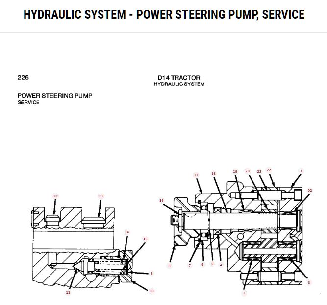

   Well, had another close call with my D14 PS and its time to fix it before that sob breaks my arm,,,,,I had posted a couple of years ago and Dr Allis mentioned the seal in the pump had failed and was allowing the PS fluid to migrate into the engine crank case. I've had to drain all the PS fluid out of oil pan several times and ain;t doint that chit no more,,,!!
 Does anyone have any dwgs of the parts and pieces to the PS,,?
  Also,  who to buy the parts from??

Post Options Post Options   Thanks (0) Thanks(0)   Quote steve(ill) Quote  Post ReplyReply Direct Link To This Post Posted: 10 Jan 2023 at 8:56am
https://parts.agcocorp.com/en_US/apbsearch?q=agcoallis/79001548/l&name=D14+TRACTOR%3B+AUXILIARY+MOTOR+-+D14
it is listed in the ONLINE AGCO parts book. ............. if its the pump you have ?
 Hey Thanks Steve,, I'm pulling that up as we speak,,,  I'd like to gather up all the parts and pieces before I break it down as it gonna be a HUGE  and BFJ,,,!!Wink

https://www.robertstractor.com/Allis-Chalmers-Power-Steering-Pump_p_8063.html
Edited by Gary - 11 Jan 2023 at 7:51pm
