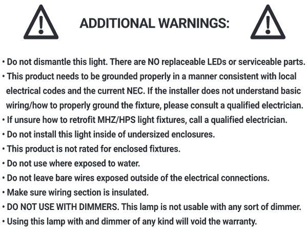

I've got one of those giant-ass LED cob bulbs in the shed. 10,000 lumens, works a treat.
I was thinking I've got a couple of outdoor fixtures I'd love to put something this bright in, for when I really need to see something in the yard, but I don't believe these are rated for outdoor use. Anyone point me at some outdoor type LED bulbs of similar size?

Your link says it's good for yards, so I'm thinking it's an indoor/outdoor light.

Huh, the things unenclosed I'd be nervous even touching it live, guess I need to give it a second look. Thanks guys.

Exposed to water? Kinda suggests it is an indoor thing, and would need an enclosed fixture as a yard light, but then it says ut's also no rated for enclosed fixtures.
So it's a yard light, provided you don't have a wet yard and provided you don't try and put it in a fixture?

I think they are more for a big shed / barn / warehouse.... If you mount OUTSIDE, it should be under a half moon cover that is open on the bottom.  COB type lights with the LEDs exposed would not be the best for outside use.  You can buy LEDS that look like incandescent bulbs ( glass or plastic ball) that would be better for outside use.

Yeah, that's kind of why I was asking for recommendations. I originally picked these up at Rural King, and I'm looking at Menards as well, and there's a huge price difference between these and 'outdoor' LED lights. And these suckers are bright.

"outdoor" are going to come with their own SEALED CASE to keep out water and bugs.. That cost $$.... You could use just an LED BULB, but need to have a LARGE hemispherical cover over it.

 Of the LED Corn bulb one type I put up is spiral tube with the LED chips within 250 Watt equivalent - indoor or outdoor , the 300 Watt also the LED chips are protected so can be used outside but YES the base needs some protection from direct contact with water - so a reflector or diverter to keep moisture out of the driver end by screw base might be needed .
 The heat produced now on LED is way less that what is put out by incandescent lamp of similar wattage rating - and now many LED bulbs are also rated for dimmer use . Any place you has CLF curly bulbs is a great place for a LED replacement at about 1/4 of the watt draw and less heat output of the base unit that controls it .
