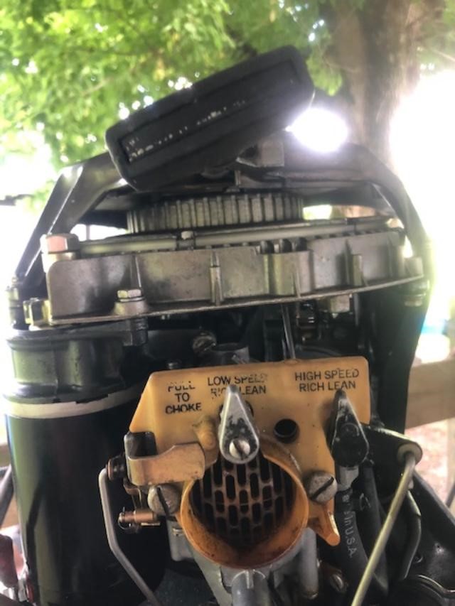

I have an old Johnson 33hp. It's been a reliable motor over the years. It got were it wouldn't idle, hard to start, choke and die. I rebuilt the carburetor and it seemed to solve those issues, but it didn't seem to open up quiet as much as before ( less RPMs ). I've had it on the water four times this year and each time it gets worst. Now at full throttle it runs half speed or less, and not much power. I used to pull the kids on an inner tube with this little motor. I can't understand why it won't rev up to full RPM. The adjustment knobs don't seem to do anything when you turn them. Could the fuel pump be going bad? Any thoughts appreciated.

 Hey Ranse,,I'm thinking the point gap should be closer to bout .016-.020.,,,or the thickness of a piece of book matches,,,,,Clap

Hey Ranse, doesn’t that 33 have an adjustable high speed needle in the bowl of the carb? If so open it up a bit while under full load.

johnkc, Yes as you can see the card has a high and low speed adjustment knobs. I tried adjusting the high speed at fast idle, but not under load. It didn't seem to effect the motor one way or another. As for the float position, I didn't tamper with it. To be honest, I wouldn't even know what the correct position would be. I figured if it worked for over 50 years were it is, it should still work. To adjust the carb under a load, I will have to rig me up a tank. I'm not sure about removing the rope starter to get to the points. Is there going to be a spring unwind when it pops off? Thanks for your help.
