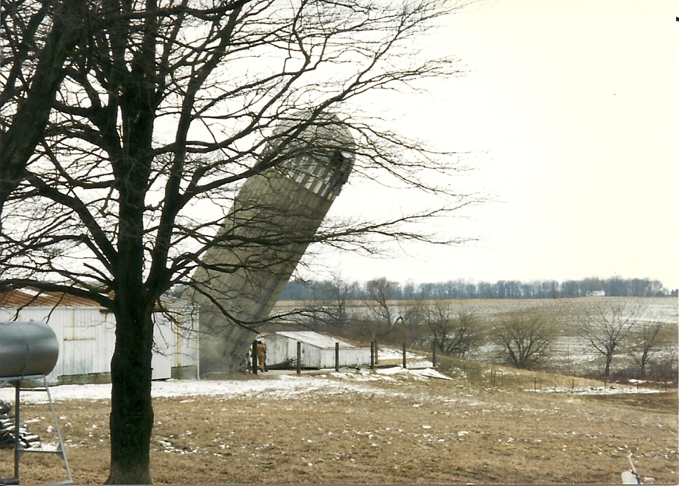

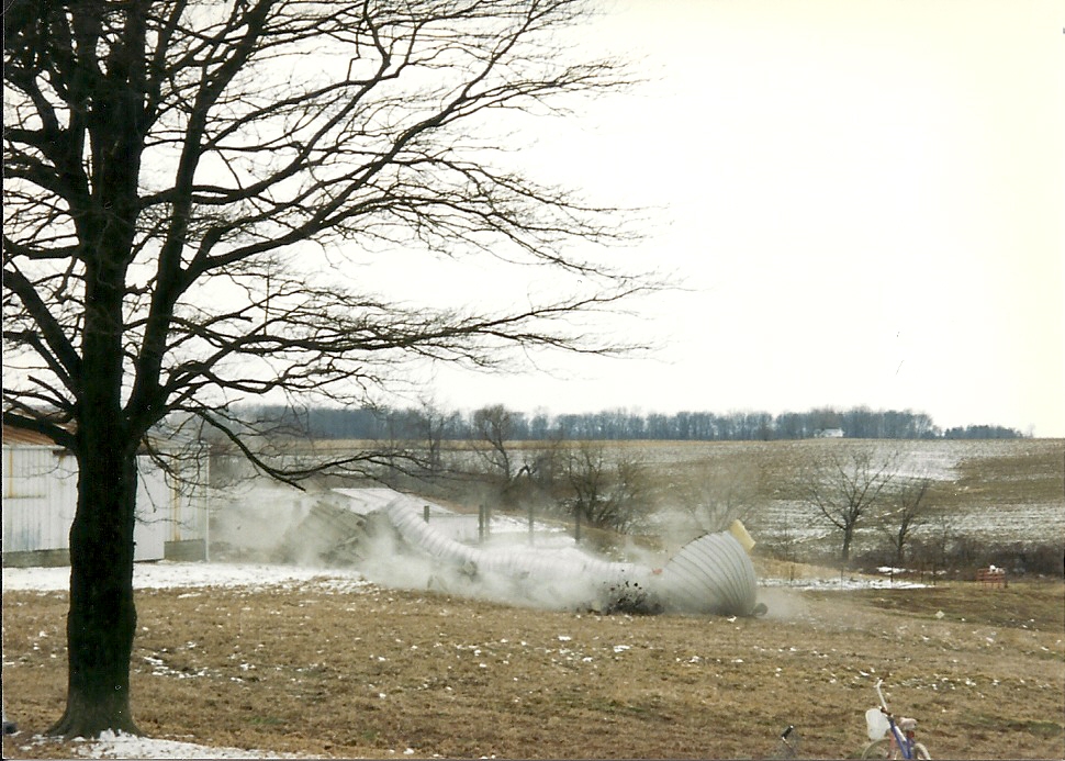

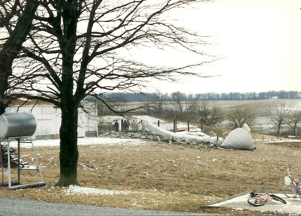

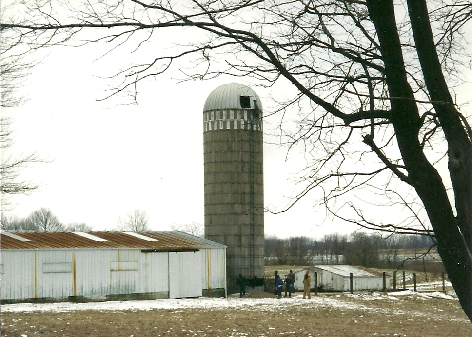

We had two when we bought our farm. Gave them to a pair of local farmers (brothers). One was good enough to put back up. It was taken down with the scaffold inside / sand outside method mentioned. Pics are of the other. It was about two feet from the building. The crew was amish and they seemed totally confident about the direction of fall. Sledgehammer method to bring her down. This was as fast as the camera would take pics.
