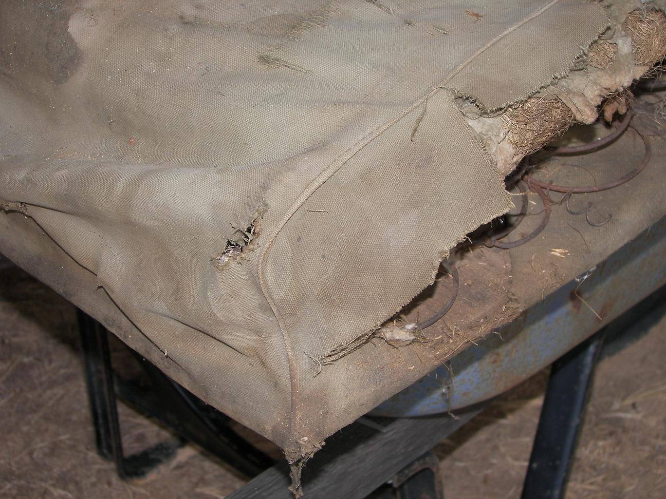

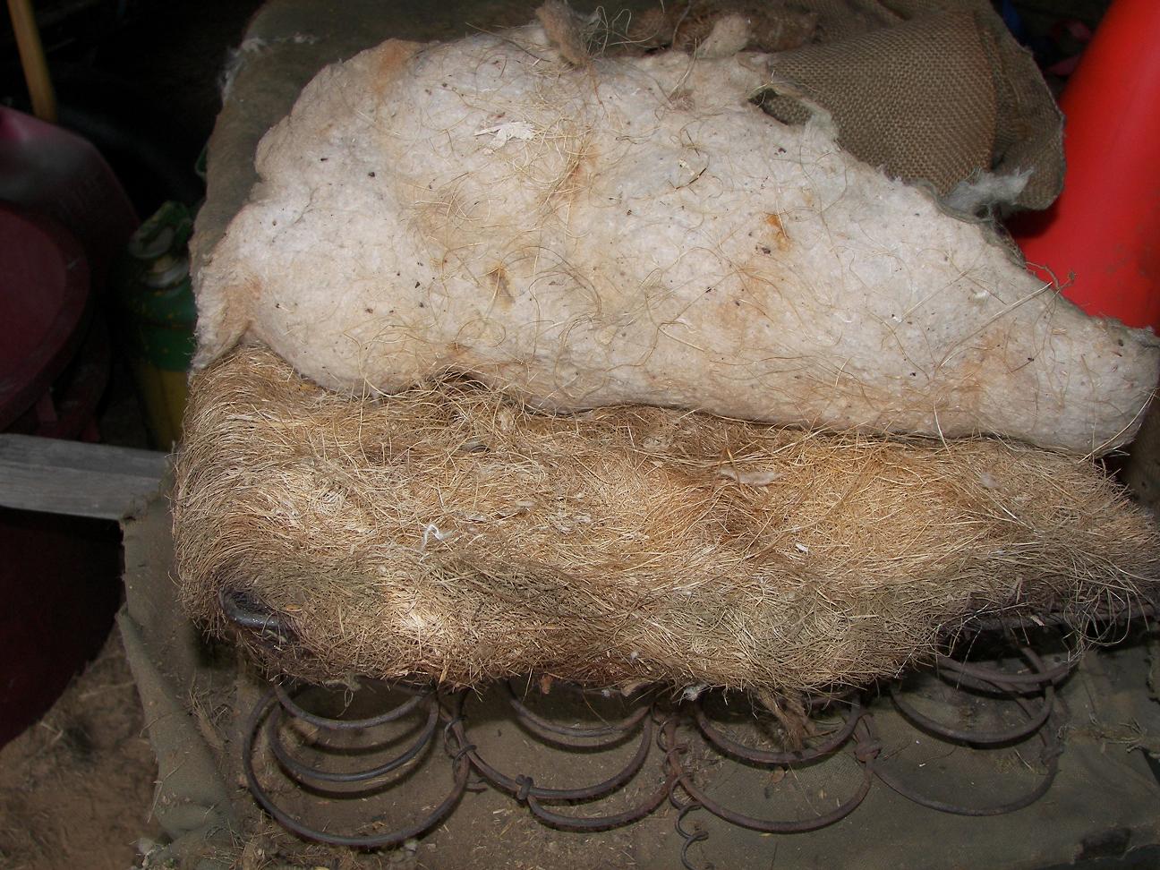

Post Options Post Options   Thanks (0) Thanks(0)   Quote mdtractormechanic Quote  Post ReplyReply Direct Link To This Post Posted: 07 Sep 2011 at 4:58pm
Here is a look at the seams on what is left of the covering from my 1950 C. The metal cleat was missing on this corner.
The padding has two layers. The bottom layer is tow, the fiber of the Flax plant (not horse hair) and the top is a cotton felt pad.o

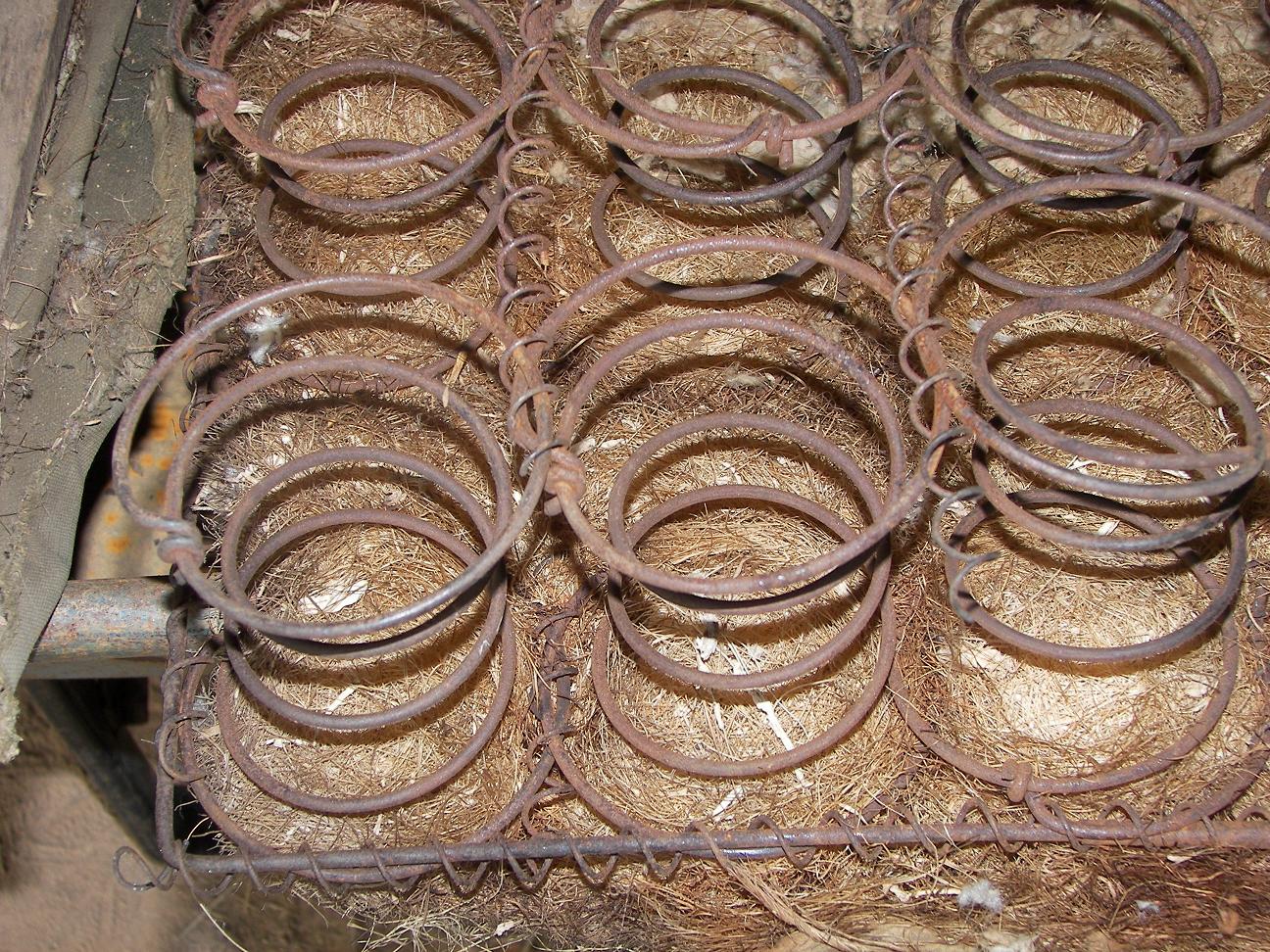

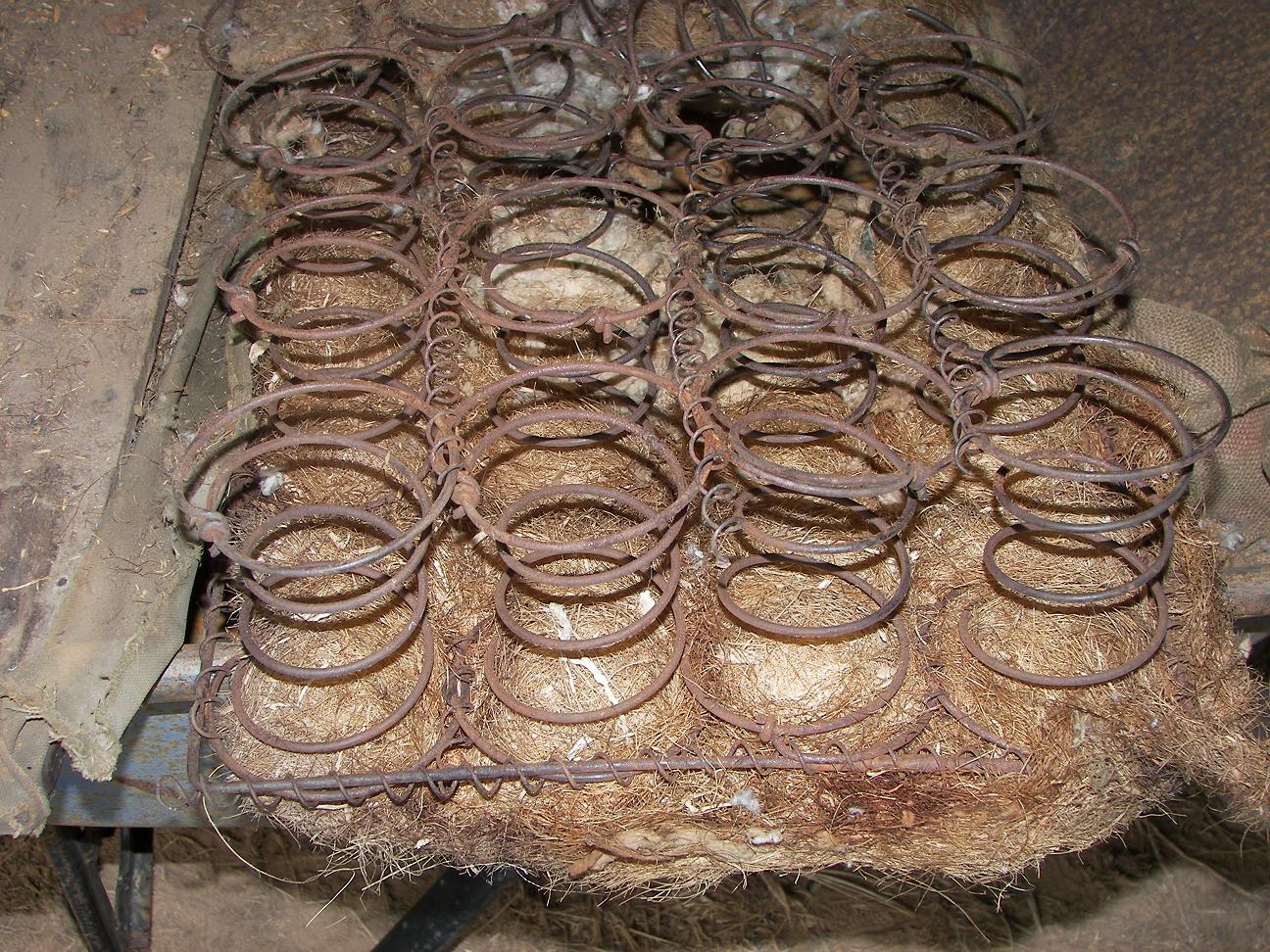

The two pics below show how the springs were connected to eachother. A spiral wire instead of cord. One staple fastens one spring to the bottom to keep them all aligned for covering.
