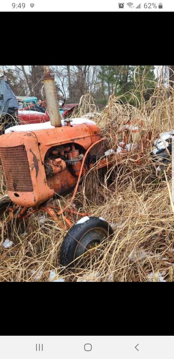

I regularly see the front half of a Model B added to a Model CA rear to get a wfe on the CA or swap a CA rear to a B to get better gearing and a road gear. The result ends up with the front and rear wheels not tracking in the same ruts and frequent jury rigged steering linkage.
The B steering box is rarely swapped at the same time to improve steering geometry, as many of these hybrids use cobbled drag links off the CA pitman arm (points up). Are these tractors abominations or more interesting to a collector? Here is a better example of a custom drag link off the CA pitman arm: ![]() Edited by KMAG - 16 Feb 2021 at 9:14am |

looks like the one in the picture , it dosnt steer backwards . the ball and socket end on the axle is all tie wired on and needs to be fixed before it leaves our shop here because the engine stuck over the winter
