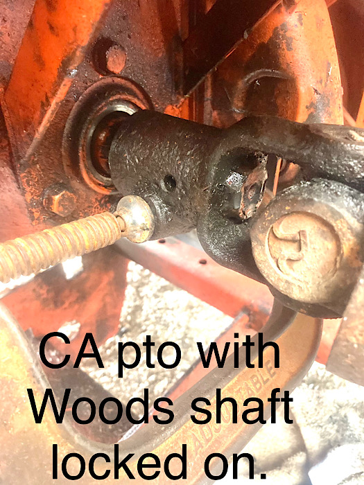

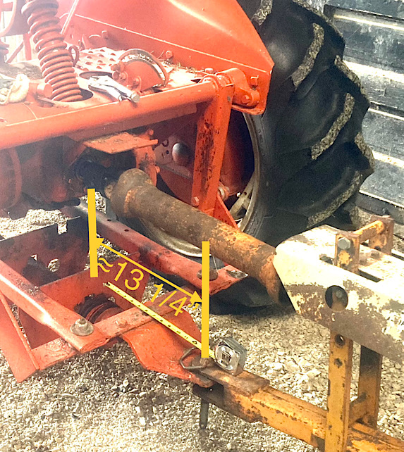

While using my CA and Woods brush hog, I turned as sharp as I desired. Initially I didn’t pay attention to the drive line chatter and vibration that occurred during the sharp turns. But the damage was already done. The binding of the Woods drive shaft forced the yoke forward of the tractor’s pto shaft detent. Now I can’t remove the Wood’s shaft. The Woods shaft can slide forward until it contacts the tractor and can be pulled rearward to what I believe is almost the intended operating position.
What is the best approach to removing the mower’s shaft from the tractor?

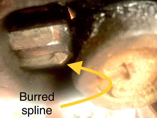

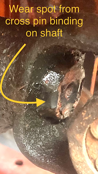

You might have raised a bit of a burr or distortion where it was striking the end of the shaft, I think I’d start by dressing that on both sides with a file or small grinder and then see if shaft will slide off.
Allis Express North Georgia
41 WC,48 UC Cane,7-G's,
Ford 345C TLB
Points: 24399
Post Options Post Options   Thanks (0) Thanks(0)   Quote jaybmiller Quote  Post ReplyReply Direct Link To This Post Posted: 15 Dec 2022 at 11:43am
Maybe remove the 'cross' of that Ujoint first, so you get GOOD access to the end of the PTO shaft, then deburr and see if the yoke  moves. You may be able to put a 'gear puller' on the stuck yoke and pull it off.
If possible PUSH the yoke closer to the tractor to expose more of the PTO shaft for deburring operations.

Neighbor did pretty much same thing, we dropped the bush hog and pulled the driveshaft apart,we pulled the plastic guard off the half still on the tractor, then we put a breaker bar on the back of the pto shaft,and lifted up on the drive shaft, pulled it right off there.

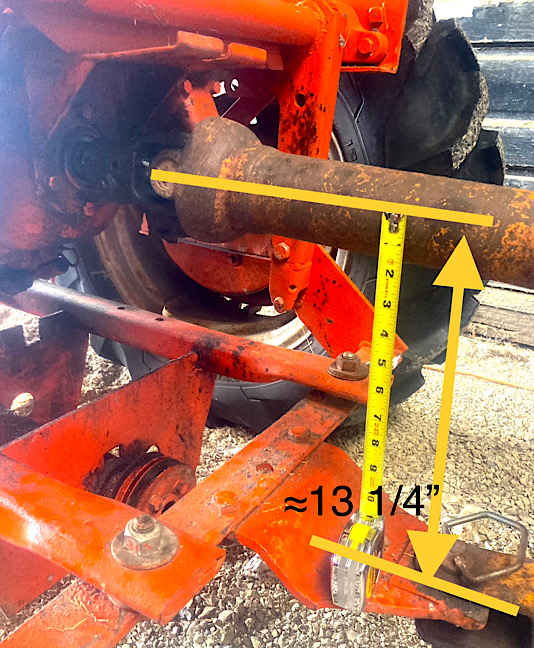

Im working on a 15 ft Batwing right now... Correct me if i am wrong, but there is a TOWER on the  mower hitch at the BACK END of the drive shaft... There is a support bearing that hangs inside that tower... The "front pto shaft) is maybe 24 inches long and SOLID.. it does not slide and change length... BEHIND the tower there is a 5 ft long drive shaft with a square drive inside a tube... that is what  gives you the LENGTH NEEDED.. When you turn a corner, the TOWER is suppose to PIVOT forward or back a couple inches and make sure what happened, does not happen..
I dont think you shaft is TOO LONG... I think you turned TOO TIGHT for this design of pto shaft / hitch ...
You need to take a small air or electric die grinder and reach in and  grind off the burrs or any high spots on the end of the shaft... Go slow and take off plenty.. A little undersize at the edge will not hurt... Eventually the shaft will then slide off.

Ah yes, the price of ignorance is the cost of education....  As others have said dremel tool and stone to remove the burr and it should slide off.  If you have a flex shaft dremel or similar, they have a smaller body that won't get in the way, as much...Wink

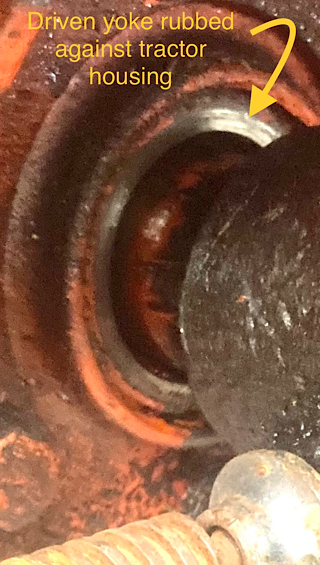

It sure looks to me like the wear part in your picture actually made a burr that is keeping the yoke from sliding off the splines.  Like suggested, you may need too get a small die grinder and grind the splines back to the correct profile. Also, that C-clamp may be holding the release button in too far and actually re-locking the pin.  Sometimes it's gotta be left "out" an 1/8-1/4".

To get it loose, a dremel and about four very-full cups of patience.  The bit I would choose is the coarse cylindrical type used for sharpening chainsaws- it'll have the reach, the right grit, and they're wonderfully inexpensive in bag-of-ten quantities.  Last time I had a PTO shaft extraction, the poor feller had 'balled up' the tube, so I knocked apart the yoke, then used a hook attached to my slide-hammer to rap it out.  If you do same, be gentle and patient, as the cast iron backends usually aren't really thick, as they don't generally take any load that way... a harsh beating there can break castings if you're not careful.  Rap a few times, then knock it back, and look for wear-signs, they'll tell you where to touch it up.

Originally, my thinking was that the problem was the push button, lock-in-place pin. But I expect that the burrs are the issue.
AaronSEIA - I think you are right about the C clamp. Currently, the yoke doesn’t slide to the rear far enough to make contact with the wear spot shown in my photo.

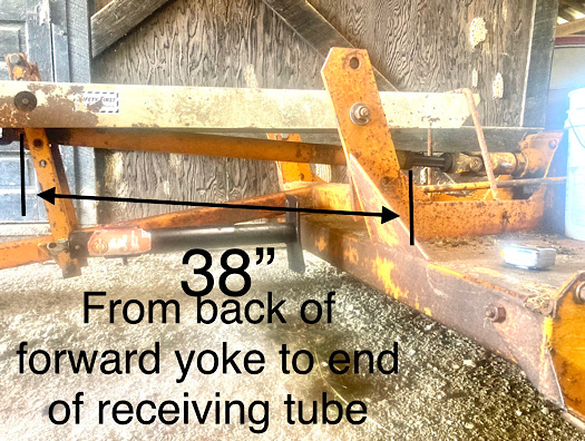

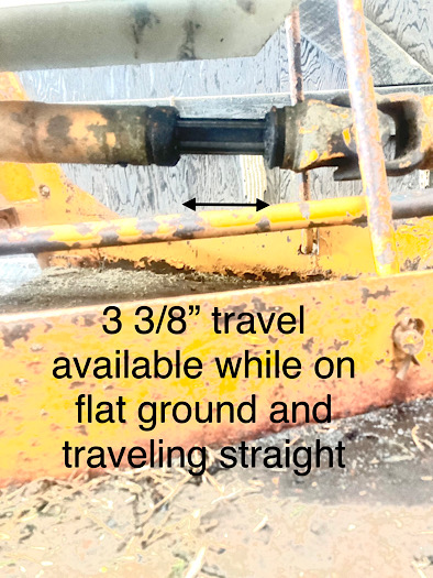

Jim... here is a photo off the internet of the  mower with the PTO shaft off of the tractor. Note that THE TOWER IS TILTED BACKWARD several inches toward the gear box.. The rear shaft that is square should SLIDE EASILY several inches backward as you take the pto shaft off the tractor....
When you connect the mower to the hitch, you should have to PULL THE PTO shaft several inches forward to connect to the tractor shaft... If you dont have enough clearance, the rear shaft is too long .... you could possibly extend the drawbar  so the PTO is further from the mower, but your 14 inch  dimension of pto to hitch is correct ..
Jim said...I disengaged the pto, turned sharp and dismounted to inspect. The forward fixed shaft was tight against the tractor and the telescoping rear shaft was bound against the mower transmission.... YEA... thats not how it was designed.. Something has changed ???
Edited by steve(ill) - 16 Dec 2022 at 9:33am

The mower is a Woods Cadet 60. The drive line is like the internet picture posted. The tower moves easily and I expect that the drive line is original.
Operator error. The small tires on the CA allow a very tight turn without contacting any of the hitch.

Frame it however you want...your coupled too short. The drive line should never be able to bottom out at maximum travel possible.
Points: 85906
Post Options Post Options   Thanks (0) Thanks(0)   Quote steve(ill) Quote  Post ReplyReply Direct Link To This Post Posted: 16 Dec 2022 at 12:46pm
Jim, i would agree you could turn a CA REAL QUICK and possibly get things in a bind...  my only concern was you said the square slip shaft BEHIND the tower might have bottomed out on the gear case.. The tower should be able to  TIP BACK several inches as shown in the above photo...... But i agree, it MIGHT be possible to turn quick and get the FRONT shaft in i bind if the PUSH on the tower is sideways and dont allow it to move BACK toward the gear box ???  BUT... you should have square shaft showing at the gear box end. ??
So, U-joint yoke bind occurs as a result of the Ujoint being asked to negotiate an angle past it's geometric clearance.  The position of the two U-joints being centered on either side of the pivot axis basically makes the total turn angle divide equally between the two... meaning, a 45 degree angle between PTO shaft and the mower's slip shaft is evenly split at 22.5 degrees per joint.  Changing this relationship makes it so that one joint will be moving a tighter angle than the other, thus, not taking full advantage of the pair.
But the one thing about Steve's note here... is the slipshaft.
IF...  IF there's a bend, kink, or otherwise obstruction in that slipshaft outer (and it happens that they get torqued and twisted on occasion), then that end of the slipshaft will no longer accept the inner, thus, it is effectively SHORTENED.
You clearly made too tight a turn for the circumstances, but I think Steve's suggestion is that it SHOULD have been able to allow more... PERHAPS that reason, is that the slipshaft go to full depth travel.
Besides being kinked/twisted/torqued, some of the OTHER things that'll prevent a slipshaft from fully collapsing... is embedded debris, or grease (fresh, but also especially saponified).
So that's a good thing to check.
Another note- you've got a C-clamp on that detent pin.  You MIGHT have it forced too FAR in, to release.  The pin is usually relieved in a radius to clear the splines through the cut, but if you push it too far, it's same as not enough.  Back the clamp off, and work the joint a bit more by hand, and feel that detent, mebbie between that and a little light dressing of the gunge-out malling, it'll come off nicely.

The problem might be the drawbar or lack of. Is the hitch that's on that CA the same length as the stock drawbar or is it shorter?

The thread has morphed into, 1) how to disconnect the mower shaft, and 2) is the drive line correct.
1) I pushed the driven yoke to the tractor and cleaned the exposed end of the tractor’s shaft. There is a burr or two to grind away.
2)The mower drive line looks “normal”, for what that is worth. With the tractor and mower on a flat floor there is 3 3/8” of available male shaft to receive the movement of the outer shaft during a tight turn. I haven’t researched correct dimensions.

Jim, i just sketched it out on graph paper.. Assume you have 14 inches from the  support bearing to the hitch pin and 14 inches from the pin to the PTO support bearing (tower) ... 28 inches total..
When you turn 45 degrees on the tractor, that 28 inches becomes 26 inches, so the PTO SHAFT moves 2 inches backward toward the gearbox.. Still clearance.
When you turn 60 degrees on the tractor, that 28 inches becomes 24.5 inches so the PTO move  3.5 inches backtoward the gearbox ..... and you will bind... anything over 60 degree turn gets REAL BAD, REAL QUICK !!
Probably OK if you limit your "TURNS" to 45 degrees...
