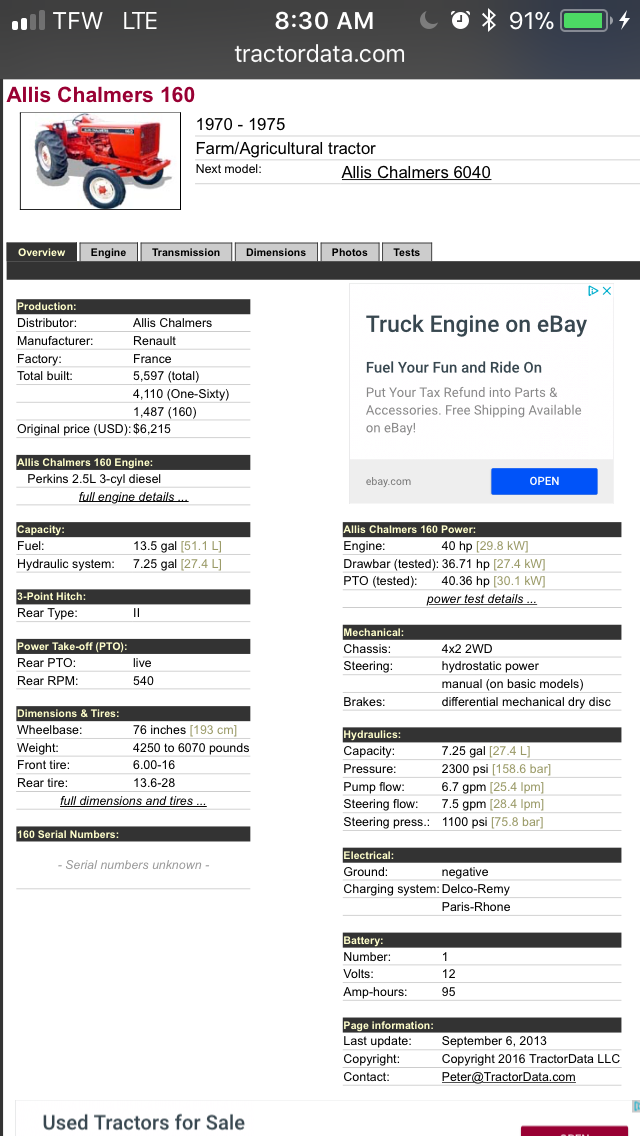

Im currently trying to get my grandfathers old one-sixty working and the hydraulics are being a pain. I’ve basically ruled out problems with everything up to the position control valve body (pickup, pump, lines) but can’t find any reliable Information for the position control valves.
All physical linkages and whatnot seem to be intact and fully operational.
If you start the machine and throttle up the hydraulics lift the rear hitch to full height and will not lower.
Does anybody have an exploded parts diagram or disassembled pictures of what is supposed to be in that valve body? .
