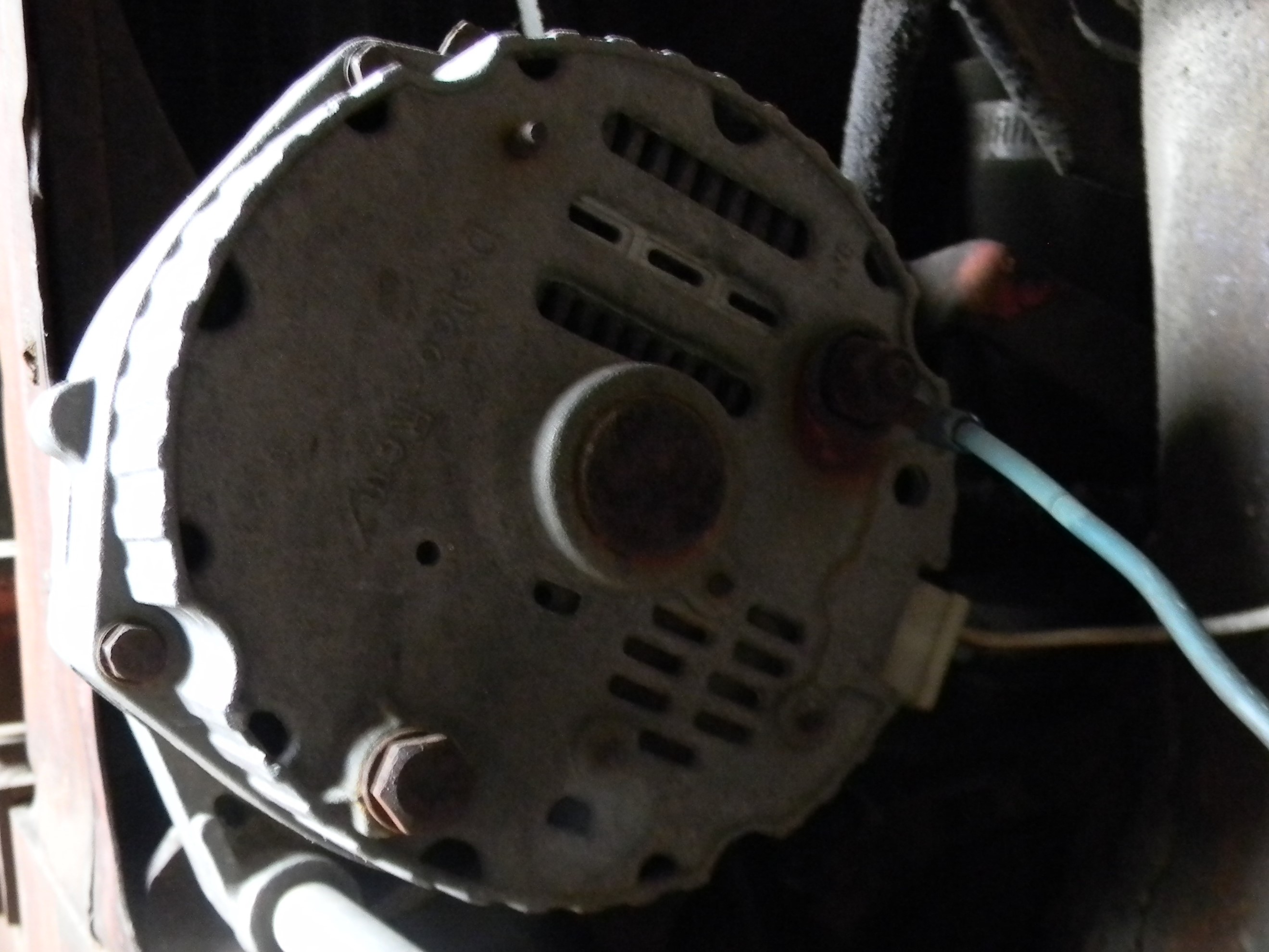

If you have the plug with the sensing wire its not a one wire alternator. its a internal regulated alternator. I built several One wire alternators for hot rods and have one on my 190. you disassemble the internal regulated alternator. Remove the regulator diode stack and replace with a one wire mod one. Put the rubber plug in the hole for the sensing connecter and reinstall it. My 190 needs to get above 1000 engine RPM to start charging. Once it starts it continues charging as slow as it will run. The modified regulator requires the RPM to start when it drops back to zero it stops energizing the alternator stopping the drain when shutoff.

I stand corrected Dakota Dave, it started out as a 1 wire but now with 2 wires and my mods there is no drain and it will start charging at a fast idle

This is what I use, the big wire is always hot and the one that plugs in is only hot when key is on
