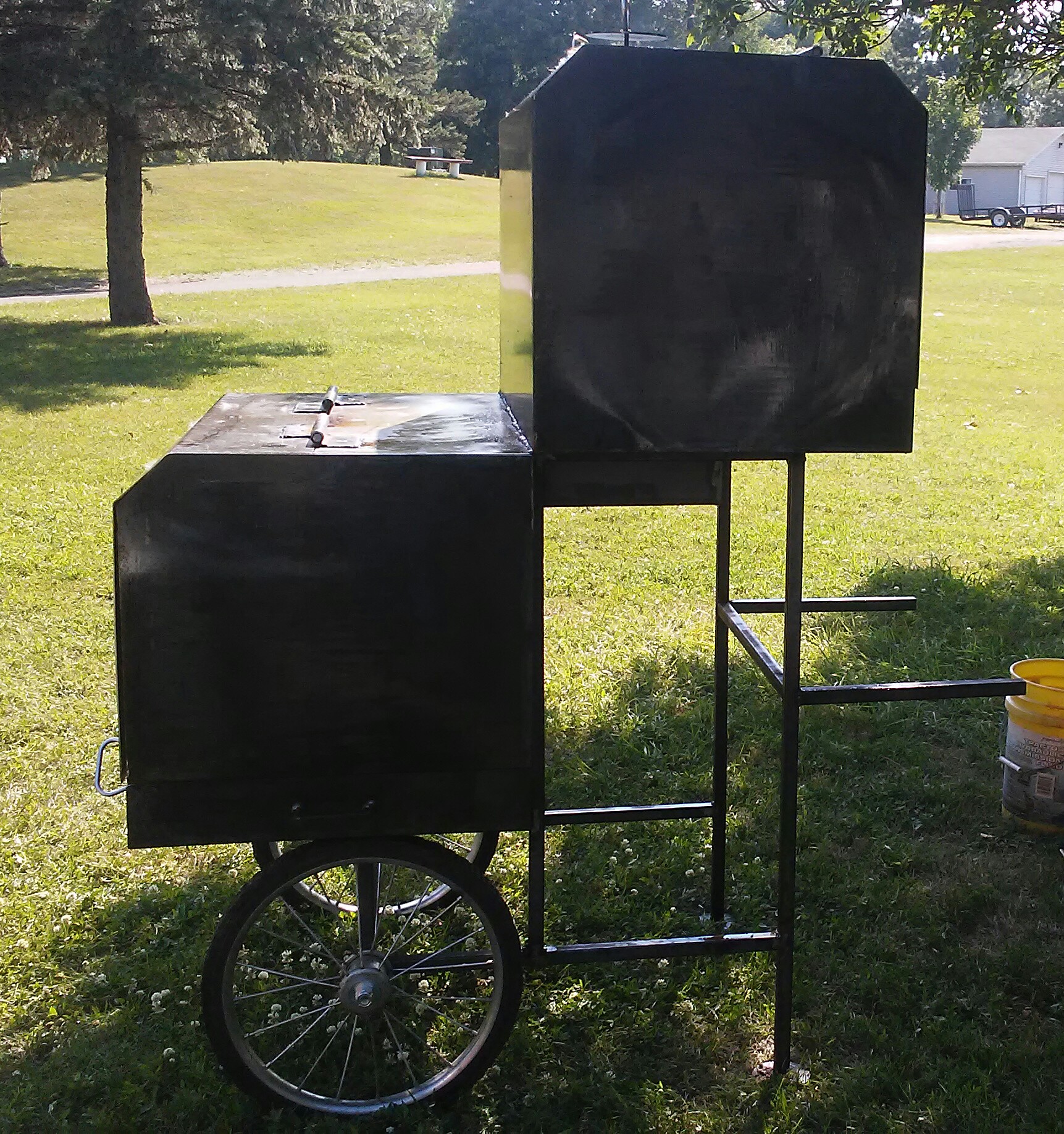

When it comes to smoking meat I am a traditionalist. These pellet smokers just don't do it for me. I enjoy sitting there tending the fire. To me, smoking is an art. That being said, I just finished my new over under grill/smoker.
Each box is 3' wide by 2' deep and 2' tall. 2 racks 30" x 23".   Shelves for 2 racks in smoke chamber,1 in grill. Racks will fit booth chambers. Fresh air intake and exhaust are round plates on threaded rod, so infinite control.
Couple weeks ago smoked 4 pork loins for 67 people at the family reunion. The best I've ever done. Smoked with apple and maple wood. Make my own rub and spray with apple juice and apple cider vinegar, then spritz with vegetable oil.

 NO FAIR,!!!,,,TruckerFarmer,,,you,,,,you,,forgot to include the secret recipe for your rub,,,you can't just tease us with them pork loins and such,,, 'thought lettin us in on the recipe,,,,ClapClap
 Thats a great lookin smoker you made,,,how does it do as far as distributing the heat in the cookin chamber?? I had to "modify" my smoker as the heat distribution was not too swift and you had to keep rotating the meat or on long smokes like a brisket or a big roast ,,,it would cook one side quicker that the other.
 I don't have any problems now as heat is even all the way across,,,,Clap

Like most smokers there are hot spots and cold spots. Although they aren't that bad. The smoke goes through the boxed in area below the smoke chamber and enters the bottom in the middle. Opening is almost full width and 4" across the bottom of the smoke chamber. The 'D' ring handles on the bottom left and the top are the vents. 2 intake and 2 exhaust.   That's why the racks are the same size. After a couple hrs I start temping them and moving them around. I usually flip them at least a couple times. The 2 in the pic I had to finish over the coals to get final temp of 145*. Only took 5 minutes to get the last 10*. The other 2 made 145* in the smoke chamber. Did a slow smoke of about 6 hrs.

The basis design is based of ones built by Xtreme BBQ. I saw one used on Primal Grill with Steven Reichling on PBS this last winter. They get close the $3000 for one this size. I have about $300 into mine. There is almost 80 sq ft of 12 ga steel used in mine. I made a full width ash pan in the grill. Thinking about putting casters on it yet because it is a little top heavy.
