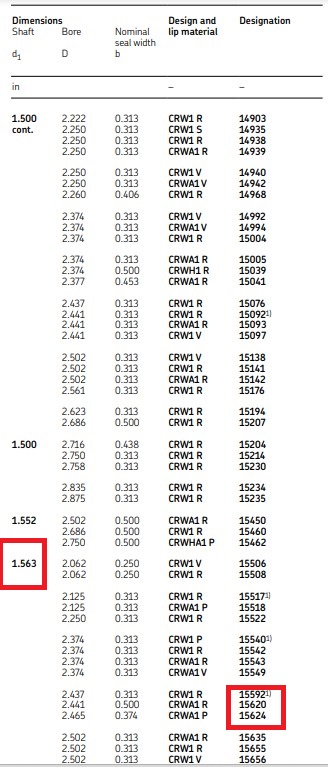

 I have come up on a puzzler on some old oil seals with unlegible numbers and the local Napa and Oreillys are claiming no knowledgable way to do a search with the seal size as  I was very carerful removing the seal so as to not oblterate any numbers that may still be  left,,,,, The first three number are 156_ _ Other numbers on seal are  R28  and  C/R     and USA   .
 I have done several  google searches using different wording on "search by size" and I get nowhere,,,,?? I have a good Starrett Dial caliper if someone knows of a site that allows you to enter the id, od, and the width to find the correct seal.
 Any takers on this one,,,,?? Many Thanks,,,,Clap        -

go to the left of this page and look up the OD - ID........
https://www.rainbowprecisionproducts.com/index.php/oil-grease-seals-bronze-bushings-national-oil-grease-seals-c-292_539#1
Realize that MOST seals are really METRIC size... common lawn mower shaft is .669 inch  bore seal.... that is REALLY 17 mm.

C/R stands for Chicago/Rawhide, a previous manufacture now owned by SKF.
Here is a link to 'Standard and Metric Oil Seal Size Chart' that will keep you busy.
https://www.globaloring.com/oil-seal-size-chart/

What is the shaft size, bore size, allowable thickness and product you are wishing to seal?

  The transmission output shaft size = 1.550
   The Transmission Bore size=====  2.435
   Thickness of seal body======== .500
 Product is 85-90 gear oil

Here is GARLOCK size listing page
1.500 2.437 0.375 63 0649 , 1.500 2.437 0.375 66 0649. 1.500 2.437 0.437 63 0650 ,
... BOREWIDTH. PART NO. SHAFTBOREWIDTH. PART NO. S-1 ... 2.435. 4.094. 0.625. EQ. 4896. 2.436. 3.436. 0.625. EQ ... 1550. 2.625. 3.250. 0.375. 61. 1550. 2.625.
267 pages
Missing: 1.550 ‎| Show results with: 1.550

well the numbers dont exactly line up... but a CR156xx  ... closest one is 15620  ?
 Hey Steve,,I do believe the 15620 is the one I'm hunting. I went down ther but the one guy that WILL do a deep search was not on shift till tomorrow morning and I;ll be thereN bright and early. Now that I look at the almost faded number on seal,,it sure looks like 15620 seal.. Many Thanks to you and Coke,,,!!!!ClapClap
