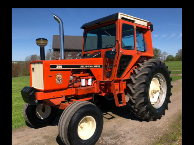

Captain Dana, good job loading photo of your fine looking 7000. Sorry to hear of It’s 301 quandaries. But glad to hear that you’re pressure testing it. Hope you don’t find any noticeable issues there.

Howdy 7060 where the heck u been lol. My whole fleet gets wolfs head or rotella semi synthetic hd 15 40 diesel oil. None ever get near 50 hours before their yearly oil n filter changes. And they have all gotten ALL oils and filters changed throughout their chassis. And all have new heavy duty coolant as per Dr Allis’ recommendations! But this one is a newbie and I’m working out her issues. The 7020 arrived 2 weeks after the 7000 and honest to God she’s perfect! I hope to resolve issues before next spring! Thanks for all y’all’s help!
I been busy farming & assisting older kin folk. But when I sneak a minute to relax, I might be watching/laughing at your WD45 4th gear takeoff videos!! Hahahaha.........great fun there!!
Never doubted for a minute, your excellent tractor oil service schedules.

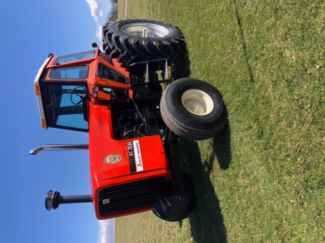

And there you go again,,,,uploading 2 more photos of another beautiful AC 7020, then an awesome 7040, & then guessing your whole AC fleet!! Excellent job!
Always a pleasure catching up with you dear friend. Happy Thanksgiving to you & yours...

Wow nice to to you 7000s line up. I’ll have to come visit and see if my seat lift will fit through 7000s doors in case we ever buy one.

Mikez call and come up anytime!
