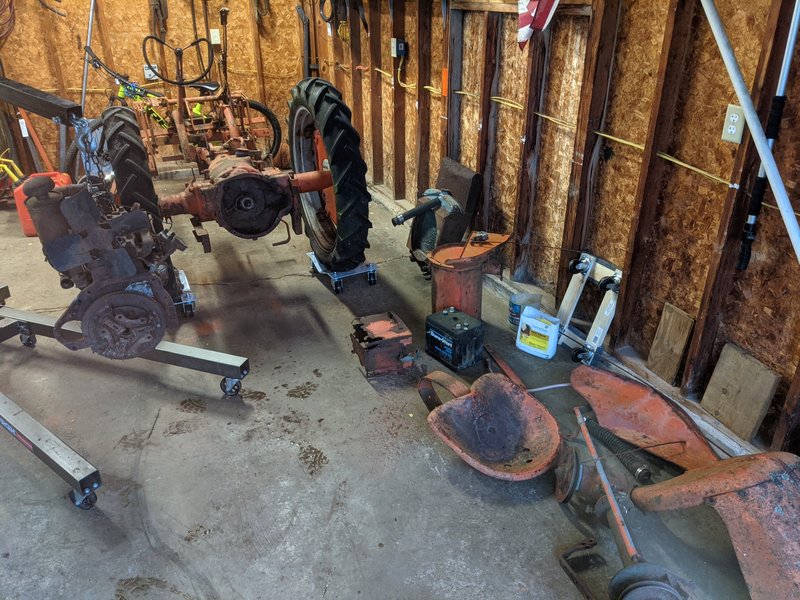

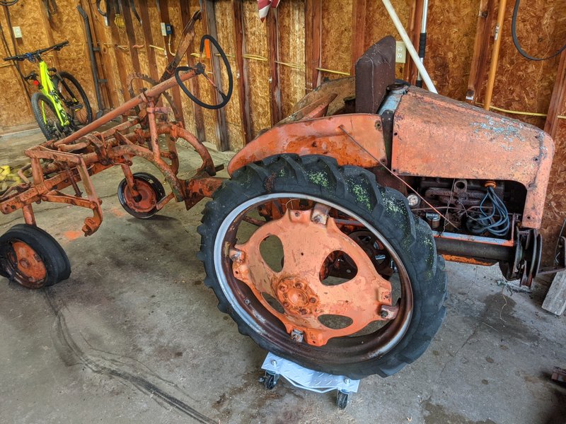

Haven't bought a tractor in awhile. I've always wanted a G, and I would like to garden on a little larger scale someday. I've been keeping my eye out for one, but they seem to command a pretty good price, running or not. Finally found one that needs a lot of help.
Drove way too far and paid way too much for it, but I am now a G owner.
The motor is locked up, as are the rear tires, the air cleaner tube and cup and starter are missing, other than that it is complete, and has the master lift on it.
Put it on some car dollies, pretty handy for moving it around.

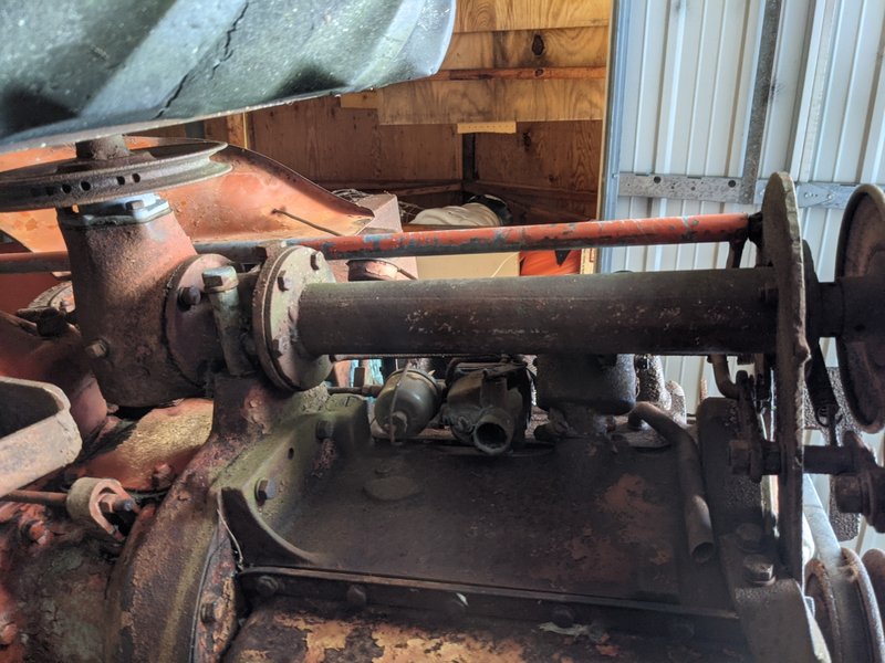

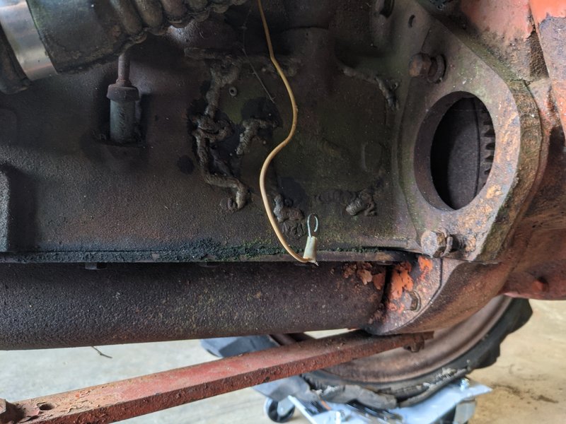

The torque tube flange is broken and repaired, which I guess is common when using this tractor with a plow?  I will definitely be making a frame extension for this tractor, I don't hardly fit on it like this.
Someone must have yanked the drawbar pretty hard, to bust the block and front cover.
It also must have thrown a rod, judging by the welding on the block.
It had an add on screen on the radiator, and an aftermarket PTO, I think the consensus is it is for a Woods mower.

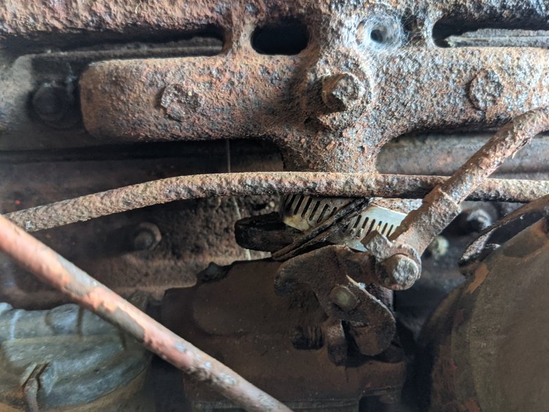

This is a new one- the flange on the manifold is busted, the carb is actually held on with wire and a hose clamp.
This is kind of a long term project (aren't they all). My plan is to pop the motor out, and take it down in the basement for something to do this winter, then bring it all together next summer. Might as well get it apart and see what we are up against.

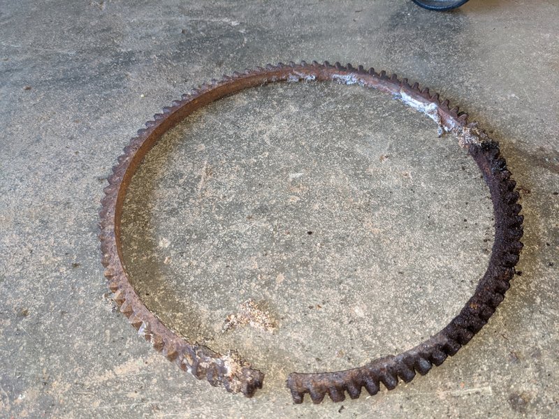

Removed the tin, fuel tank, radiator, PTO, etc. Removed the engine, and the ring gear stayed in the bellhousing.
I'm guessing the flywheel got so corroded it rust jacked the ring gear and it snapped.

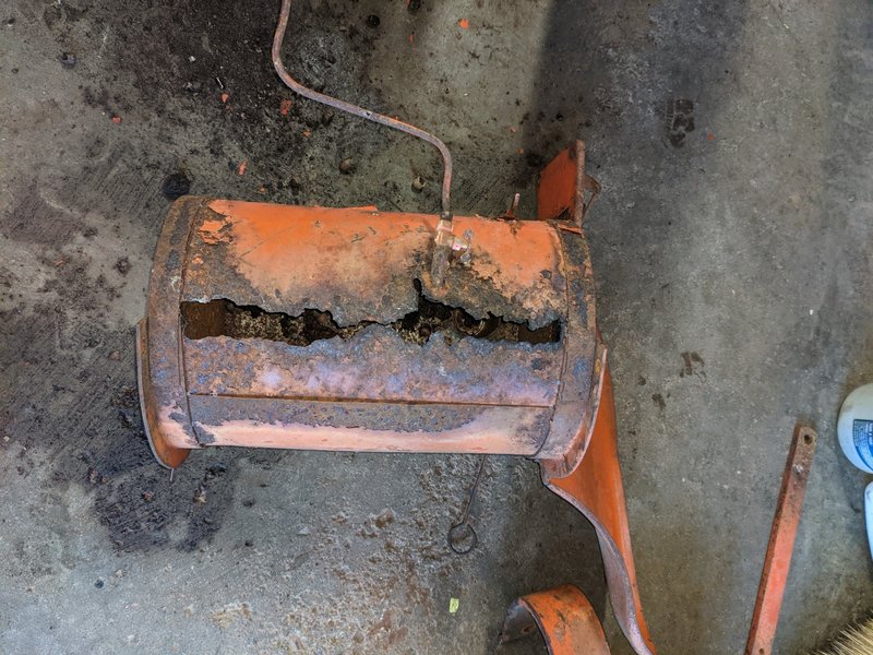

Found a crack in the lower radiator tank, hopefully it can be repaired.

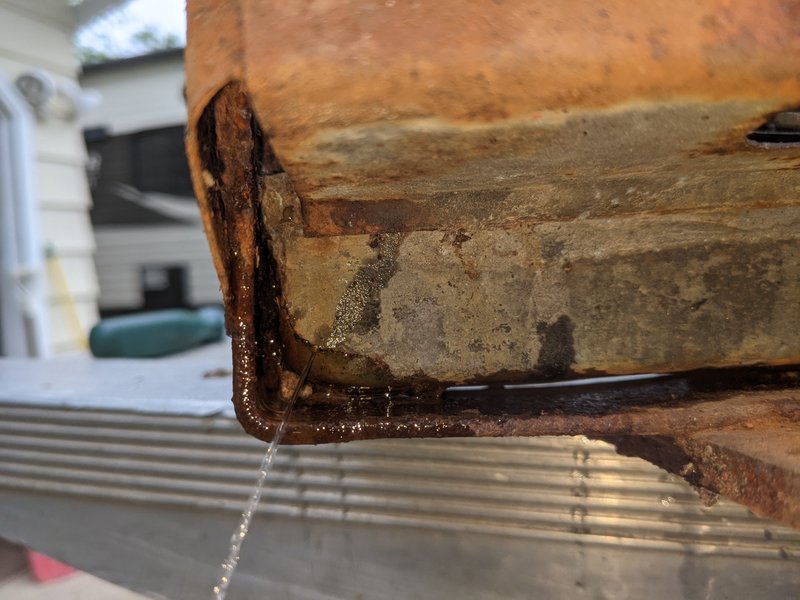

Found a hole in the bottom of the fuel tank, pretty sure that one is beyond repair.

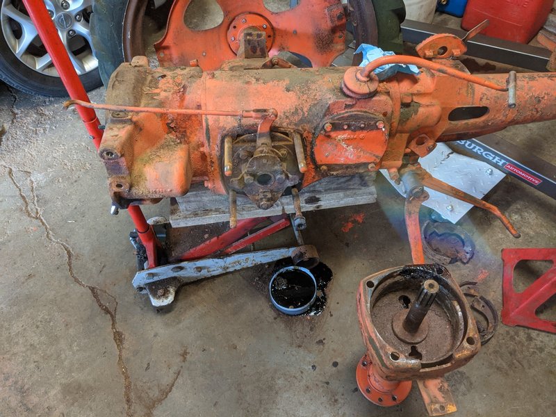

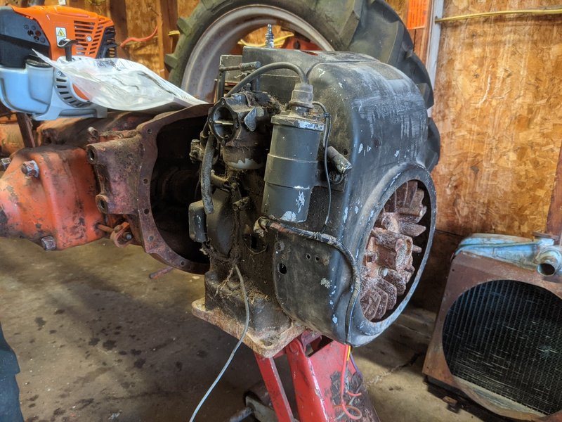

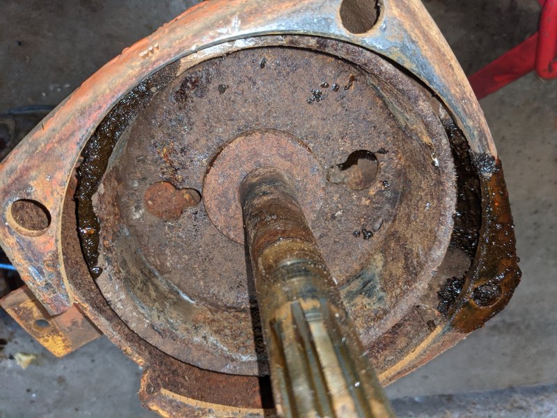

Put the motor on the engine stand for now, moved on to the stuck rear wheels. Jacked and pried and wiggled both final drives off. Removed the shoes for now, they and the drums will need replacement.
I reassembled the finals, jacked the back wheels up, and put my drill on the input shaft to power it, and ran through 5 gears, everything seems to work there.

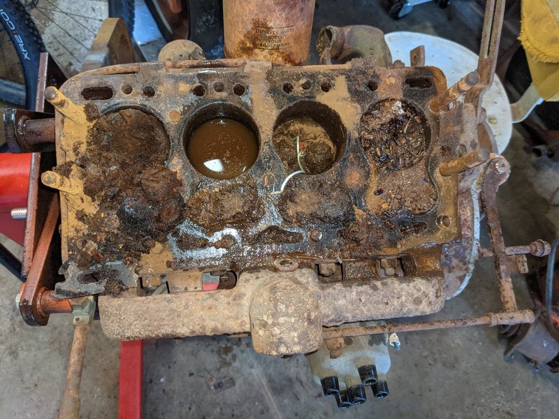

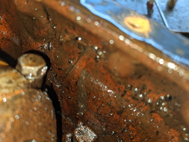

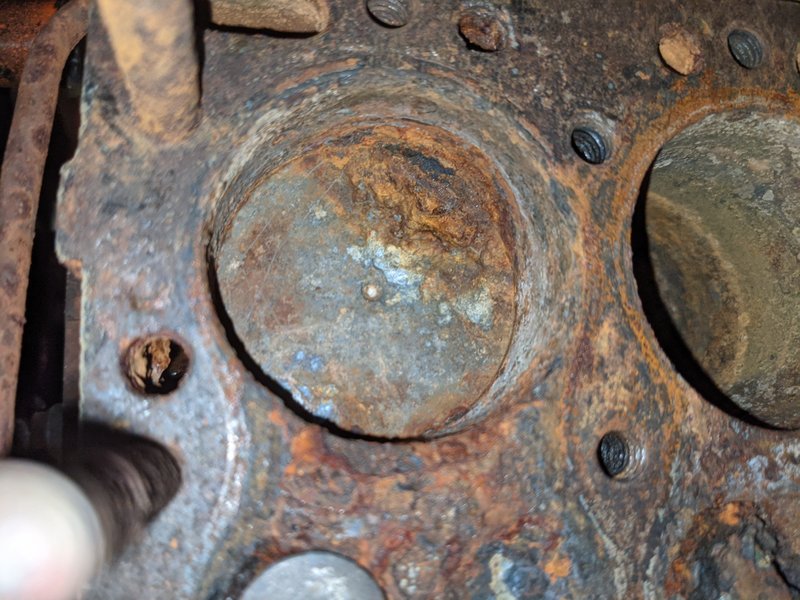

Getting back to the engine, the prognosis is not good. This tractor must have sat for years or decades with no cover on the exhaust or spark plugs in it. Yikes.

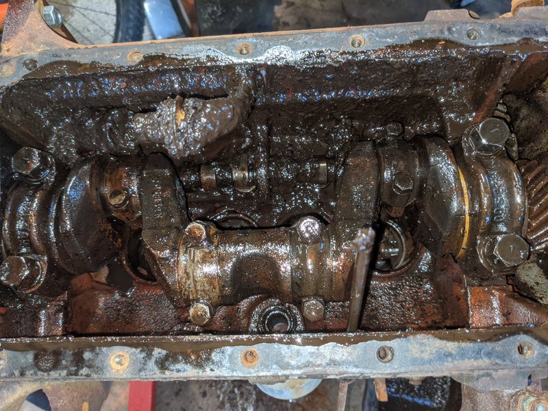

Flipped it over to dump out the cylinders, and the smell that came out of it when I lifted the pan off is indescribable.
I think I was right on the throwing a rod theory, looks like someone tapped the pieces back in and welded it.
Pressure washed the block. At least the bottom cleaned up nice.
The top side is not so good.

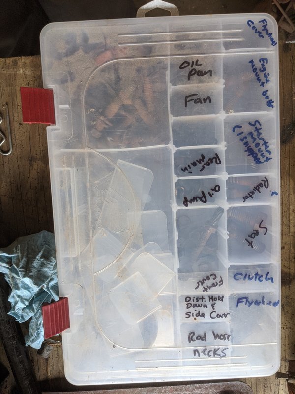

And as always, gotta keep the bolts organized. This project might be measured in years, rather than months.

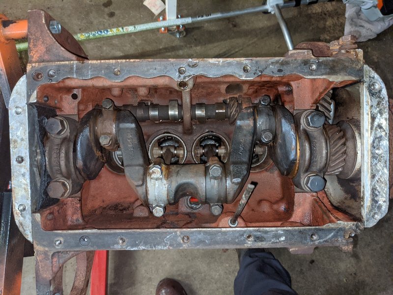

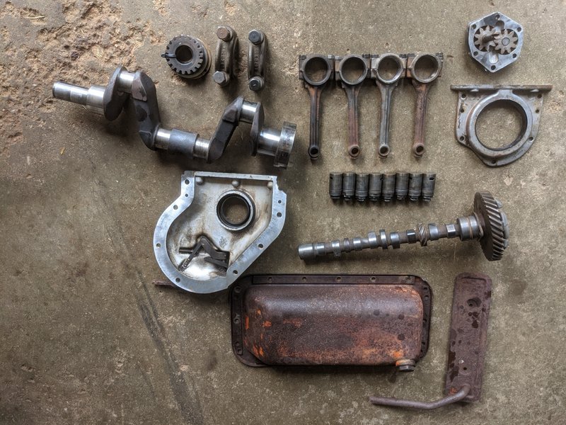

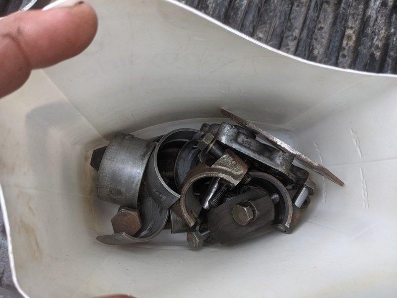

Took some parts to work and cleaned them up, never know when you might need 'em.
Looks like it threw #3 rod, and the crank was never repaired. #3 bearings were smeared and sticking out of the rod and cap.
Got home, and knocked two pistons out. Came out a lot sooner than expected. The two that are near TDC are a bit more stubborn.

when I had my 2nd G, I did find that someone makes 'sleeves' for them. You need to machine the block though....

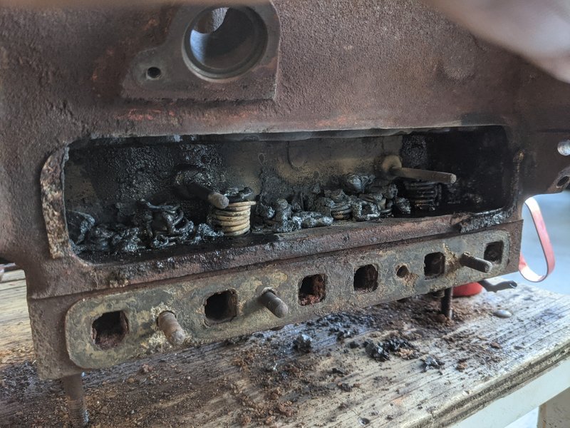

The valves are junk, so I fired up ol' blue point and sliced the springs and valve stems, to take the pressure off the cam so I can remove it.
Got the lifters out as well. Got everything cleaned up, I'd say I got a pretty good pile of usable parts out of that hunk of junk.

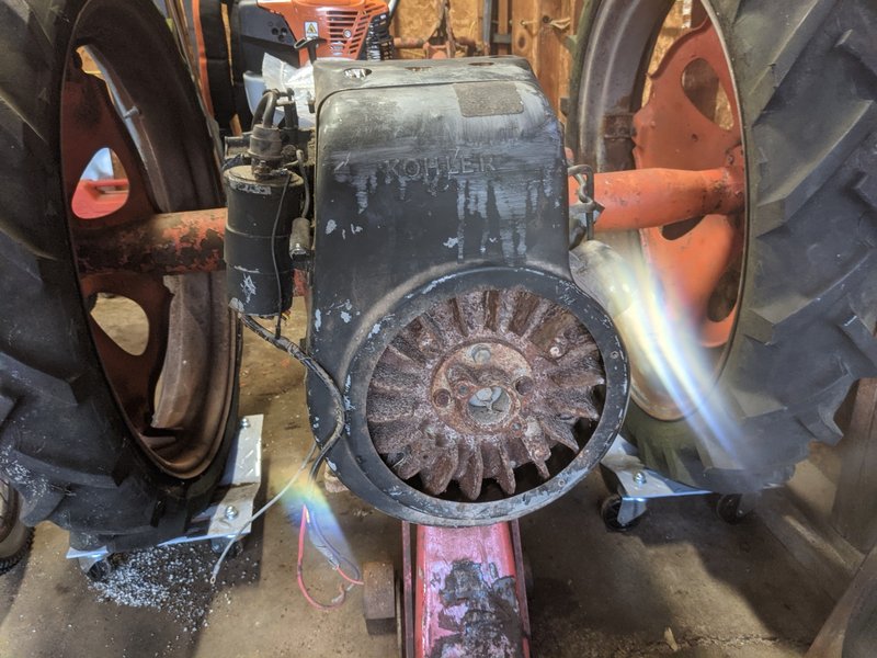

Last winter I bought a pallet of Kohler Cast iron engines. Some guy down in Illinois had them and couldn't get rid of them! Around here you can't find one, and I'm always on the lookout for them, to restore  a 416 that I have, and to keep a spare on the shelf. I watched them on Marketplace for a month, and couldn't believe they didn't sell.
Lo and behold, my daughter had a volleyball tournament in the Quad Cities! Never going to get much closer, so, when we took off for a weekend of relaxing and volleyball, I got up at like 4AM and drove into the Land of Lincoln and came back to the hotel with 7 engines. The old minivan was squattin pretty good with all four of us, all our stuff, and the iron in there.
Sold several, kept two 16 horse for me, and have one 14 horse left over.
Then this idea leapt into mind.
I have found complete engines, they are out there. But the cost is prohibitively expensive right now. This repower looks doable, and, I can do it without modifying the tractor, so it can always be returned to original in the future.
This bears some thought.

I think you found your answer to the engine problem!  Not the first time this has been done and you could have it running this summer.  More power too!

you should lookup the RPMs  both engines like to run at... I'm thinking you may need to run a couple pulleys to match the RPM/torque 'curves' ?
I know with #2 G, I was really tempted to 'marry'  an 'offshore'  10HP diesel to it. The 'numbers' looked pretty good on paper, then ,sigh sold #2 G......
