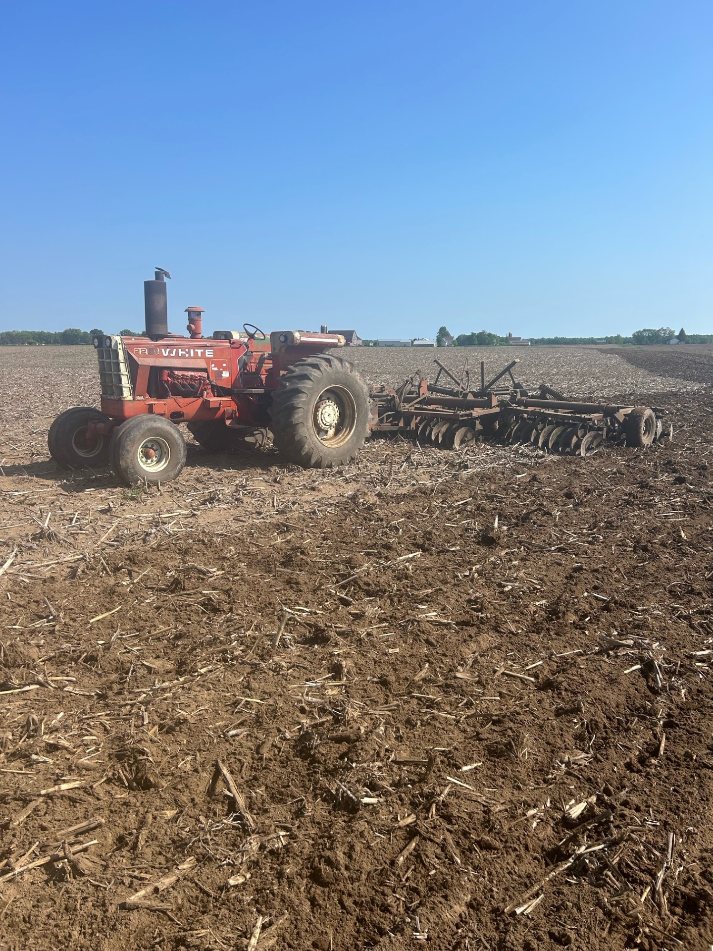

Tbone I'm kind of partial to the v8 whites, I bought this older brother to the 2-180 a few years ago as a toy. It has 6000 hrs on the original 3150 cat which in later serial numbers got the 3208. She's pretty impressive really it will pull these 24 foot disc to the spools at 6 mph if you want at 2200 rpm. It has 1000lb wheel weights in each wheel and loaded 23.1x34 tires.uploads/11464/2255-2.jpg
That’s pretty cool!😎. I’m going to check it out this afternoon. Thanks.
