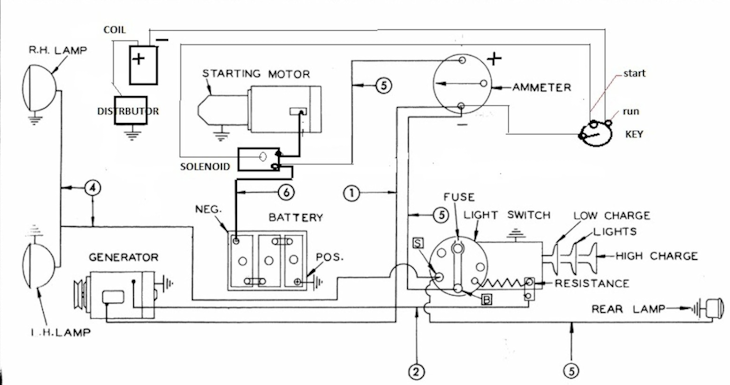

Wiring diagram for a typical AC Model CA

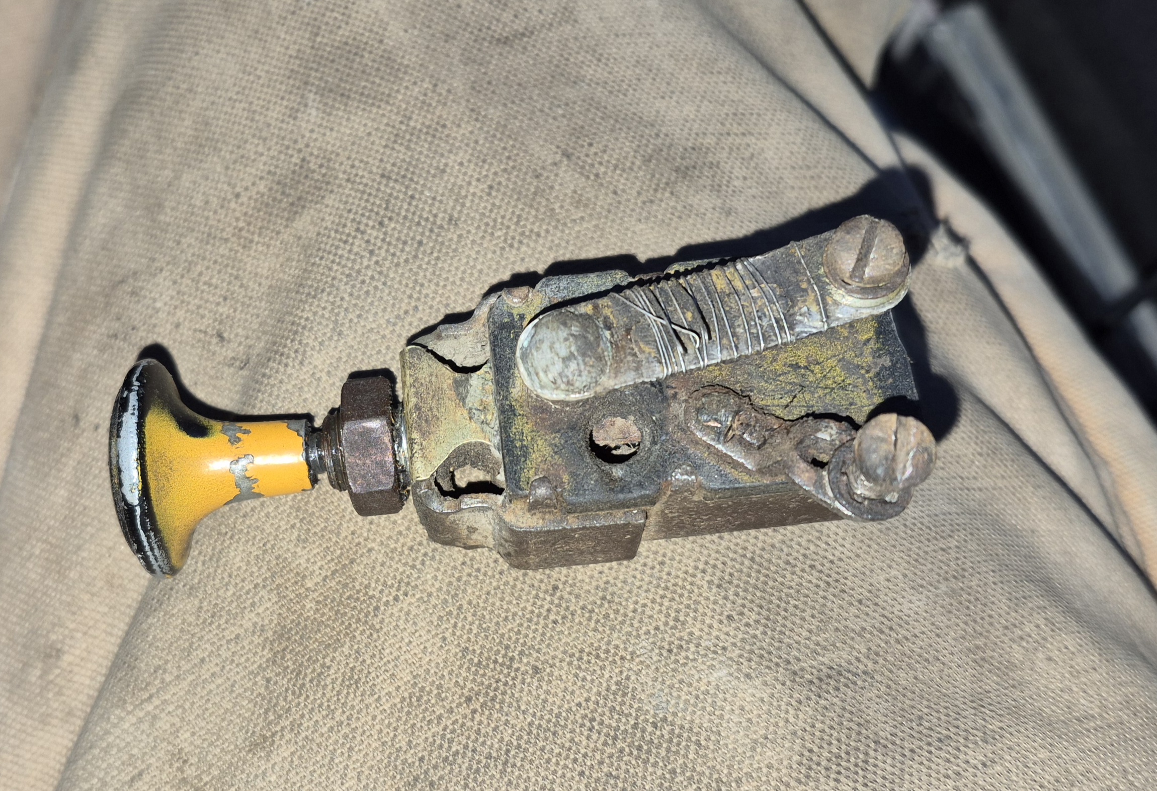

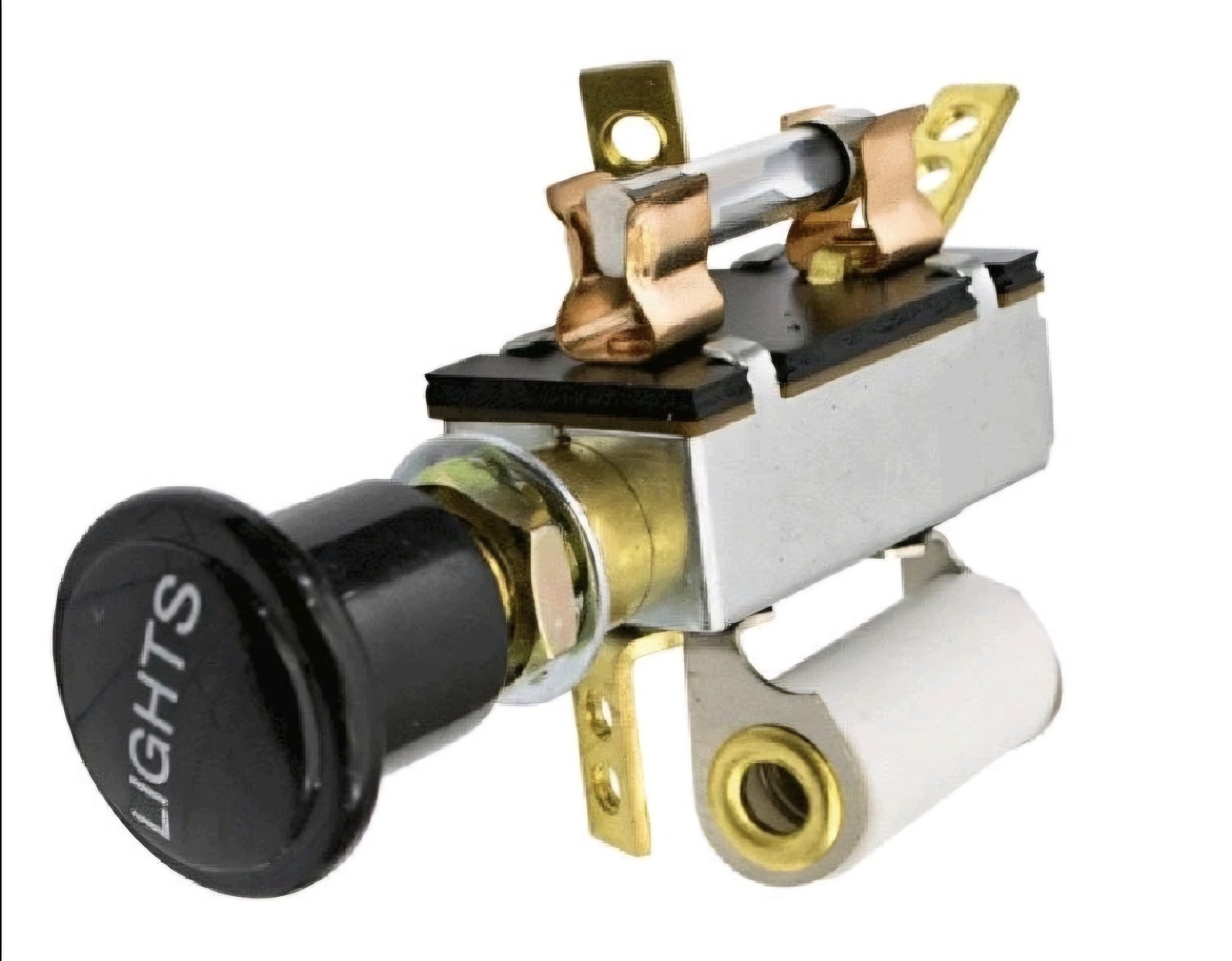

It is a factory 12v system. Here is a picture of the new switch and the original for comparison. The charging system was not functioning when i bought it. The regulator was shot,not sure on generator condition yet. So the lights should be connected to the resistor terminal then? What wire goes to the fuse on the switch then? Original has a fuse on the dash like a hundred series allis uses. Does the regulator break connection on its own then the generator stops spinning?

Ok, I don't believe that anything Steve and I stated above is applicable to your system. We were both referring to the 6 Volt Allis system that uses a simple cutout relay and has no discrete Voltage Regulator as such.

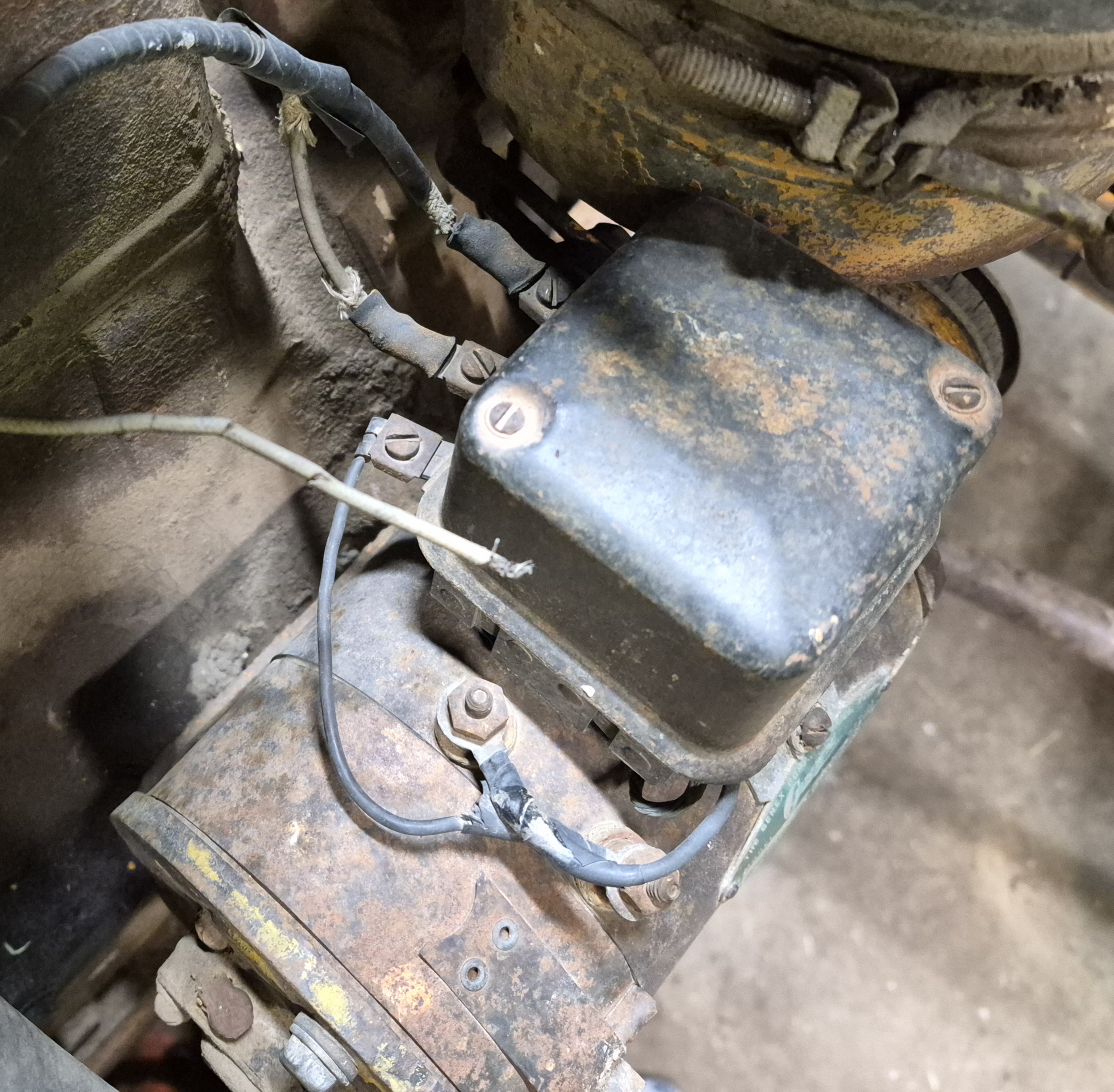

It's a regulator not a cut-out,the broken wire shown is for the front right headlight

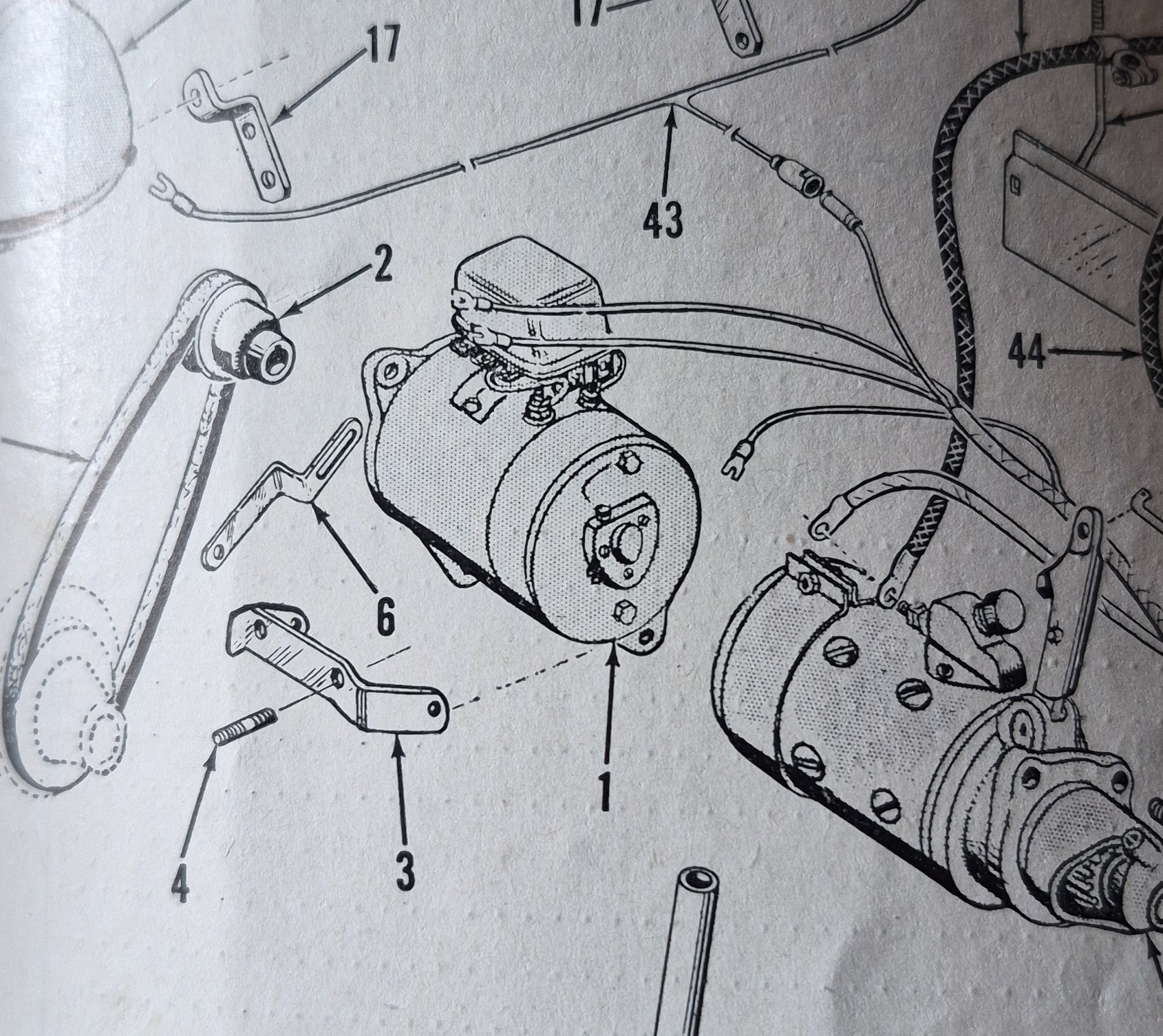

Here's a picture from the parts book, doesn't state regulator or cutout

It has multiple wires going to it so it is must be a regulator rather than a cutout.
With an actual regulator you definitely do NOT want that resistor connected to anything involving the charging system.

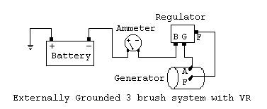

if your regulator has 3 terminals ( none on the bottom) then it wires like this.. If the regulator is 20 years old or more, it probably is causing problems with charge..
If you have a 4 terminal regulator ( one on the bottom)... then the "L" terminal on the side can be used to feed the LIGHTS..

Ok, I want to make sure I hook up the switch correctly. The terminal with the fuse would go to the amp gauge,the resistor to the lights and the other to the regulator then, is that correct?
Points: 90994
Post Options Post Options   Thanks (0) Thanks(0)   Quote steve(ill) Quote  Post ReplyReply Direct Link To This Post Posted: 11 hours 44 minutes ago at 4:17pm
i would guess that the OUTLET from the amp meter is the HOT feeding the resistor.... and other OUTLET of the resistor goes to the lights... somehow when you pull the switch to BRIGHT, it bypasses the resistor and puts the amp / power straight to the lights.
You want to make sure that the NEW SWITCH does not GROUND the RESISTOR outlet side to the SWITCH CASE.... thats what MOST of them do when used with the 6V generator.

Post Options Post Options   Thanks (0) Thanks(0)   Quote Les Kerf Quote  Post ReplyReply Direct Link To This Post Posted: 11 hours 6 minutes ago at 4:55pm
Yup.
If that new switch is indeed identical to an Allis-Chalmers style light switch then the resistor will apply ground and you will let the smoke out of something that you would rather retain un-smoked.
I would NOT connect that resistor to ANYTHING for now.

Agree... the resistor is Useless.. Forget it... You can use the switch to turn the lights ON and OFF... thats all you need on that end.. For the CHARGE system, follow the drawing above for the regulator / generator..
