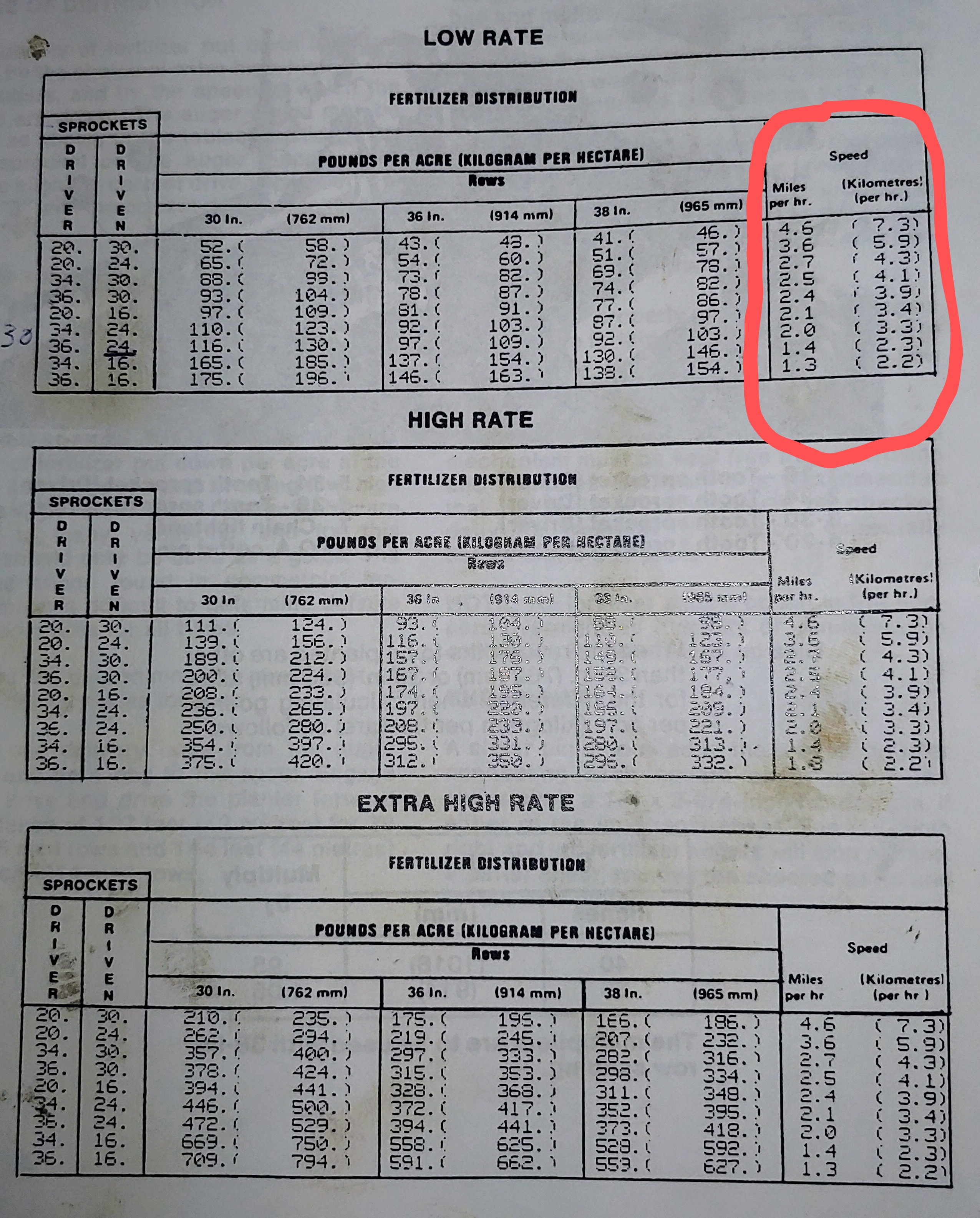

Hi all, ended up with a good shape IH 800 6rw Cyclo Air planter. Anyone in here familiar with using them? My particular question is regarding the dry fertilizer application chart; on the right side it has various speeds but in the description it doesn't make any mention of what they are for. The implication would be the higher the rate the slower you're supposed to drive but in practice is this what people do?
Previous owners experience was you could go faster than these speeds and still get the rate.
I'm working on trying to achieve a higher rate but so far can only find low rate augers, really need the high or extra high ones
Matt

For fertilizer, I would think the rate would stay about right, but keep in mind you'd be spinning things very fast.  For seed population and spacing reasons, I'd be more concerned about a max recommended speed then fert rates.

At higher rates and higher speeds fertilizer may not flow as fast and it could affect the rate.

In short~All planters share a usual commonality ~ their primary function is seed metering. Seed metering heavily influences each planter’s capabilities for its forward travel speeds. Hence; each planter may also offer various fertilizer/insecticide RATE options (secondary functions)of low, heavy, very heavy that allows operator some flexibility for secondary functions.
So if one begins by selecting best seeding parameters for planter, a BALLPARK travel speed becomes realized. Those parameters usually include; Seed shape/size/population/soil conditions/etc.. ?
Once a DESIRED SEEDing forward travel speed is determined, any SECONDARY FUNCTION may then be dialed in. Regarding your IH800, it offers 3 fertilizer auger choices (low, heavy, very heavy).

If you think you really need a high rate fert delivery out of your planter, so much so that your fertilizer system speed is trumping your seeding speed, I'd reconsider the fertilizer plan.  Spread 1/3 to 1/2  of the fertility needs and the remainder run through the planter.

Thanks guys, planning on just corn for now, have the right drum and I saw the stand it was putting in was pretty good.
I'm not worried about the seeding rate, I realize especially the cyclo planters are very picky with speeds.
My concern is just the fertilizer; the manual makes no reference at all about speeds and fertilizer (talks a lot about seeding rates and speeds).
The thinking is probably as said that spinning the auger at speeds faster than which the charts were calibrated affect the rates. However, it's just an assumption
I'm trying to find higher rate augers but no luck here in Canada yet... New from CNH they're $250 Cad each, be up to $2k to outfit all 6 rows
100lbs looks doable which is kind of the minimum I'd want, really want 150
