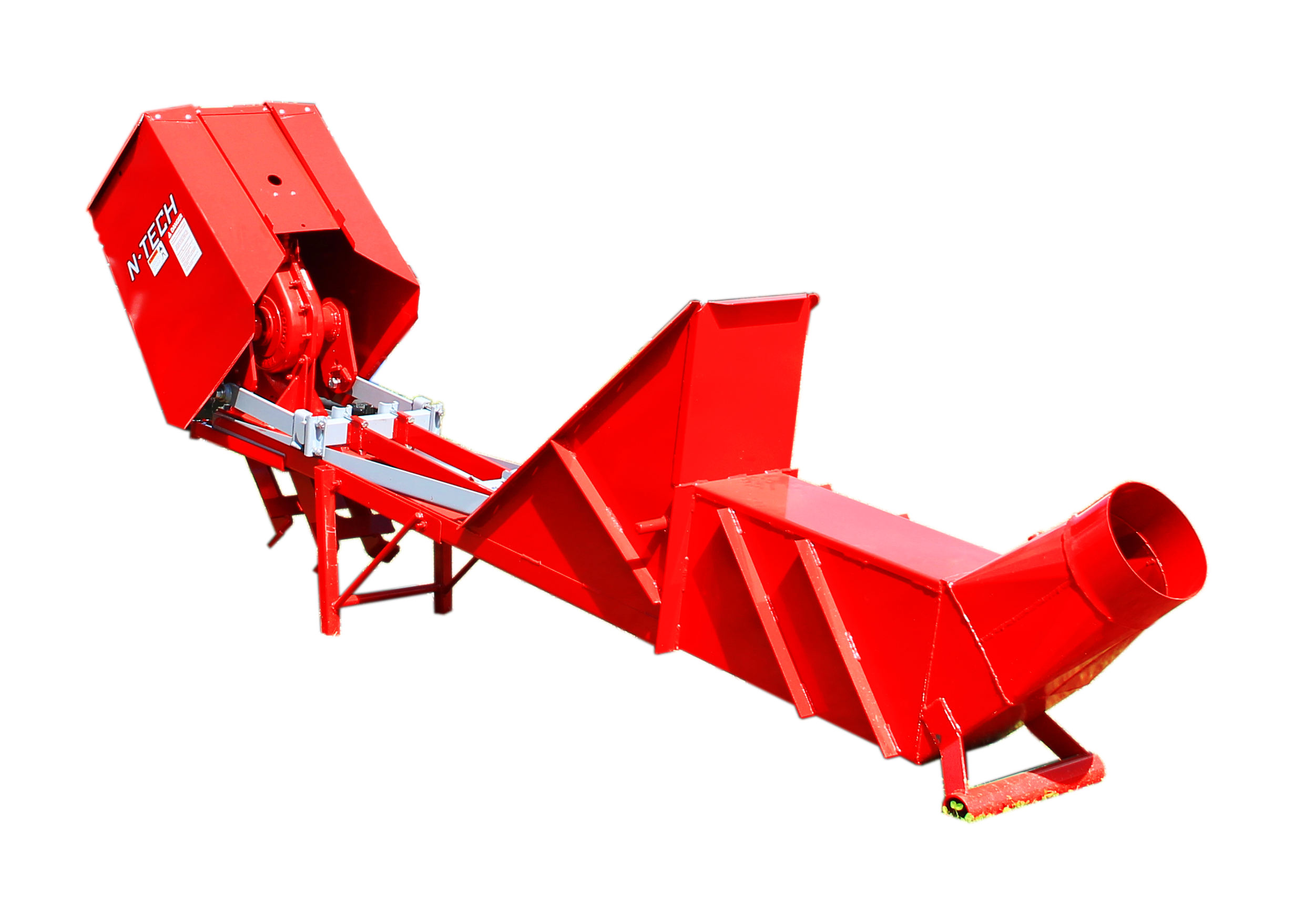

Never used a piston pump like that before always used a propeller type pump. Company such as GEA or jamesway still make them I’m sure. There is a company called N-Tech that might make a pump like that. Google any of them and get some contact information

Tech makes a piston pump but the ones I like are made by Zabel they use a hydraulic cylinder instead of a gear box.

N-Tech pumps... Built in Barron WI.
