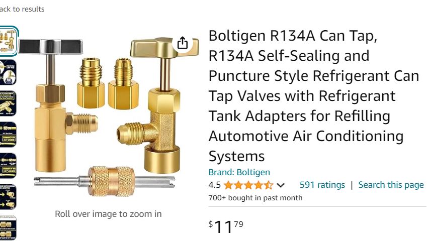

  A buddy came over  to get me to check out The AC on his little truck, and I find where I am kinda behind the times,,,,,,LOL
 Had him turn AC on and clutch never offered to engage, so I hook up the gauges and system shows no pressure.
 I tell him there must be a leak in system, but no idea how big a leak system has and can add some freon and see how long it lasts before system leaks down again,,,,?? He comes back with only one of those small cans of R134. I notice that the discharge port in top of can is different that I remember from a while back. This can has a pre-drilled hole with a |valve looking apparatus inside that hole,,,,??
 I tried hooking up my gauges but the "NEW GENERATION" can could not be punctured to release the freon  into the system,,,????
 Anyone got any ideas,,??
Points: 90808
Post Options Post Options   Thanks (0) Thanks(0)   Quote steve(ill) Quote  Post ReplyReply Direct Link To This Post Posted: 22 Jul 2024 at 7:46pm
YEP... a few years back they put a CHECK VALVE in the can so all the goody dont leak out when you onlyuse half a can... and they made it SO YOU CANT USE THE OLD can valve/ .... your hose / gauge set will be OK...!!...... Time to Visit NAPA or AMAZON !

 Well,,Thanks Steve,,, I guess it has been a while that I had not had to use my AC hoses,,,,,LOL

 Hey Lars,,,I was just poking "Fun" at my buddy cause he just bought one little ole can of freon,,,,he's just like most of us poor folk and wanting to do more with less,,,,,Wink
 'sides,,,I told him if he wanted me to add freon to his trk, he gonna have to bring me the special adapter to use the new style cans,,,,PLUS one more can of juice,,,,,Clap
 HMMmmm,,,now,,I'm wondering if the 97 Fords have an orifice tube,,,,as there is a slip  connector on the high side line going to the compressor,,,,??
 Yeah, Lars,,I bought one of those big cans with everything needed,,,and,,,,and,,,I think it was almost $50,,,,,!!!Wink
