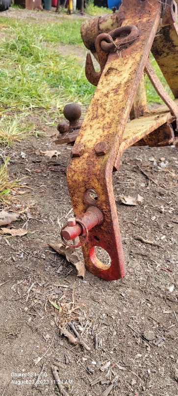

Tbone95 and all who are interested
Here is the top sensing hitch !
Simple hitch honestly.
This hitch came with our Allis plows back in the 70's.... Plows are long gone but Dad saved the hitch. Wish we would have kept the plow draw bar too as it acomidated the large holes in this hitch but it went with the plows..
The large holes in this hitch whet over the plow hitch and a standard 3rd point went to the usual place on the tractor which senced feedback pressure. THE tractor we haD at the time was a MM670.
I belive Dad bought Allis Plows with the MM670 which would make sence why the plows had that top sensing hitch.
Shortly before we sold the MM670 remember dad cussing and cranking on some screw on the back of the tractor and FINALLY the draft control started working.
Then we bought an XT 190 and this hitch was not necessary.
Enjoy the photos.
Edited by Macon Rounds - 23 Aug 2023 at 11:21pm

Macon you need to send that thing to me so I can try it out. Better yet I’ll meet you halfway and buy you dinner.
Like Doc said, the pull point of the plow is below the connection to the draft arms of the tractor so that it rocks the top link forward.
Other than the specific attachment to the plow, I can’t see how the color of the plow or tractor would matter.
