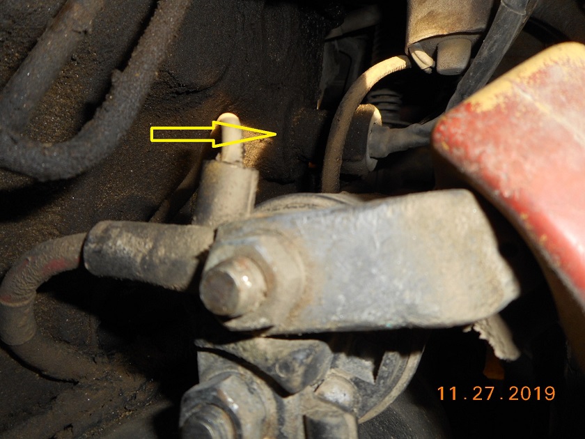

Just checked. Mine is in a threaded hole above the rear of the starter and below the line of core plugs. It looks to be 1", might be 3/4". Size should show in the 4.236 parts book. I think this one is a JEB brand heater, it was in it when I got the machine.

Thank you— was hoping it would have been on the other side so I don’t need to pull the starter again. How well do you like that one? I want to use this some for snow.

It works fine. Usually a couple hours is all it takes to make the difference. I often run it longer than that, then it starts like summer. During snow season I keep it plugged in to a remote controlled outlet adapter, so I can turn it on when I get up in the morning and it is ready to go by the time I need it. I don't know what size it is, as it was in the hoe when I bought it. I would guess it is 1000 to 1500 watts. I am not sure that j.jeb is still making heaters. I have had good luck with Kats and Zerostart/Phillips as well. That plug is just above the starter at the back of the block, I think you could install it without removing the starter (I fully understand your not wanting to do that, I've had that pleasure as well).
