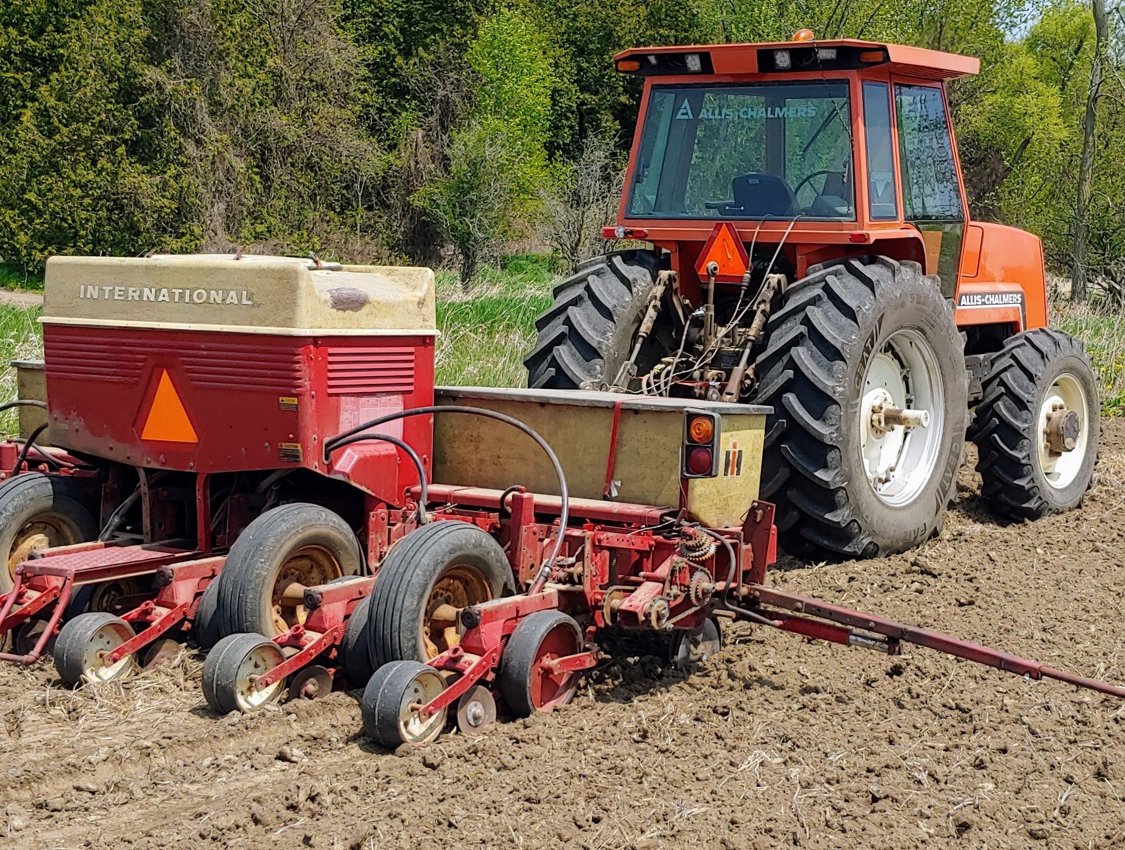

is this a recomend no till planter ?
Points: 8686
Post Options Post Options   Thanks (0) Thanks(0)   Quote SteveM C/IL Quote  Post ReplyReply Direct Link To This Post Posted: 30 Jun 2023 at 7:28am
If you're gonna be around a few years I'd pay the piper and get a 7000 JD finger pick up. parts are readily available.

I was in a similar position looking for a 6rw corn planter; wanted a JD plate, nearly pulled the trigger on a good shape Allis and ended up with a 800 Cyclo air.
Never planted corn myself with it till this spring, planted 80ac.
I spent a lot of time pulling the machine apart, repairing it and researching it before went to the field and was still humbled by it. Really know the machine and it's operation inside and out before launch is my advice regardless of the brand
My stand looks good now, not real even spacing but I know I can improve on it; a smoother seed bed and more downpressure I believe, I'll know next year lol
Cyclo seed monitor was a big help, mostly for peace of mind and caught a few plugs, just a simple blockage monitor something to consider.
