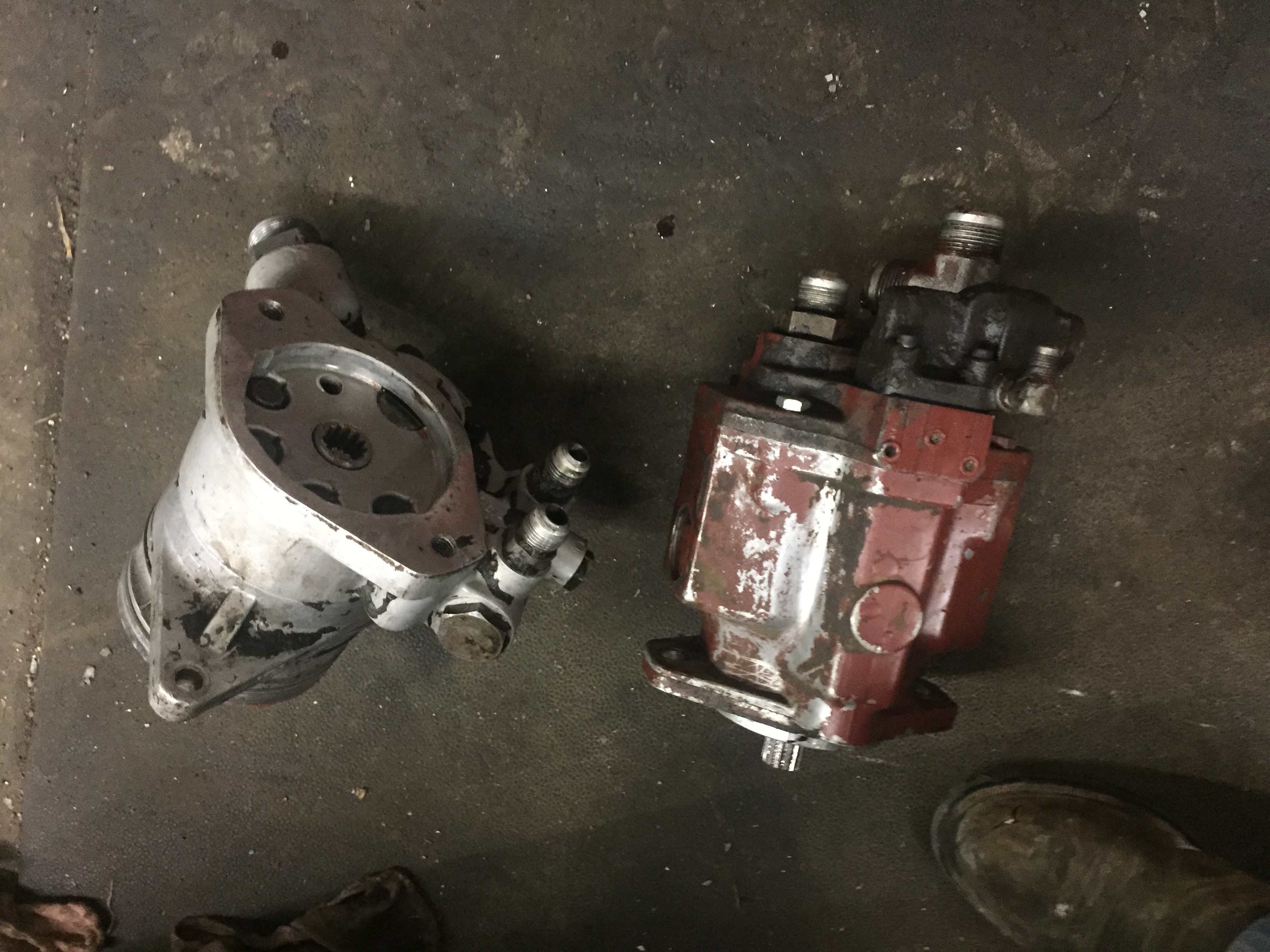

Hey guys, Iam looking for a gerotor pump for a 7000 series mine is a 7040 that runs the transmission the other pump is fine,is there anybody that might have one for sale and how much, you can pm let me know, thanks steve

Post Options Post Options   Thanks (0) Thanks(0)   Quote sason Quote  Post ReplyReply Direct Link To This Post Posted: 27 May 2017 at 7:09am
I have both pumps off a late 7040.
Will take 400 for main pump and 200 for gear pump

Post Options Post Options   Thanks (0) Thanks(0)   Quote sason Quote  Post ReplyReply Direct Link To This Post Posted: 15 Jun 2017 at 7:27am

Post Options Post Options   Thanks (0) Thanks(0)   Quote 7040 allis Quote  Post ReplyReply Direct Link To This Post Posted: 15 Jun 2017 at 12:14pm
The pump work great, we are up and running, shifts really smooth. Thanks for all the help on this site there's a lot of knowledge. Mack you take care of yourself. Thanks steve
