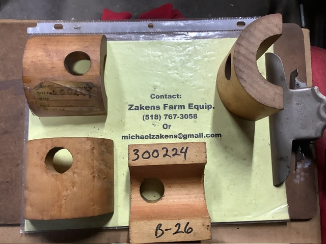

I don’t have any left
Points: 8912
Post Options Post Options   Thanks (0) Thanks(0)   Quote Mikez Quote  Post ReplyReply Direct Link To This Post Posted: 21 Dec 2023 at 2:49pm
I just looked that part number 300224 up and it says it fits a 9,10,10A,11B. So maybe that doesn’t help you. Sorry

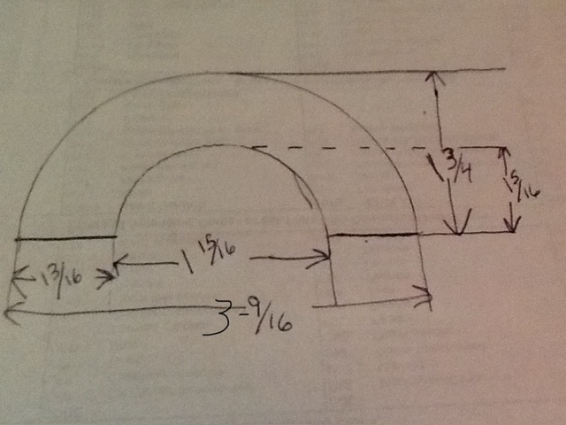

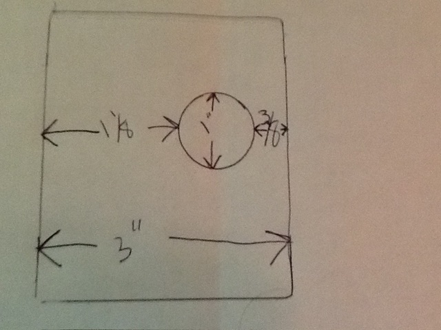

The  drawing is the correct size for my disc.  300224 is the correct number.
