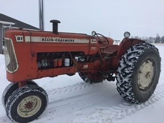

I am looking to replace the tires on my D19 narrow front and am look for the correct size. 16.9-34 rear but need to know what size front to make it set level. It has 15-7.5 fronts not that are not correct. Thanks for the help.

Probably 6.50 x 16's and it will depend on what the actual diameter is of your 16.9's on the rear.

BKT 16.9-34 are 62.4 in the specs.

Reference I have states fronts were either 6.50 X 16 or 7.50 X 16. I would think the smaller ones were on the narrow front and the 7.50 X 16 were on the wide front

I'll look in an Owners manual when I get home, but I think 6.50 x 16 was the standard front tire and 7.50 x 16 was the optional tire made no difference wide or narrow front.

We have 7.50X16's on ours.

One of mine has 7.50-16 and the other has 9.5L-15. Both have 16.9-34 on the rear.
