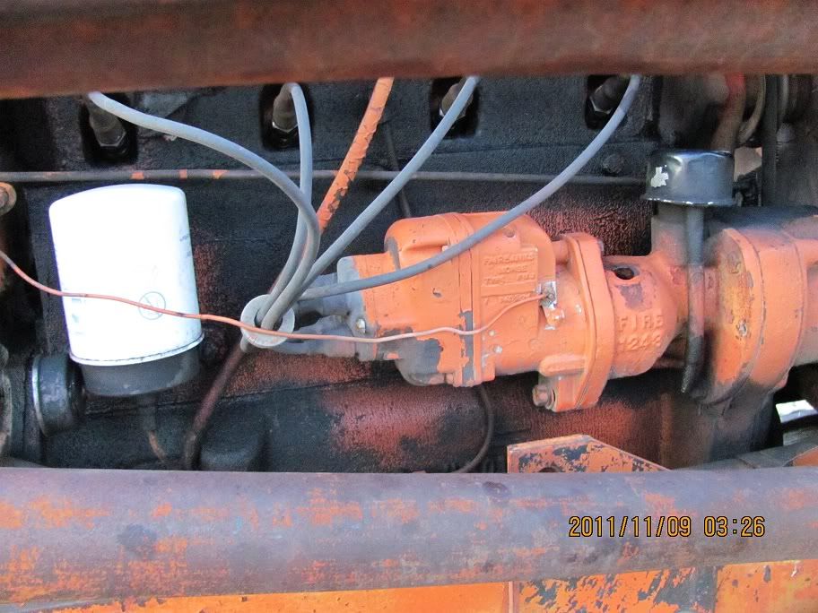

I just purchased my first tractor, it's a 1956 (from the serial number) WD-45.  My wife and I bought it to do things such as plow up our horse pastures, and move round bales.  Problem one started when we unloaded it off the trailer, I had stopped at a gas station and filled it straight from the pump, which apparently broke 60 years of dirt off of the bottom of the tank, and clogged the fuel filter.  I cleaned the filter 8 times, then cleaned the tank out, and all the fuel lines, and rebuilt the carb.  Problem 2 came when it would run fine for a minute or two, then die.  A friend of mine helped me with problem 2, by showing me that either the charging switch, or kill switch were bad (you had to play with either of them to shut it off or make it run, but it ran fine if the ground wire was disconnected from the magneto.)  I decided to rewire it, but, whoever did the 12 volt conversion left the factory ammeter on the dash, and I wanted a voltmeter.
From what the previous owner told me, there was a kill switch to shut it off, and a key switch to allow the alternator to charge the battery.  All was fine at his house, but I think a 50 mile 70 mph trip on a trailer changed some of that.
I have no experience whatsoever with a magneto powered tractor or vehicle of any sort.  What I do know, is the alternator has one post on the back of it, then a plug in the side of it with two wires in it, so I imagine it's the "3 wire" alternator everyone talks about here.  I'd like to use just 2 simple on-off toggle switches, and the voltmeter, so what wire from the alternator goes where?

     After reading through other posts here stating that WD-45's never had a magneto, I looked through my owner's manual and it appears the green people were wrong and it does have a distributor.  My bad.  I have the owner's manual that came with it, and the picture matches what's on it, so I guess it's a distributor, just not like any car I've ever seen.  I guess I'm really confused now.  I thought a 55 year old tractor would be simple, but, it probably would be easier if it was green.  Don't worry, I'm not going that way, I'll eventually figure it out

45's didn't come with a mag but that doesn't mean someone didn't put one on it. I find that the dist does look similar to one on a car. With a dist the wires should come out the top and have a round cap. with a mag they will come out the end (horizontal) and have a squarish cap. The dist will have an external round coil and the mag should have the coil inside . If it infact does have an alternator and 12v batterie make sure you have a 12v coil or voltage reducer if it has a distributer. Good luck with it and you'll get any help you need right here. HTH

you should get in touch with Steve at B&B and switch it over the electronic ignition.
He'll supply the wiring diagram and all needed parts.
Very reliable system!

 The alternator and magneto have no connection to each other. Any working alternator will regulate itself whether the lights are on or off. If properly wired you should only need one switch to turn the tractor on and off and one switch to run the lights.

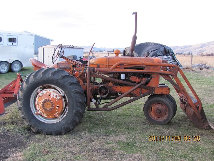

Okay, I did a little closer checking today, and the engine on this tractor doesn't match the factory owner's manual for the tractor.  The intake and exhaust manifold don't match what the picture's in the owners manual are, and the "magneto" doesn't match the picture of the "distributor" in the owner's manual.  My wires for my plugs come straight out of the back of what I think is the mag, whereas the owners manual shows the distributor at a 90 degree angle of what I think is the mag.   The guy I bought it off of owned it for 6 months and said he had too many near death experiences on it with the narrow front end, thinking he'd roll it...he lived on basically the side of a mountain, and there were no places on his property that were'nt at least a 15% grade, so I can believe him there.  The guy he bought it from claimed to have owned it from brand new and never really did anything to it.  The guy I bought it from was the one who put the alternator on it, he said it was still 6 volt when he bought it.
     Another mystery, looking at the factory owner's manual, is that it shows a charging switch, and a magneto switch, even though elsewhere it does mention a distributor.
     As far as serial numbers, the number on the left rear of the tractor is 104290, and the number on the engine is WU214144GA.
      I've added pics to this post, not sure if they'll come through, but if they don't, I'll try again tomorrow.

Is the gear shift lever straight or is it curved? If it's straight it is a WD. If it's curved it still could be a late model WD or a WD45. The WD engine has a big metal plate bolted to the side of the block. A wd45 engine will have no plate.
I'm betting you actually have a WD but I could be wrong.
Edit- according to the serial number you gave, the tractor is a 1951 WD.

I can't figure out how to post pics here yet, so for now, the pics can be seen at:  http://s909.photobucket.com/albums/ac299/timzrabbit/Allis%20Chalmers/
I hope this helps you all figure out what I've gotten into.

The shifter is straight, so, it's most likely a WD?  What does that mean to me, what are the differences between the two?  Did I really lose out in the deal?  I probably didn't since I can do what I need to do with this tractor, but I'm interested to know the differences.  Oh, and it does have that quick coupler thing, and has the spinout rear wheels, if that means anything.

Looks like a WD......does have a WD45 carb though.....looks like a marvel schebler carb found on a WD45 anyway....can't tell if my eyes are playing tricks on me....The air hose is the same diameter on both ends it looks like also...so if it has a WD45 carb it also has a WD45 air cleaner.

Definetly a WD. Straight stick,lifter cover plate & WD style manifold.Nothing wrong with all that,it's just not a WD45.If you ever have to overhaul it,put a 45 crank & D17 pistons in it and put a 45 manifold and carb on it.You'll be pleased with the results.

104290 is a 1951 WD. WU214144GA appears to be a 1949 engine, maybe a power unit transplanted to the tractor. The G on the end is for gas fuel and the A I believe means it had higher compression for high altitude.
 There is no reason why you can't add a live hydraulic pump to run the loader. You might want to research cost and trouble verses using what you have. I added a valve to my 45 so I can run the lift arms separate of the loader. That's a great improvement over having a single line run everything at the same time.

She looks pretty good to me for a working tractor.

Thats a wd, looks pretty good too. Dont hesitate to restore it. It may have 45 engine guts, if it runs well do a compression test, if that checks out, switch to distributor and Pertronix ignition, copper core wires, autolite 295 plugs, straight pipe the exhaust, 12 volt, all will give more power. Youve come to the right place for info, you should be proud of that little tractor. Trev.
