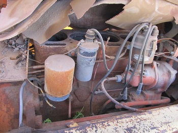

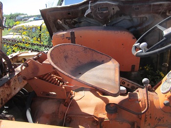

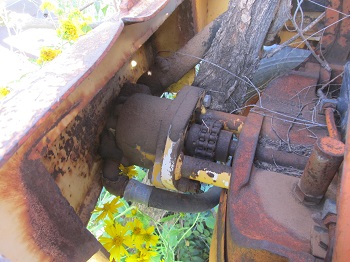

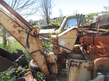

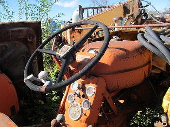

OK,,my thanks to CTuckerNWIL and beaud_250 for filling me in on how to post pics here, so am goin to give it a whirl,,,wish me luck,,
   Man,,,I do not know what the hay happened,,I resized all the pics but some came thru in full size and have screwed up big time.
I will delete these and start all over    SORRY !!!!

Desert joe, what are you sorry about, you got the pictures posted didn't you?
Looks like thats just an old D15 under the loader and backhoe.

If my dad or grandpa ever seen me take a allis Chalmers tractor apart especially something like a engine!!!!!
And leave it uncovered in the elements he would have wooped me good
Can't believe some people and even worse he lost the parts he took off!!!!!!!!!!!!!!!!!!!!!!
What is the deal?
Some people should not be aloud to touch tractors
A replacement engine could be pricey tell him 500 as is
Being you are having to find a complete parts engine.
I like the loader on the old girl looks pretty tough
I seen it had spin out rims as well I also assumed they were fixed non adjustable kind of odd
Wonder how much of the parts in her are good yet?
How long has it been sitting?

I still haven't found a pic of a D14 or 15 engine with cylinder head and valve cover so I know what I'm looking for.

Not that I claim to be an expert but it's missing so many parts, head, carb etc. With the head gone for who knows how long, that motor is likely screwed..IMO you'd be better off buying a complete unit.
You could be into so much money to repair you'd get a new machine for cheaper.
