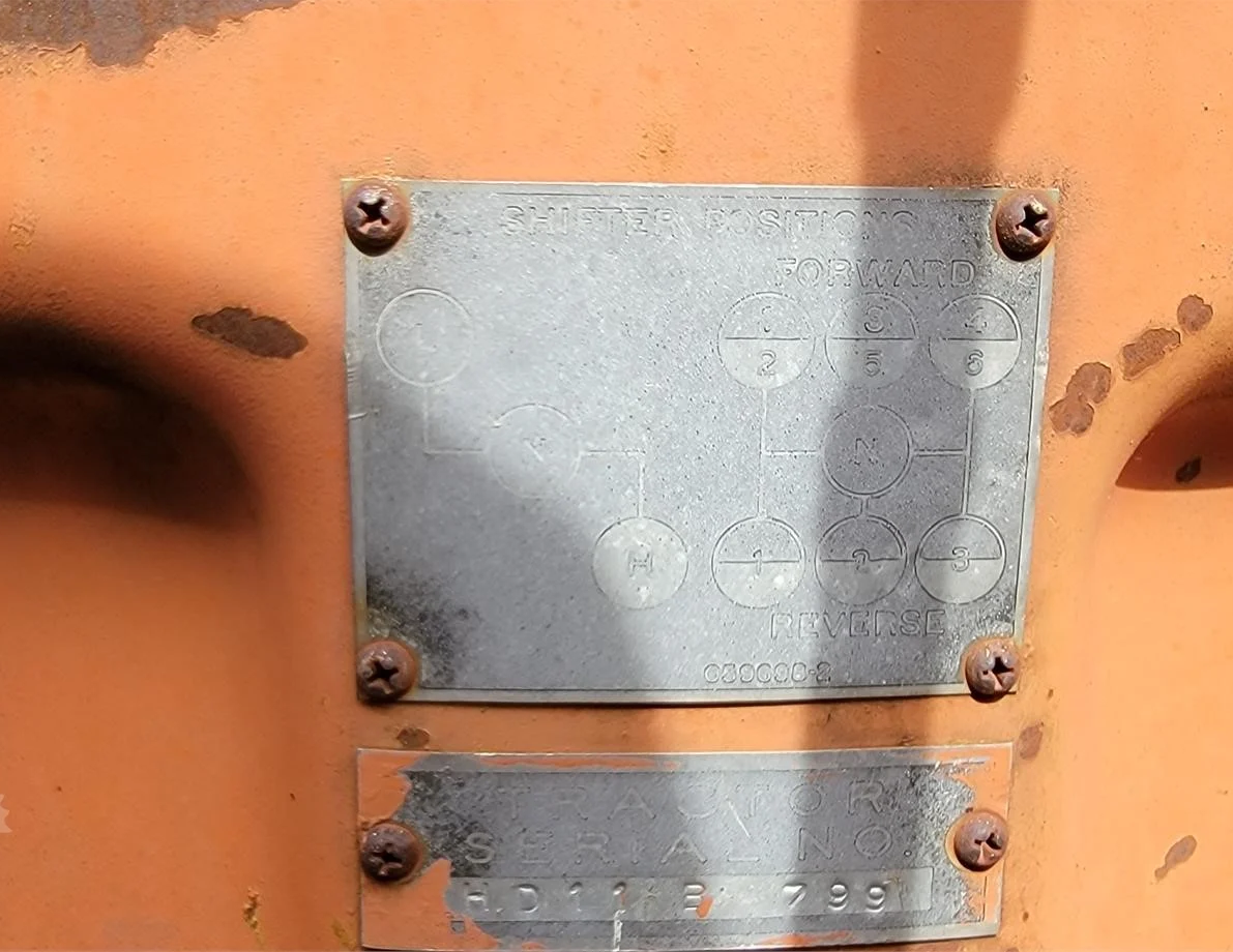

Recently bought an HD11B will be picking it up in about 2 weeks. They said the engine (685T) is locked up only paid $222 for it so I have some wiggle room in fixing it.  I can get an engine rebuild kit for about $2500 less main bearing set & head gasket set. My question is should I keep with the stock engine or should I go ahead and repower it to a more common engine? I cant seem to find main bearings or head gasket set for this engine. Attached is a picture of the serial number.
Location: Gallatin,TN
Points: 10926
Post Options Post Options   Thanks (0) Thanks(0)   Quote Tracy Martin TN Quote  Post ReplyReply Direct Link To This Post Posted: 31 Jul 2022 at 7:46pm
I would investigate what is wrong with engine first. Could be something simple. JMHO, Tracy

Tim....So the serial number being 799...should be the first year of production 1955. It would have come with a Lonova style engine at that time...the 685T became the last version made. So ...yes JC and Tracy have good ideas where to look.   As I always like to say....post some pictures....engine pictures will help identify exactly what you have....the more pictures the better.
