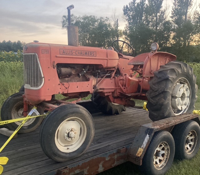

New to me 1963 Series II D15, Missing the carb and the neighbor told me it hasn’t ran in 25 years, been sitting inside the whole time. Figured it was worth the $300 they were asking. Did the first year of the series 2 come with a pan style seat or did someone change it?

Get the serial number and post it.  Series 2 was not a pan seat.  Doesn't mean you got a bad deal, or it isn't a series 2, just that part swapping on a 59 year old tractor is possible/likely...Wink
Points: 22805
Post Options Post Options   Thanks (0) Thanks(0)   Quote DrAllis Quote  Post ReplyReply Direct Link To This Post Posted: 08 Sep 2022 at 5:38am
Pan seat was standard equipment. Deeluxe seat was an option. Power steering was an option. Hour meter was an option. Belt pulley was an accessory.

Post Options Post Options   Thanks (0) Thanks(0)   Quote Travis2766 Quote  Post ReplyReply Direct Link To This Post Posted: 08 Sep 2022 at 6:12am
Serial number is is in the 14000’s, it has power steering, no hours meter, no tachometer and of course the belt pulley. Looks like it has the wrong seat (unless the deluxe was optional at the time), the wrong steering wheel and the decals are wrong.

Post Options Post Options   Thanks (0) Thanks(0)   Quote DrAllis Quote  Post ReplyReply Direct Link To This Post Posted: 08 Sep 2022 at 6:25am
It's been repainted and has incorrect hood decals.

Oval muffler and fenders with hand grips are Series II feathers.

Post Options Post Options   Thanks (0) Thanks(0)   Quote DSeries4 Quote  Post ReplyReply Direct Link To This Post Posted: 08 Sep 2022 at 6:19pm
Definitely a Series 2.  Taller fenders with headlights mounted on them.  Also has a dry air cleaner.  As Dr. Allis said, it's been repainted with incorrect decals.  Nice straight tractor - you definitely got a steal.

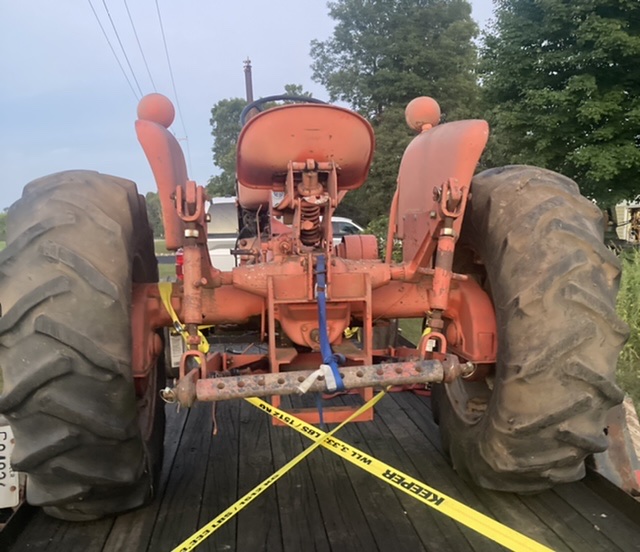

$300?  Good grief.  I'll I can say is thanks for saving another A-C before it got melted down and sent to China.  The D-15 is my fav.  As the Good Dr. stated the iron pan seat was standard.  Black and White padded seat and back was an option.  I have both.  The padded seat is much nicer, so if you can find one go that route.  Although I found a nice pad to put over the top of the iron seat and its fine as well.  Good luck whichever you decide.  Keep us posted on how it runs once you get the new carb installed.

Post Options Post Options   Thanks (0) Thanks(0)   Quote DonDittmar Quote  Post ReplyReply Direct Link To This Post Posted: 09 Sep 2022 at 6:06am
The Saginaw Tractor 3pt on the back is worth more than 300.00

Post Options Post Options   Thanks (0) Thanks(0)   Quote DonDittmar Quote  Post ReplyReply Direct Link To This Post Posted: 09 Sep 2022 at 6:08am
In fact if you dont want that 3pt, ill give you 300.00 cash for it---then you can tell the wife you got the tractor for free
