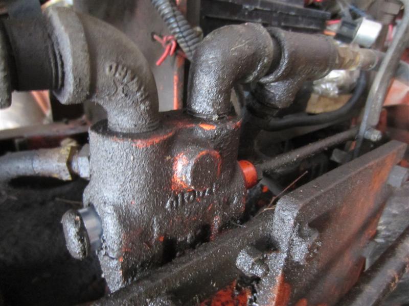

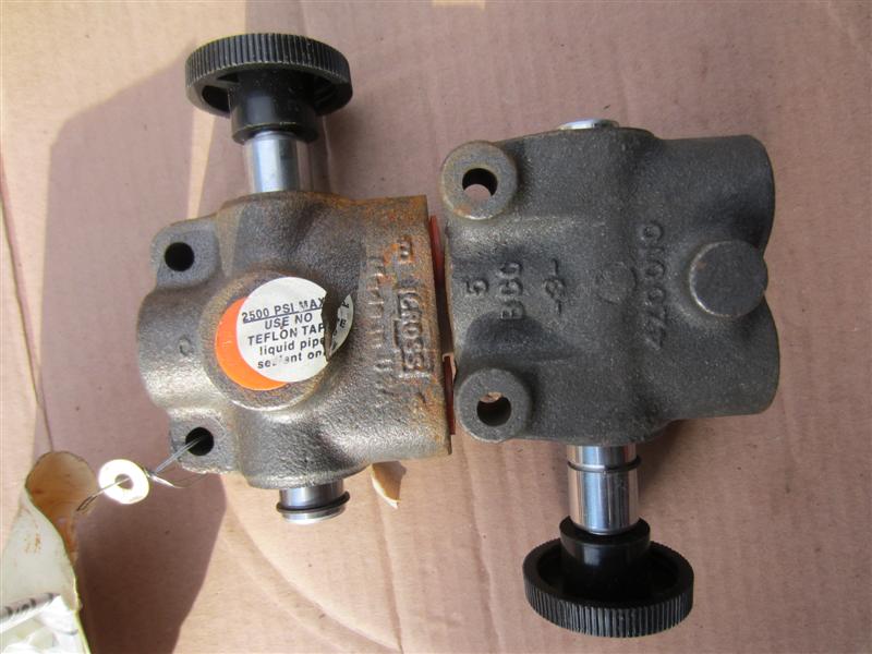

Post Options Post Options   Thanks (0) Thanks(0)   Quote Brian G.  NY Quote  Post ReplyReply Direct Link To This Post Posted: 25 Apr 2021 at 9:24am
I have used one of these on my WD for about 20 years.....it's not rated for 3,500 PSI so I can't recommend it. I have seen a few postings on here over the years where other guys are using the same valve. I have it set up so that when the valve is forward, the front bucket is operational and when I pull the lever back,  the back blade is operational. Each attachment remains at whatever position it is in when the valve is moved. Very handy whether moving snow or dirt when you need the back blade to "clean up".

Bryan looks like that's what I'm after. I'd like to find one with a higher pressure, however it seems you've had no issues with this one. thanks

Post Options Post Options   Thanks (0) Thanks(0)   Quote Ray54 Quote  Post ReplyReply Direct Link To This Post Posted: 29 Apr 2021 at 12:08pm
Question on iron pipe and psi. How much will it stand? Looks like in the picture that is what Brain G has.
All the old crawler stuff had 1000 psi on a good day, if everything went wrong maybe 1500 tops. So all the employment stuff was always plummeted with iron pipe. Is that something to be real concerned about if putting a tractor that makes better than 2000 psi on it.

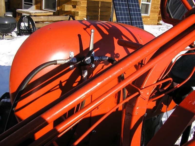

Post Options Post Options   Thanks (0) Thanks(0)   Quote mdm1 Quote  Post ReplyReply Direct Link To This Post Posted: 29 Apr 2021 at 1:15pm
This how I did mine. Really convenient to have it close.

Post Options Post Options   Thanks (0) Thanks(0)   Quote mdm1 Quote  Post ReplyReply Direct Link To This Post Posted: 30 Apr 2021 at 10:49am
I got it from surpluscenter.com. Get a 3 way valve in the size you need. Just make sure you get one with enough rated psi. Works good for me.
