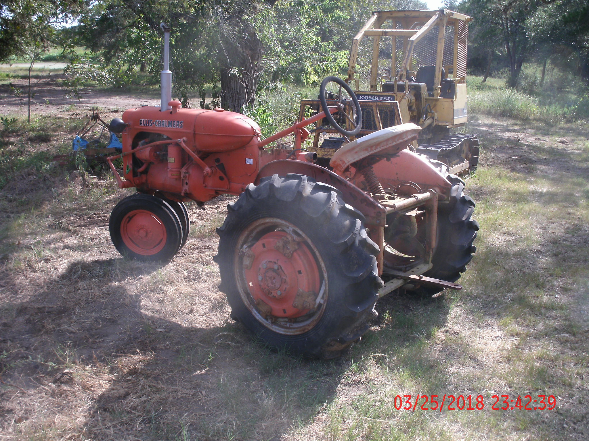

..I posted previous about locating view port for timing marks, that was solved; however, I discover when the center line is centered in the port the number two cylinder is at an apparent TDC and number 3 is very close behind it.  number1 and 4 are at , or near, BDC.  I have rotated over and over to make sure I am seeing what I see.  I know the previous owner to be a very straight shooter, he is not one to tell it not as it is. He said the tractor was running when he parked it several years back in the shed after buying a modern tractor and the CA was never used again.
How could this be...could the fly wheel have been re-installed at some point that much off (90 degree)...and the rest be all as should be...
Welcome thoughts on how to proceed...??

The flywheel only fitts one way. Put you thumb over the number one spark plug hole hav a fried crank it with the hand crank till it blows you thumb out of the hole. Now stick the mag on with the rotor pointed to number one. There are two marks on the flywheel. I'm guessing your using the TDC mark it'll never run your about 30 deg off. You need to be using the fire mark. Should have a little F by the mark.

..This not a magneto tractor, it has coil and distributor. The question remains, how could the timing show in the port for tdc and the number one cyl. is at or near bdc. And, not arguing, but why couldn't the flywheel be bolted on 45 degree off...is there a key-way or some thing to prevent it from bolting up..?

My guess if like some other allis machines one of the holes in the flywheel is out of position. allowing only one installation location. Rolling it by hand and feeling the compression on the power stroke is a great way to see if number one piston is up and ready to fire. Maybe the tractor ran but not very good???:)
BTW the way if it doesnt run and you cant get it to run and want to get rid of it. You can send it my way! Looks like a good CA!

First of all, numbers 2 & 3 should both be at TDC at the exact same time.   And 1 & 4 exactly 180 crankshaft degrees from 2 & 3.
Is it at all possible that the engine or flywheel came from another machine?

...I doubt that, It appears to have been been worked on some time in the past and repainted from front to the back end of torque tube...
I have looked at all the fotos of flywheels for CA and see no obvious reason why the flywheel could not be bolted a quarter round off.  I would like to hear from someone who knows for sure if that could be done or not..? ...I think that could put the timing mark to show at the bottom inspection/drain under the tractor....if some one had semi-permanent mounted equipment that covered the side port that could be a work-around...?
I'm doing a lot of guessing , but would like to know more before I go on with the thing..
