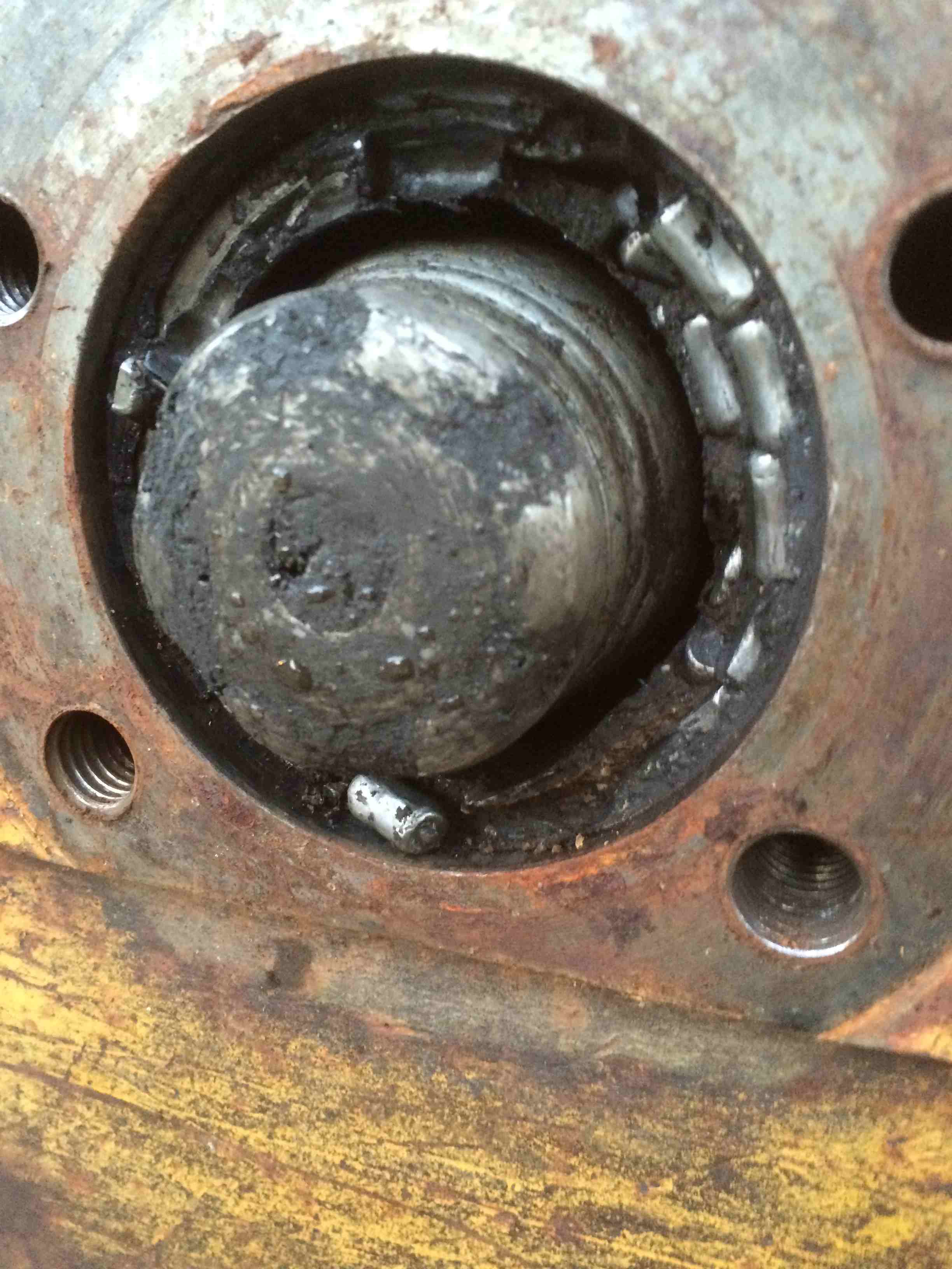

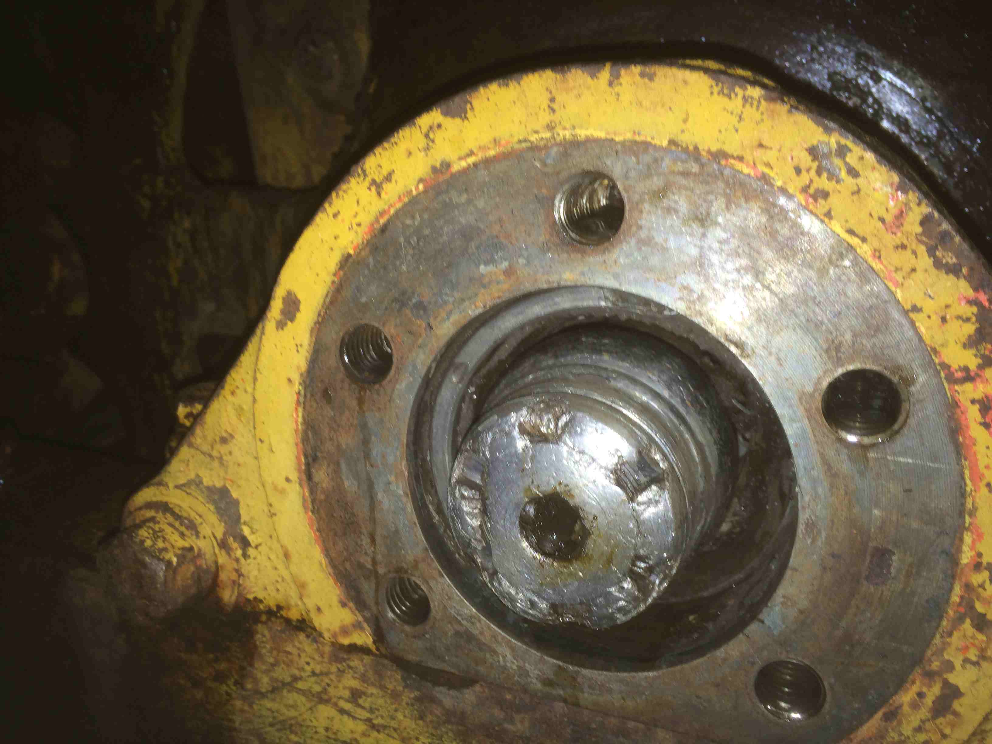

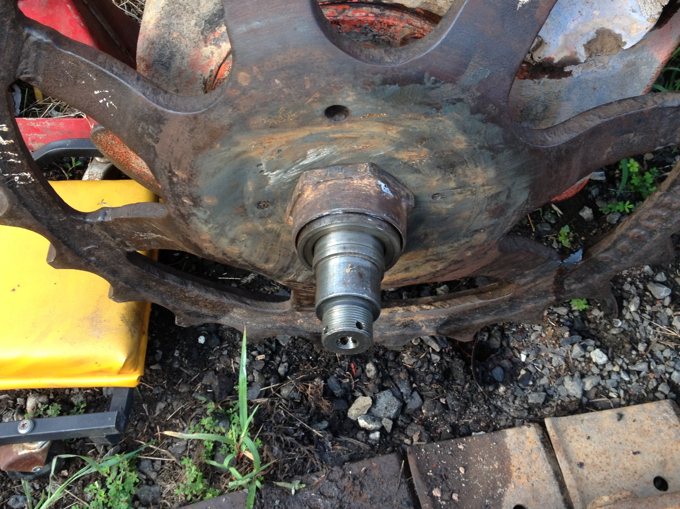

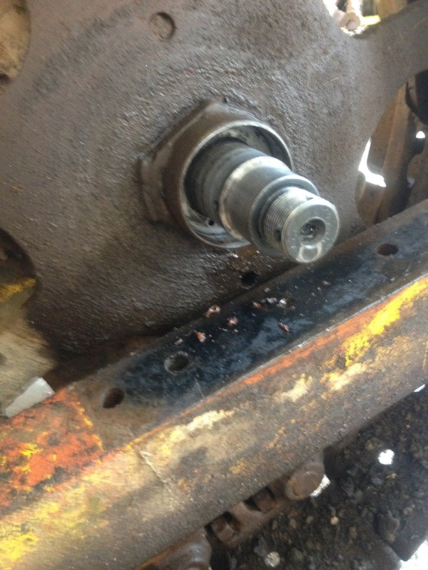

So I got the outer cage covers removed on both sides...
uploads/15072/47.JPG
And after a little cleaning...
uploads/15072/50.JPG
It appears that the axle may be ok. The bearing and nut obviously is not!  Now I have a question...since pulling the bearing cage from the axle with a puller involves a puller pushing the shaft thru while pulling on the outer cage housing, and the bearing has disintegrated and there is no mechanical connection between the inner race and the outer race...when I pull won't that then force the seal assembly and everything behind the inner race to press on the inner race remains only? And therefore damage or destroy what is left of the seal assembly?  Of course with the bearing being shot, maybe there is nothing left of the seal assembly anyway at this point?

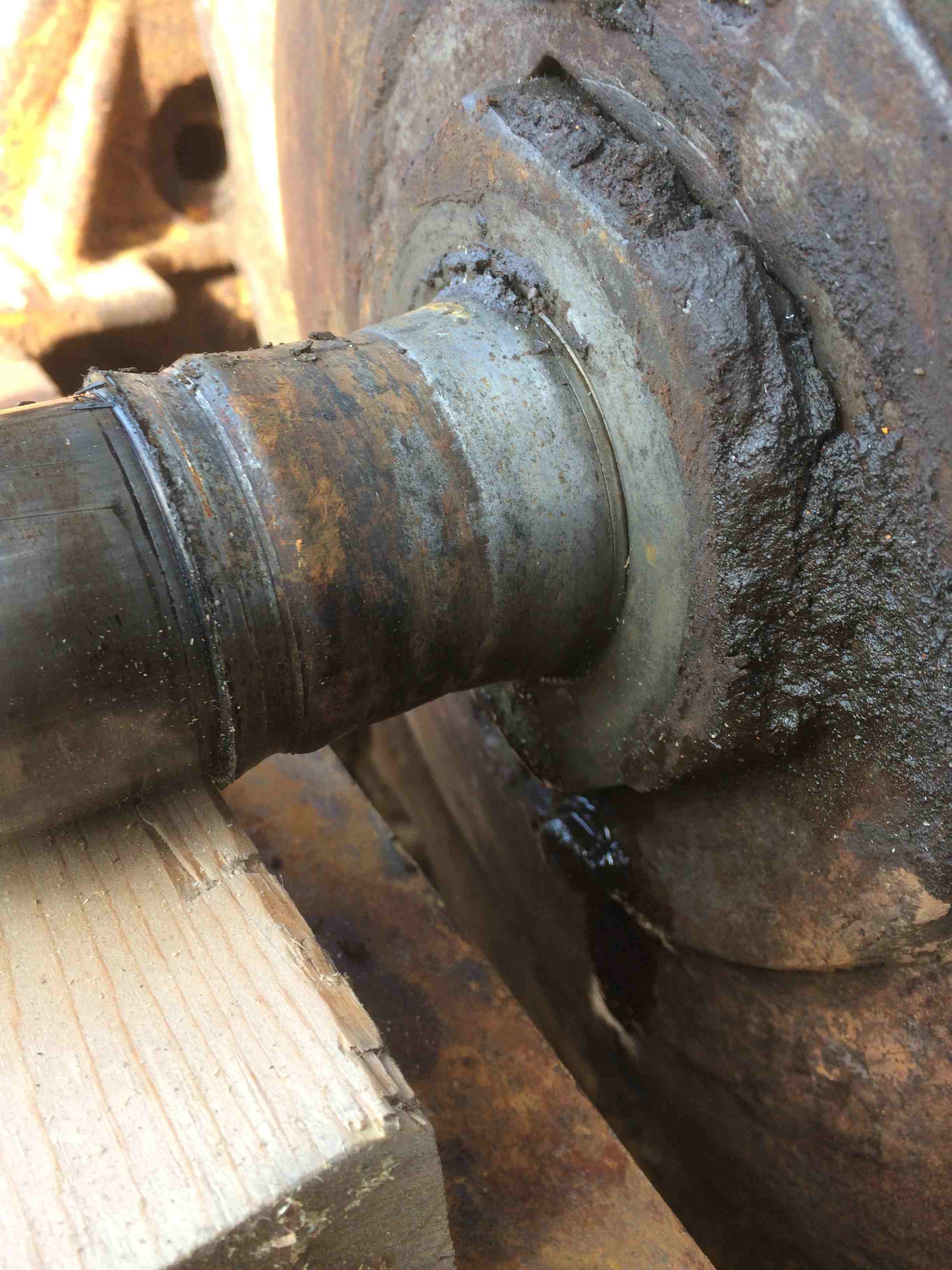

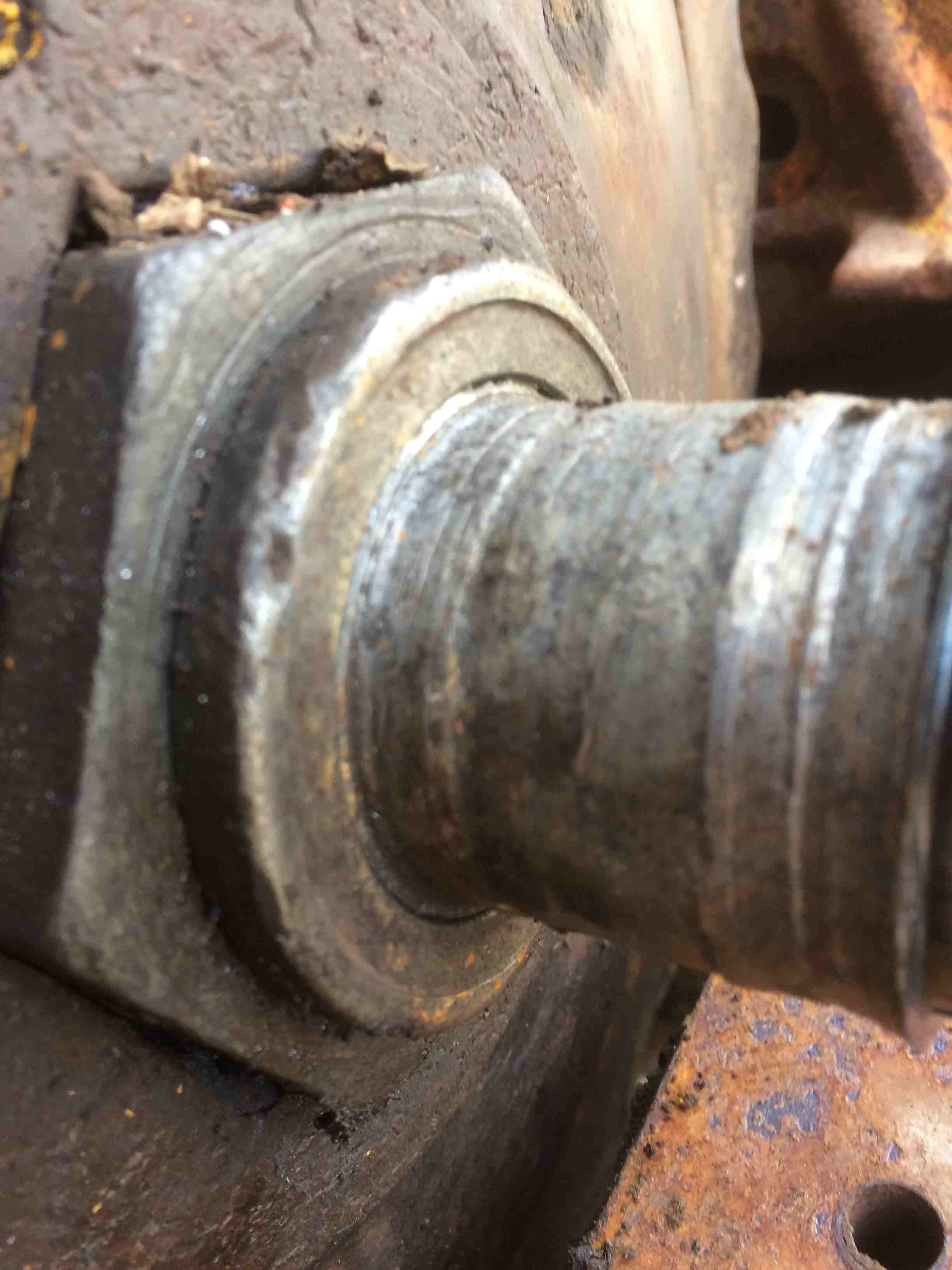

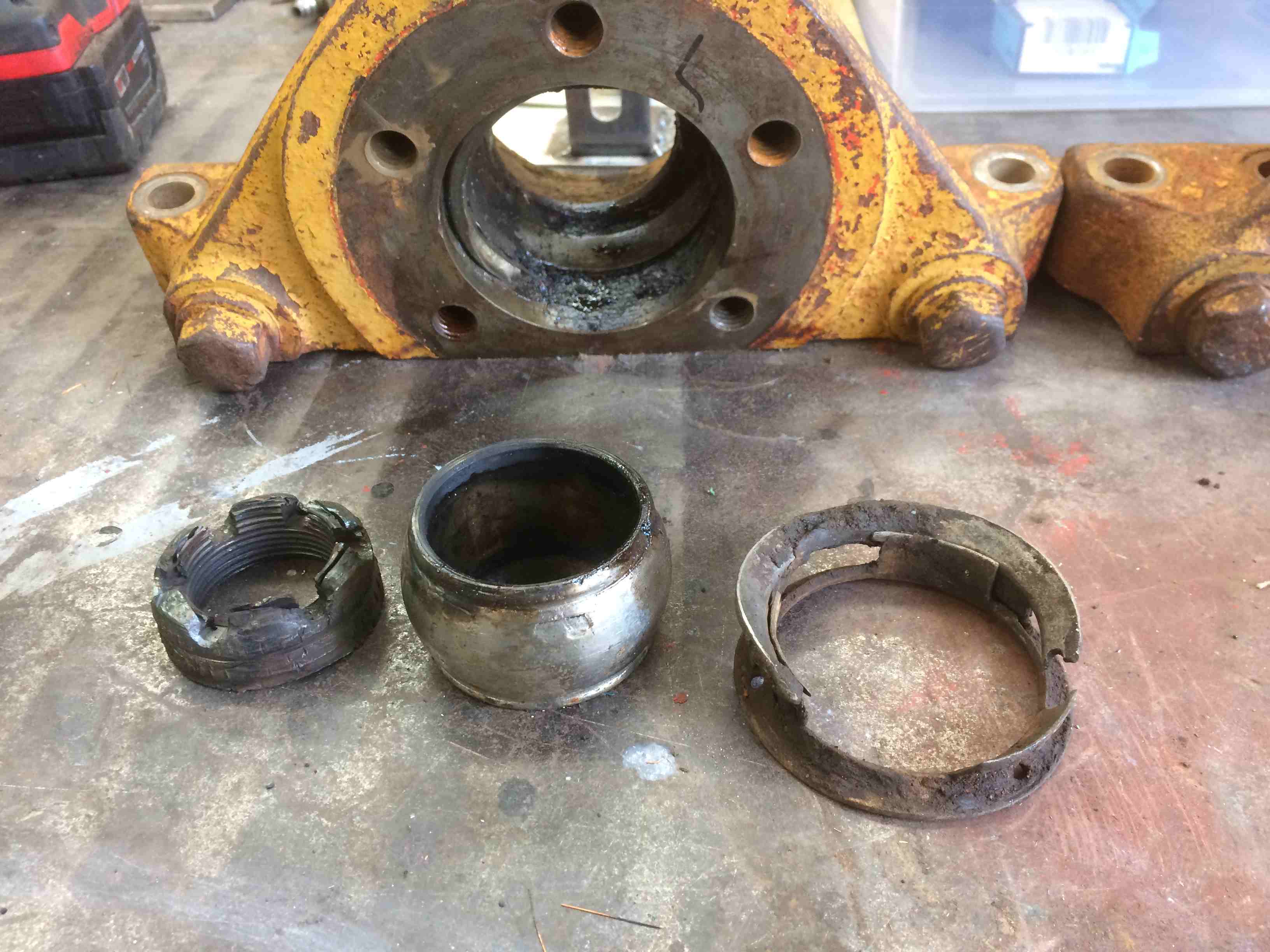

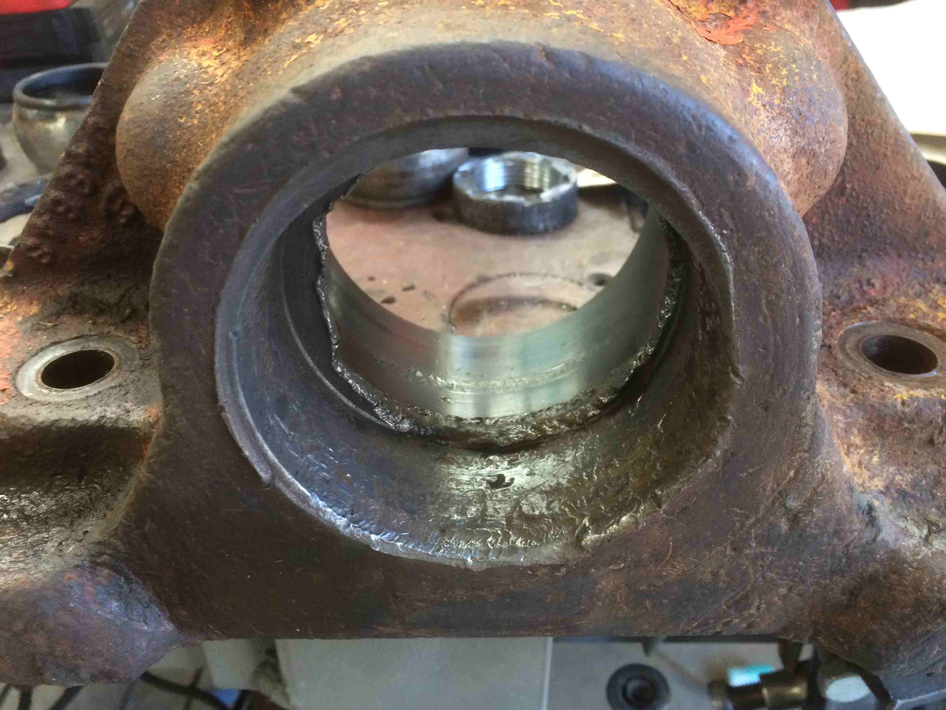

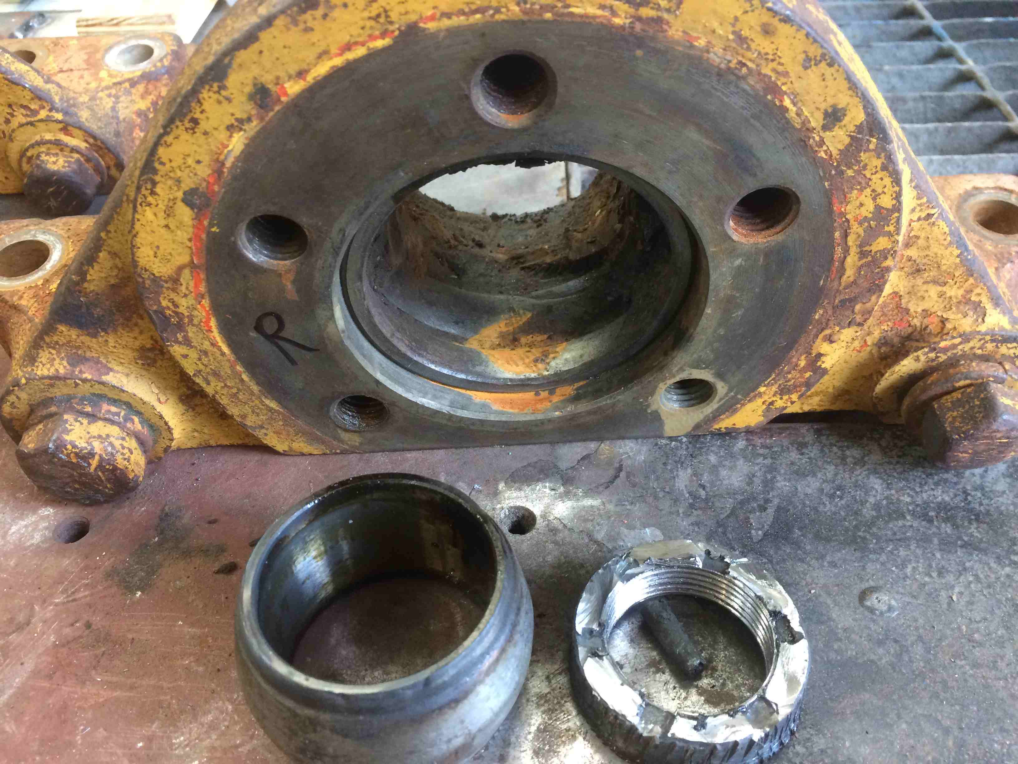

Got it all apart...well, mostly.  Here are the all that's left of the bearings and seals...
Left side, the axle and sprocket nut...
On the right, notice there is still part of a seal or ?? next to the sprocket nut.  It moves slightly but does not want to slide off.  How do I remove this?
Second question...the threads are good on the axles...seal surface is wiped out.  I do not have the time nor the money to remove the axles. I believe I can rig a jig similar to what DOZER did to recut threads, and grind the seal surface area down and install a sleeve. Has anyone ever done this and are there sleeves available? Or do I need to fabricate the sleeve?  Or are there other fixes that I am not aware of?
Edited by Chas55 - 26 Feb 2016 at 3:54pm

The spocket nut have a lock nut with 2 bolts you should clean the big nut maybe  they weld'it on sprocket and the big nut must have a shoulder like the right side for the ring seals and the spring ass, with boot and if you can removed the lock nut try to turned the big nut with out tension on sprocket and you will see if the shaft tread still good

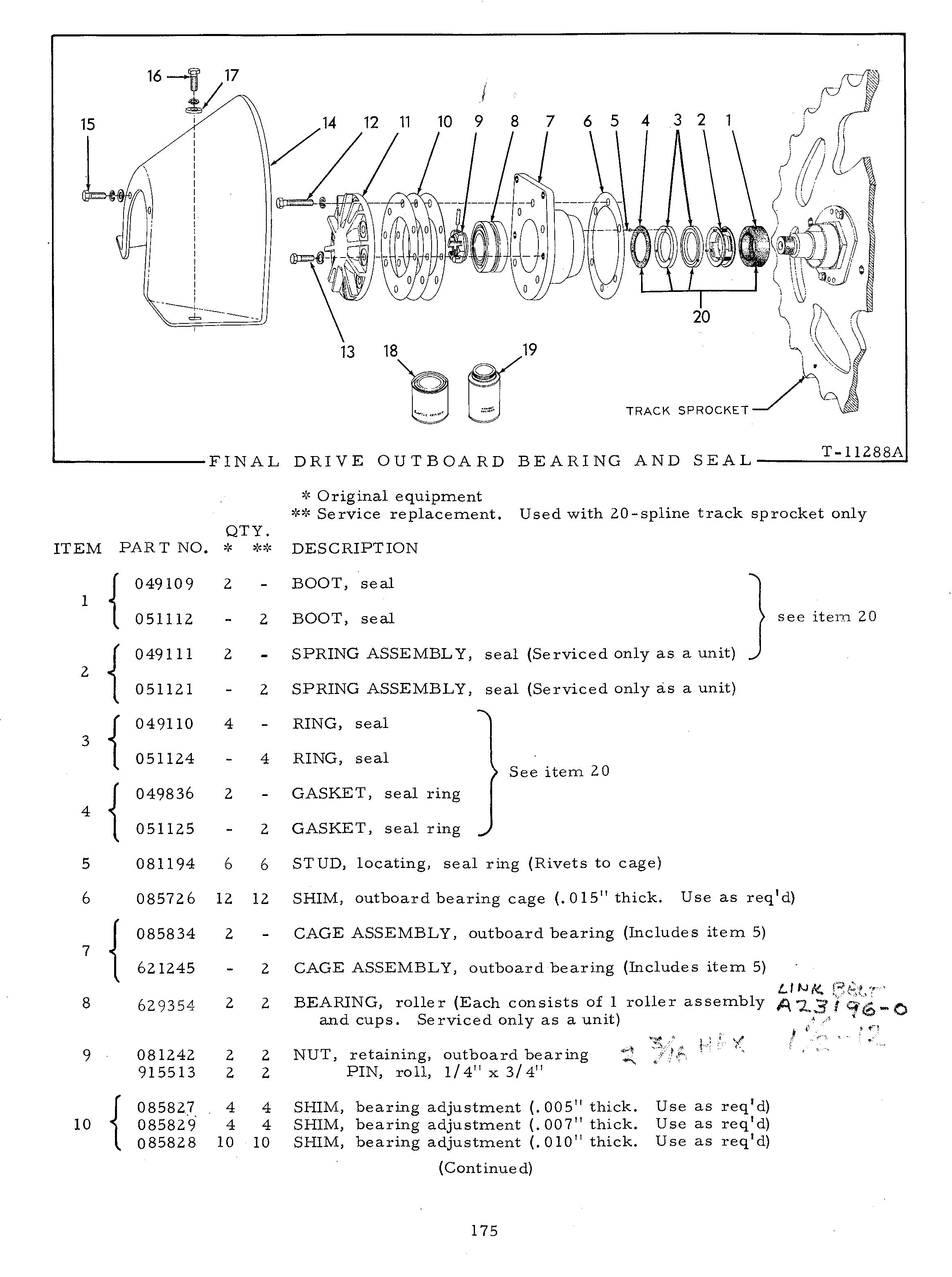

From the HD6G parts book. There is a lot of axle material worn away. The axle diameter inboard of the bearing surface is 2.500" The seal is positioned inside the sprocket nut. The sprocket nut looks to be damaged or part of the seal assembly is inside the nut. There is a lock washer that is bolted to the sprocket with 3/8-16 bolts. There should be one rubber ring and a steel ring glued to the inboard side of the bearing cage. Hope the picture helps.

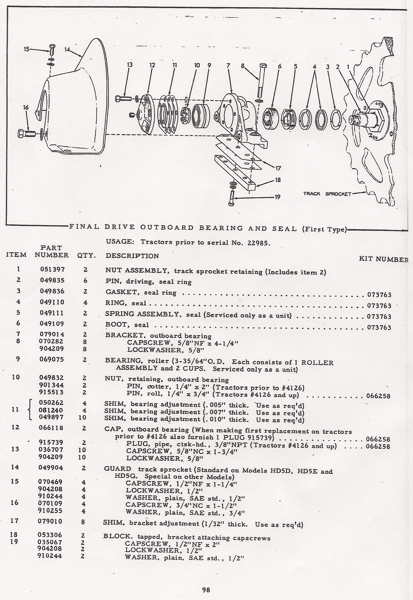

Dozer...the following image is one of two listed in my parts book...according to serial number, and by the look of the axle nut area, I believe this is what I have instead of the second type, which changed up after serial number 22985...and probably includes
your HD 6.  The part number for the bearing appears to be different, but sounds like Gemdozer and others agree they are the same bearing?
So, at this point, the left side axle nut does not show any of the three "pins" shown in my drawing...they may be broken off and I am just not seeing where they are...I will clean the nut up and look for that next...seems like they must be there if I truly have the first type...and by the looks of the right side, it seems to confirm that...however I have not pried to hard on the remaining seal assembly on the right yet...

the seal does not ride on the shaft. it sits against the nut, should have 3 holes that engage the end of the seal to the nut. glue seals it to the nut. then the stationary section sits in the bearing housing. like said earlier, think of a ceramic pump seal style. has a spring assembly that puts pressure on the seals to keep them together. I know general gear has new seals and nuts. best to have the nuts that have the shield on them to keep the stuff out of the seal. looks like you have the first style with the stationary side on the nut. the second style like the pic has the stationary side in the bearing housing. keep them greased but not too much pressure or the bellows will blow out. good luck and post a pic of the entire machine.

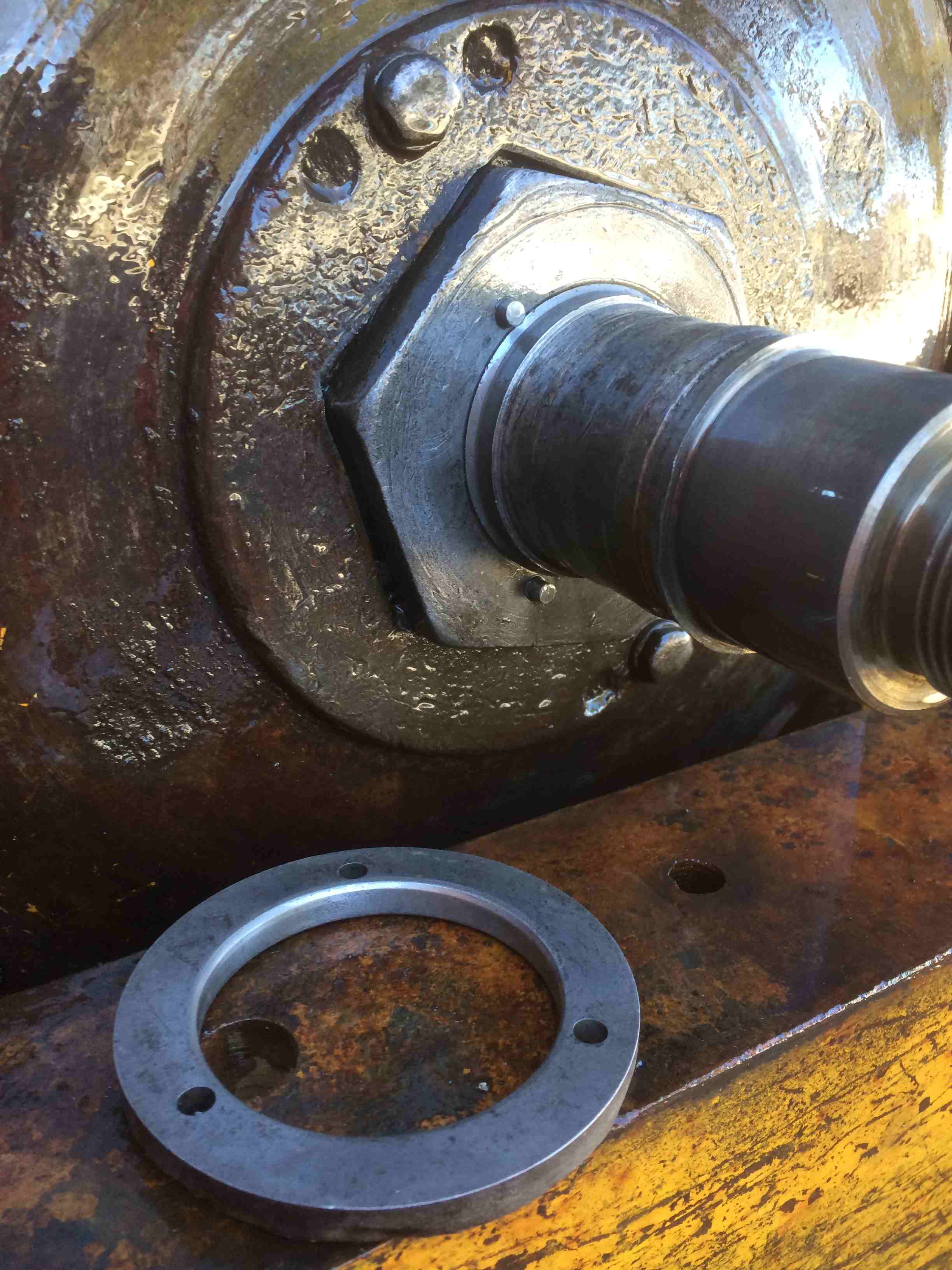

Ok...got the nuts cleaned up and the "ring" off the right side...it wasn't a seal, just a steel ring...part of the seal?
and the side with good pins still in place...
So...this is first style? And, I measured the axle at the area directly under this ring...and it was 2.250"...
I have located both new and used bearings, and most of the seals...just would like confirmation that the bearings and seals are identical between the 5 and 6 as I believe the used bearing are from a 6.
I am going to try and salvage my axles for now. Thinking about a product recommended by Ivan called Belzona...since it is just the seal surface area that is in poor shape. Has anyone had any experience with that?  Or, I may grind that area and install a sleeve...still looking at options...and opinions!!

Dadsdozer...
I researched the seal layout of the two types...first and second, and it appears the only difference is the shield on the nut and the direction of installation...but I have to confess I have not messed with a water pump type seal in 40 years! So I am still trying to wrap my head around the way this seals...I get that it doesn't seal on shaft...but where exactly is the interface between the stationary "seal" and the rotating "seal"?  Which parts rotate and which are stationary? in the parts diagram, several things are listed with the word "seal"...so I am unclear.  On disassembly, one side on mine still had a metal "ring" with the holes for the pins on the nut, and was against the nut. No gasket...maybe glue? Is that the "metal" side of what's listed as item 4 (first style) and the second piece of item 4 is the actual "seal" and this is where the stationary and non stationary items meet?  Also, it appears that the boot seal (item 6) which in first style sits in housing, has three holes...are there supposed to be pins in the housing to keep it from rotating?  And is it supposed to seal against the "lip" in the housing? The reason I am concerned is both of my housings are somewhat "chewed up" on the seal side...the lip is fully present on one and can be cleaned up on the mill...the other (pic below) is not in very good shape...
I am trying to understand exactly how this all works so I can possibly "fix" the housing! Maybe if someone could send or post a pic of a good housing (seal side) from a first style??  I inherited this 5 from my late father, and do not foresee putting many hours on it in a year, but would like to fix it to the best of my ability, considering my limited finances.

the metal ring you took off of the nut is part of the seal. the sealing is done by glue and a gasket on the nut on the sprocket. the other side of the seal is where the oil is sealed as it rotates. the other half of the seal is glued into the housing with a gasket to seal it to the housing and then the bellows has a spring in it that pushes the seal toward the other half. no part of the seal actually touches the shaft. it does not matter that it is chewed up, you do not need a sleeve. it is a different type than a lip seal. both ends of the seal have 3 pins that engage them or hold them in place. depending on which style is used is the direction the seal is installed. either direction uses the same seal to my knowledge. the sealing surfaces are polished to not allow any oil to get by. the housing you have may not be salvageable as it is worn too much to hold the sleeve. I see no pins or holes to put pins in to drive the seal. I would recommend changing the sprocket nuts to the style with the cage on it then the bellows end of the seal goes in there. you may be able to salvage the housing so the steel ring will hold into it. I changed my seal last year and I will look for pics I took and post. think of taking 2 coffee cans and holding them together end to end. the bottoms of the cans is where the oil is sealed and one of them rotates and the other does not. in hope this makes it a little clearer.

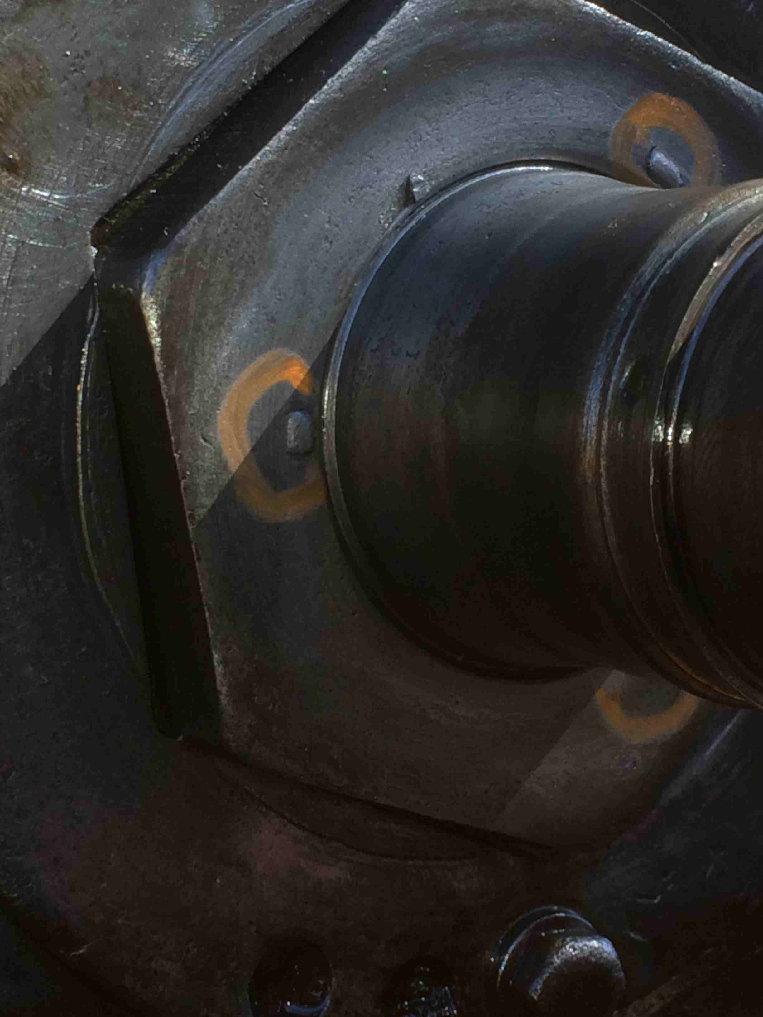

these pics are of the nut with the shield, one with the seal installed and one without. these are all I can find.

Chas55's
The seals on your HD5 are installed backwards of how we are accustomed to seeing them. Your axle nut has pins for driving the steel sealing ring. The pictures Dadsdozerhd5b posted shows the more common axle nut that has a cylindrical boot shield. This axle nut has 3 holes that drive the boot and spring assembly. The boot and spring assembly is glued to the inside of the axle nut. Booth use the FIRST TYPE ORIGINAL EQUIPMENT SEALS. The second type seal is used on the 20 spline service replacement (second type axle) that you do not have.
Both axle nuts should be replaced with # 081369 that has the boot shield.
The bearing cages should be replaced because the portion of the cage that supports the seal is worn away. The replacement cage should have the (3) pins that hold the steel sealing ring and rubber gasket stationary.
As stated earlier the worn part of the axle does not have to be built up because it in not important to the lubrication seal.

to get the high torque is actually not too hard and should be out lined out in your manual.  On my 16  you release the opposite side steering clutch and put the trans in 1st gear.  turning the nut on the input shaft of the trans to a certain torque puts out the 2000lbs of torque needed to tighten the sprocket nut.  you just need to make a wrench to hold the big nut.
Coke-in-MN View Drop Down
Location: Afton MN
Points: 42266
Post Options Post Options   Thanks (0) Thanks(0)   Quote Coke-in-MN Quote  Post ReplyReply Direct Link To This Post Posted: 29 Feb 2016 at 11:05am
48" pipe wrench - 10' section of pipe to slip over handle of pipe wrench - 6 to 7 ft out from center of jaw of wrench 200 lb of weight applied = 12 to 1400 ft lbs torque
