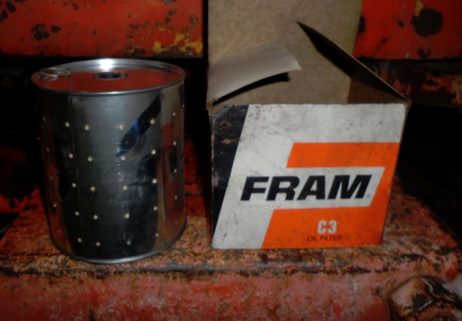

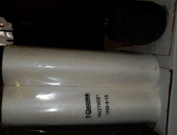

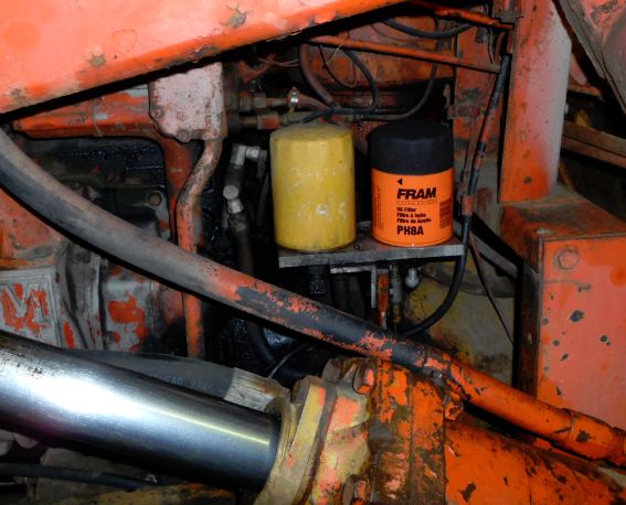

couple filter ideas

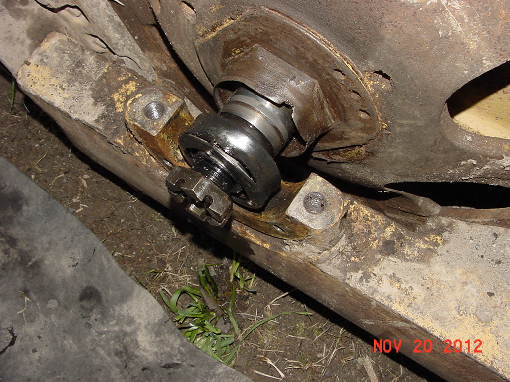

Here is a picture of the outboard seal from my HD6G. Somethin got in there and cut the boot.

Wow, I definitely need to check them when I get the 5. I have never seen them apart on any of our old dozers.

Is the PH8A a direct replacement? It's been so long since I worked on that dozer I forgot how all the filters are situated.
How about fuel filter...anyone have a number or is it the C3 that Coke has pictured?

One idler is stuck..my dad said they put too many shims in it years ago and it seems they have frozen up. The track adjustors look like there is no way they will move although I've coated them with PB blaster.
The final drives leak, one piston is leaking and the tranny feels sloppy when shifting although engages well.

That cup belongs on the bottom of the filter and the top of the filter presses against the top casting to seal.
 That Fram C 3 filter is what I use to be able to get easily at Farm Supply store - Chrysler product oil filter. I used it both on fuel and on oil .
 Those PH8A filters in the other picture are the bracket I made up to use spin on filters now.
 That other white filter material in 10 Micron filter tubes that I cut down to make 2 filters for the one on engine , use them rather than the honeycomb woven filters as had a problem finding them. (Some oil burner guns use them )
