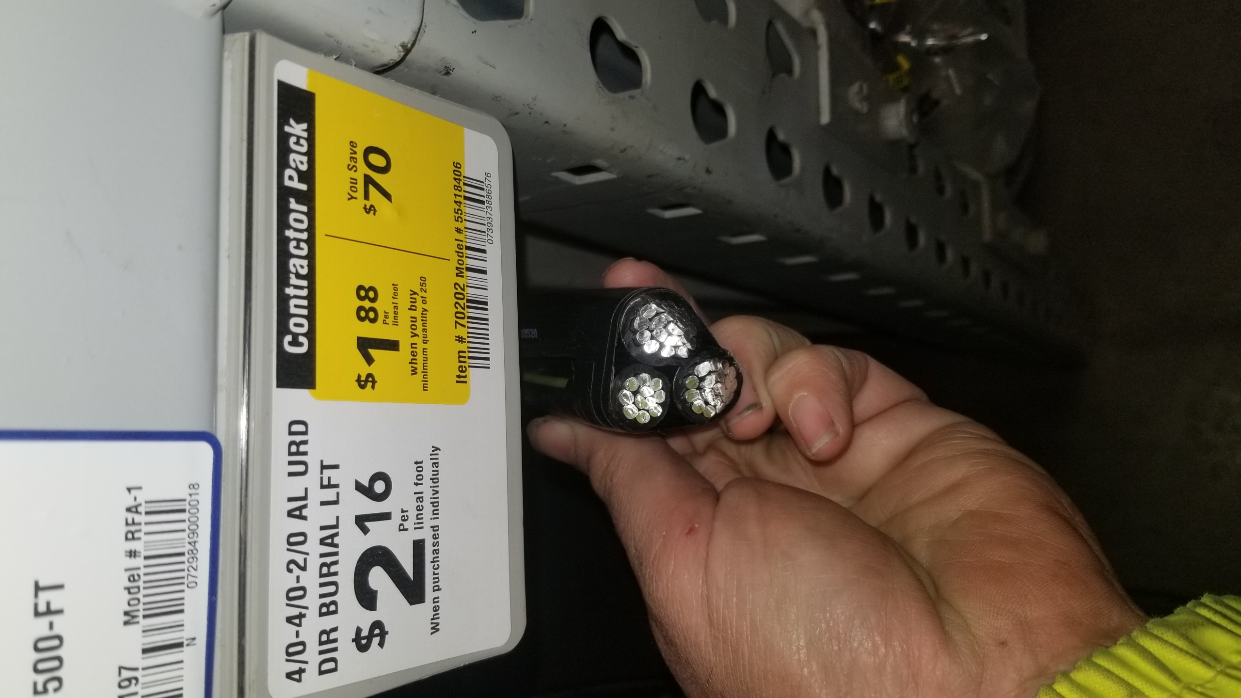

4/0 AL cable is good for 205 amps ......... the ground wire 2/0 is good for about 150 amps.... that should be fine for entrance cable. I have had similar in my house for 40 years.

The boxes aren't "Big" to hold a bunch of breakers. The boxes are big to have plenty of room to route those big 4/0 service feed cable and maintain proper bend radius.
Depending on code in your state, you may have to run a 4-wire for your house. In Indiana, all grounds have to run back to the main disconnect.

All the local electrical contractors use is Aluminum Tri Plex for high amp runs. My own home as are 90% are is fed from the meter base to the breaker panel with same. Not so much a concern for heat and fire probabilities as the old 12/2 w/grd house wire.

That looks like aluminum can’t
’ Use it in Calif   I wouldn’t anyhow too high fire risk. It expands and contracts too much.

It's just a lot cheaper than copper 3/0.

Do not need to bury, this will be interior run.

Should work fine, how far have to run and any severe rock in the soil? Under NEC code also needs to be at least 24" down.

Will this work for 200 amp service from meter to breaker box?

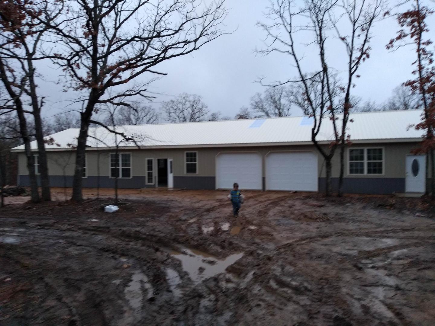

Oh, did I mention that when our shop burned down, we decided to build a new house?  Shop and warehouse will go in right after we move in.

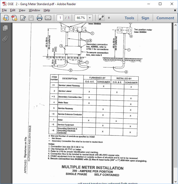

Here is the spec sheet:
Its cut off but the bottom says "Will need breaker box adjacent to both meters"

Here is why there are 2 meters.  It's sort of a duplex. Our house is on the left, and Mom's is on the right.  She needs as much independance as possible, and I can easily see her living here another 25+ years.  So she has her own meter.
The above solutions will work, I just don't see why they are so stinking big when they only have 2 breakers.  I'll upload a pic of the spec sheet they gave me.
