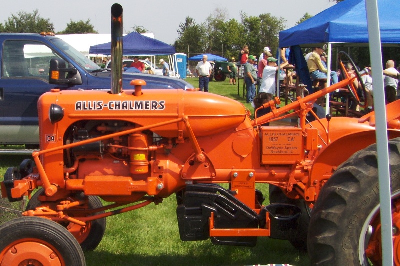

This is the brackets I made for my CA that I pull in the farm stock classes of 3,000, 3500, and the 3750 weight classes.
I use front wheel weights 55# each
40 # suitcase weights
80 # Massey Suitcase weights
90 # allis side engine weights
135 # allis rear wheel weights
on the front CA cultivator bracket with the 2 pins for quick mounting
on the belly I have made a bracket to hold 4 engine side weights for quick installation between classes
also mount the 40# & 80# weights in a forward position to keep the nose on the track
and move them to the rear of the bracket for more rear traction depending on the track conditions.
I also made a tube bracket for the rear wheels to hold 2 wheel weights  but I do not have enough time to make the changes between classes to get them secured in time to pull AND they are Just TOO heavy for me to handle by myself!!!!!!
Good luck at the fair and have Fun!

Post Options Post Options   Thanks (0) Thanks(0)   Quote DSpears N IL Quote  Post ReplyReply Direct Link To This Post Posted: 04 Aug 2016 at 7:46pm
Hi Rich
I do not need wheelie bars to run in Farm Stock classes.
I did have a rear bracket made to mount to my lift arms, but the suitcase weights extended out past the rear tires and was not allowed.
Let us know how you do with your pulls at the fair!
