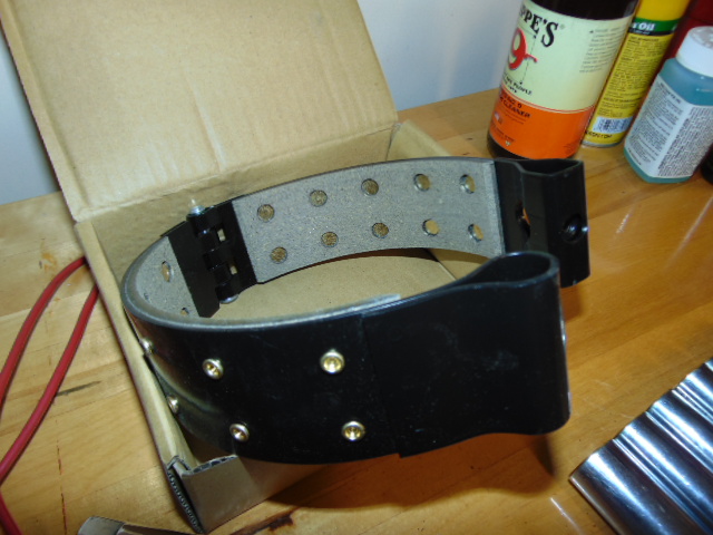

Post Options Post Options   Thanks (0) Thanks(0)   Quote BEK Quote  Post ReplyReply Direct Link To This Post Posted: 06 Mar 2018 at 7:24am
New brake bands from Steiner.
