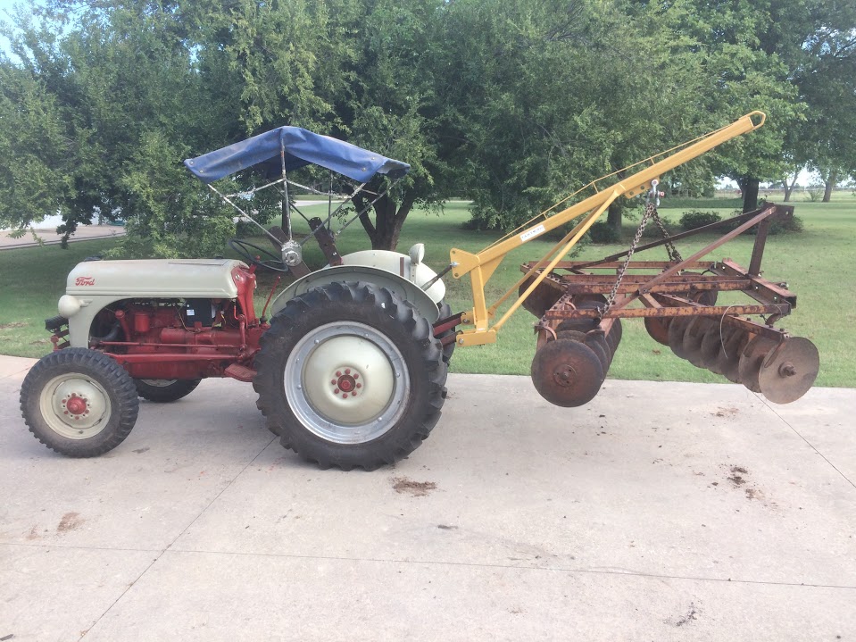

Yes, a relief valve will probably fix your issue. I'm not sure what size wrench is needed, but it will have to be a stub wrench, due to working inside the tractor. Also have to drain the fluid I think. On my 8N, sometimes the lift would freeze up/delay, as in, if you pushed the lift lever down, the load would stay up. I'd have to move the handle up and down a few times, and then it would drop. New relief valve will fix that.
Once you get it operating, it should hold a 2-bottom off the ground overnight. If you hook onto something heavy (disc or brushhog), lift it, then kill the engine and hear a rhythmic "click" noise (It may be fast, or really slow "click") the lift piston is worn and needs replaced. That's an afternoon job, is pretty easy, and fairly cheap.
But...unless it just bugs the heck out of you, you could probably leave it alone. The lift has ample volume to compensate for some major leaks, without hampering field performance.
As far as cleaning, I filled mine with diesel and ran the lift up and down a few times. That got some sludge out of the internals of the system, but it's a good idea to clean around the pump by hand, especially the intake area. Just take the right side round cover off (the dipstick goes through it) and clean the area out by hand as best you can, if there's 60 years of sludge like mine had.
A lift in good condition that is properly adjusted can do some wondrous things. In this photo there is no weight added to the tractor. The hitching point is about 4.5 feet from the ends of the lift arms, yet it lifts this 720 lb Allis disc with ease. I'll admit, that did make it light on the front, but I think filling the tires would have helped that quite a bit.
Edited by CrestonM - 24 Feb 2018 at 1:57pm
