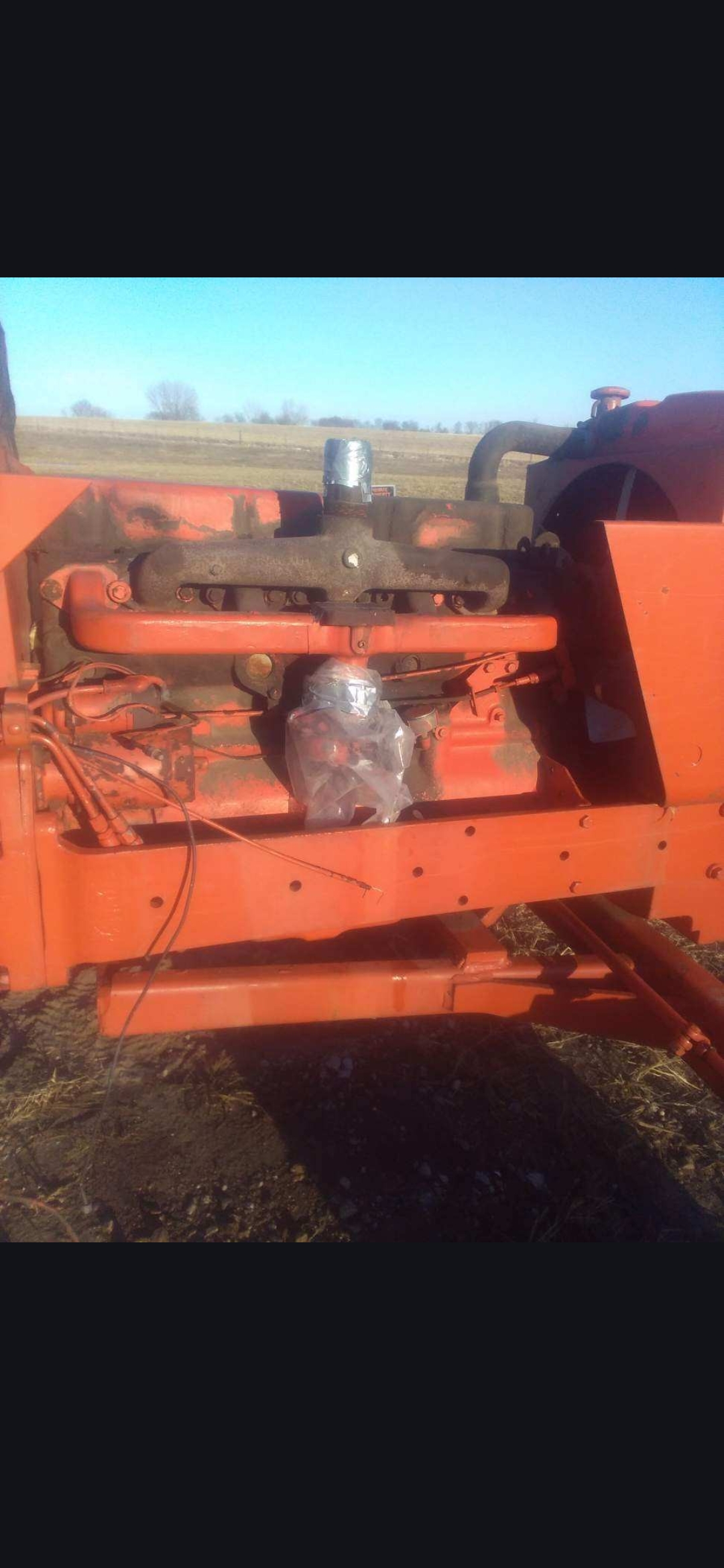

I don't believe these are available at all anywhere, correct ??? If i'm wrong, please steer me in the direction where I might purchase one. So, assuming there aren't any available, I have plans to build probably two sometime this winter. They will be of 1/4" thick steel instead of cast iron and it shouldn't ever crack like cast iron does. If anyone is interested, let me know and I'll include you on my build schedule. Thanks.

We have had a marvelous start to 2026 !!!  Who would have thought a diesel exhaust manifold from a 180-185-190 or Gleaner "F" would bolt right on a G-2500 or G-2800 cylinder head ?? Well, it certainly does and with about 2 minutes worth of grinding on each end mounting holes.  With every discovery like this, there is usually a downside. The one thing I will have to fabricate is the up-pipe from the diesel manifold to the muffler. The diesel pipe is 2 inches closer to the valve cover so the muffler either needs a new hole in the hood or an up-pipe with a jog in it. A very minor detail compared to fabbing up a whole complete exhaust manifold !!! There are tons of these diesel manifolds in salvage yards to be had.  I may have to fab up some sort of heat shield to warm up the intake manifold in the center. Probably not needed in summer temps but winter temps I can see why it might be needed. It will be bolt on and could be removed if desired.
