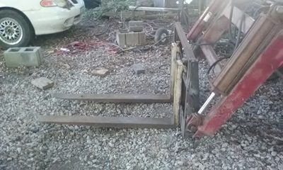

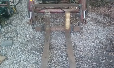

Hi guys me again I just wanted the share my latest creation a set of forks for my loader.
I got a set of forklift forks and built a frame to hold them.
Feel free to comment good or bad thanks guys.

Why did you put the lift arm and the tilt ram mounting pins so close together?

will it tilt good at a high lift point?

The rams are set up for the bucket so I had to put it there.
It seems to work fine I might change it later.
