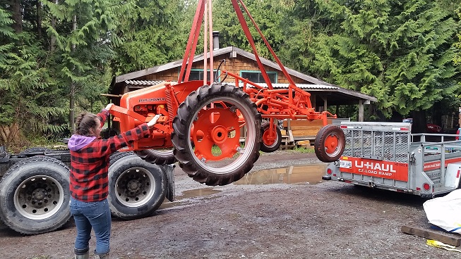

Here's photo of the little thing. :) Had to lift it off the trailer as it didn't quite fit to drive on set up wide. Really nice looking little machine.

That is a nice looking G. Go easy on the starter fluid,  just a couple of quick shots while cranking it over. Once you get the plugs dried and cleaned and the air filter cleaned up you may not even need any starter fluid. I try to not use any if possible.
